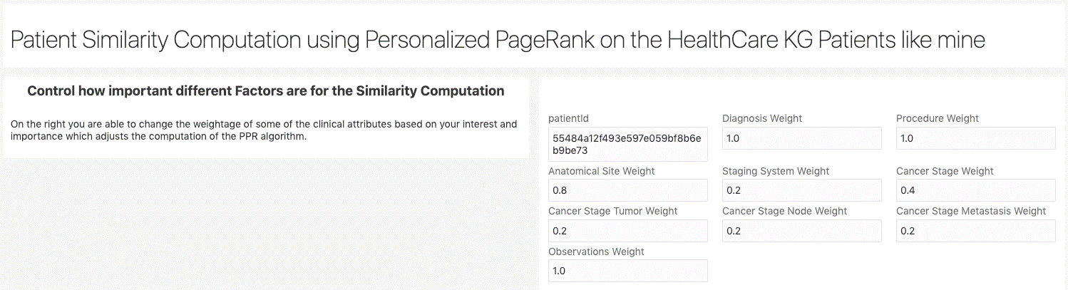

What it looks like
The Patients Like Mine notebook also provides the user with the capability to adjust the weights of the clinical attributes based on their interest which would enable them to personalize the similarity search feature to their use case as shown below.
Patient similarity computation using Persoinalized PageRank.
Once the weights are set and algorithm is executed, you would see a list of patients ordered with higher PPR scores as shown below.
Weighted PPR for computing patients with similar events.

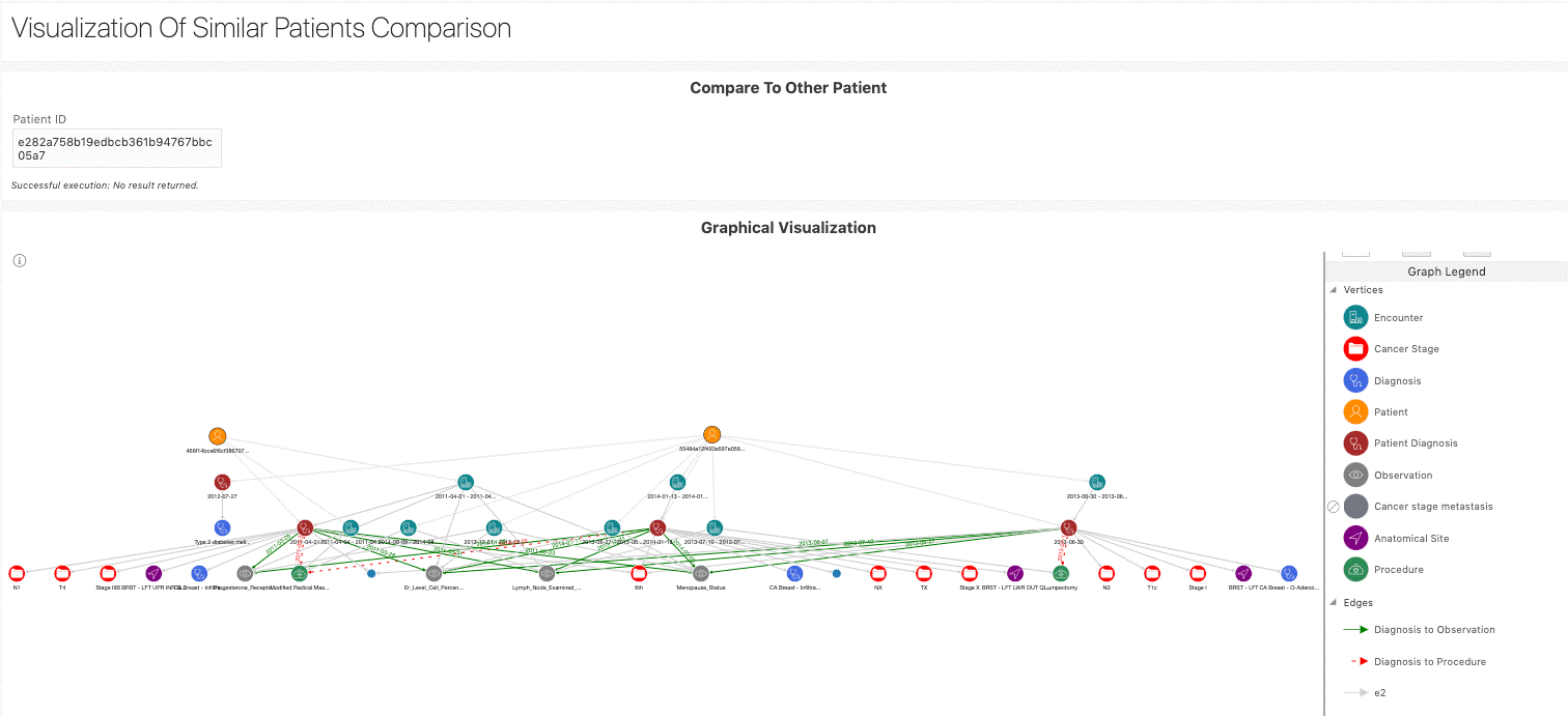

The highest scored patients are most similar matching patients to our patient of interest. Now you can drill down further by selecting one of the matching patients and visualize the one-to-one graph with similar clinical attributes between these two patients as shown below.
Visualization of similar patients comparison.

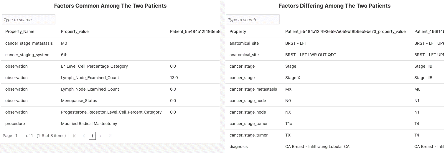

Finally, you can also look at which clinical attributes are matching between these two patients and which clinical attributes are different as shown below.
Factors common to two patients example.

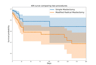

We also added the Kaplan-Meier estimator for comparing multiple procedures in terms of the survival probability either across similar patients or across all patients as shown below.
Kaplan-Meier estimator comparing multiple procedures to determine survival probability.
