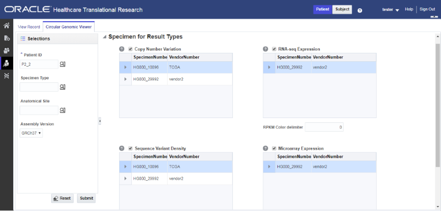

Select data to plot
Figure 4-1 Selecting data to plot for the Circular Genomic Viewer

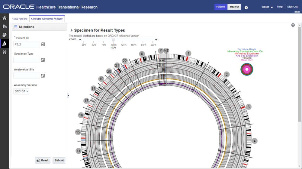

Here is how the graph looks.
Figure 4-2 How genomic data is visualized in the Circular Genomic Viewer
