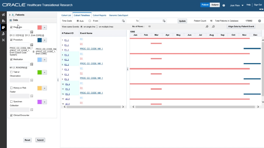

Display patient or subject data
The subject and patient data display is divided into two sections.
- The left side has attributes about the selected patients/ subjects: Patient/ Subject ID and Event Name.
- To see demographic data for a Patient or Subject, hover over their ID.
- The right side shows the colored layers of the selected clinical data, in a timeline view.

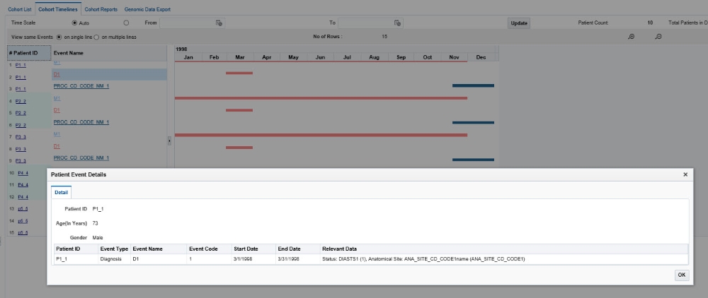

Figure 3-4 Event data shown in a pop-up window
- To navigate to the Single Patient Viewer, and see details of a specific subject or patient, click the Subject or Patient ID.
