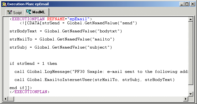

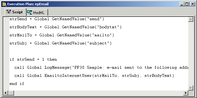

- Script — Editor window that enables you to create the script that runs when the associated event fires.
- MedML — Read-only tab that displays the MedML tags that define the execution plan.
- In the Script window, create a script, using VBScript. You can use an execution plan script to accomplish any of the following:
- Log an event to the Windows event log.
- Pass a context string from a rule.
- Send email.
When creating an execution plan script, you can use the objects described in the MedML online help. The examples shown in Execution plan objects and methods illustrate scripts for each of the activities you can perform with execution plans.
