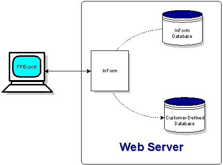

Bulk transfer
With bulk transfer, the CDD Export component of the PF Export data transfer utility provided with the InForm application transfers data to the CDD on demand in a bulk export operation. This method enables you to transfer all of the data at once, for example, if you set up another analysis database after a trial has been running for a while. For information on using the CDD option of the InForm Export utility, see InForm Utilities Guide.
