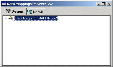

The Create Data Mappings dialog box appears.
- Accept the default of Manual, and click OK. The Data Mappings window opens in the Trial Design workspace.
