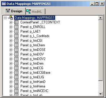

- In the InForm Architect application, select the Data Mappings item.
- Double-click the appropriate mapping definition.
The Data Mappings window appears.

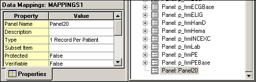

- In the Data Mappings window, right-click the mapping node and select New Panel.
A new panel node appears.
- Edit the panel properties as needed. Specify Non-Patient Data as the value of the Type property.
