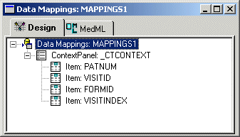

- Select Manual and click OK.
The Data Mappings window opens in the Trial Design workspace. The mapping definition generated by the InForm Architect application includes the definition of a context panel along with the standard context panel items, PATNUM, VISITID, FORMID, VISITINDEX, and FORMINDEX.
