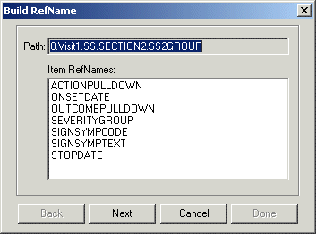

  3. Right-click the control and select Add Source from the popup menu. The Build RefName dialog box appears.
Note: If the target calculated control is in a repeating visit, repeating form, or itemset, the source control must be in the same visit, form, or itemset. In these cases, the Path field in the Build RefName dialog box is partially filled in with the required RefNames.
  1. For each component of the RefName path, select the component from the list in the dialog box.
  2. Click Next, or, to backtrack to a previous component, click Back.
    The InForm Architect application builds the path from your selections and displays it in the Path field at the top of the dialog box.
  3. When the RefName path is complete, click Done.

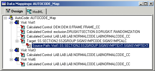

    The InForm Architect application inserts the path into the component definition you are creating. The following figure shows the Data Mappings window with a completed source control mapping definition.
