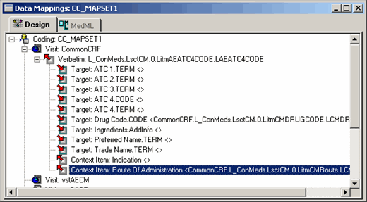

To remove a context item path:
- In the Trial Objects window, double-click the name of the coding mapping object.
The Data Mappings window opens with the mapping object name selected.
- Expand the Visit and Verbatim nodes containing the context item path you want to remove.
- Right-click the Context Item node, and select Clear Context Item Path from the right-click menu.
The InForm Architect application removes the RefName path from the definition of the context item.
