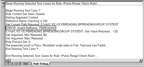

Using the RefName checker
The RefName checker is a tool that enables you to check the validity of RefName paths specified explicitly in a script or entered as arguments. When you run a script while the RefName checker is on, the InForm Architect application reports invalid RefName paths in the Output window.
To use the RefName checker:
  1. Open the Rule window.
  2. Click the Toggle RefName Check () button.
  3. Set up and run test cases as described in Running interactively.
    The InForm Architect application runs the script against the specified values, and reports the progress and results in the Rule Debug tab of the Output window. Invalid RefNames are reported as errors.
