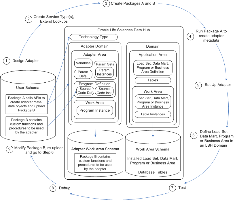

The following diagram depicts the process required to create an adapter.
To develop an adapter, work in SQL Developer or a similar tool, using your own Oracle Life Sciences Data Hub user account that is linked to a database account with Execute privileges on the API security package CDR_PUB_API_INITIALIZATION.
