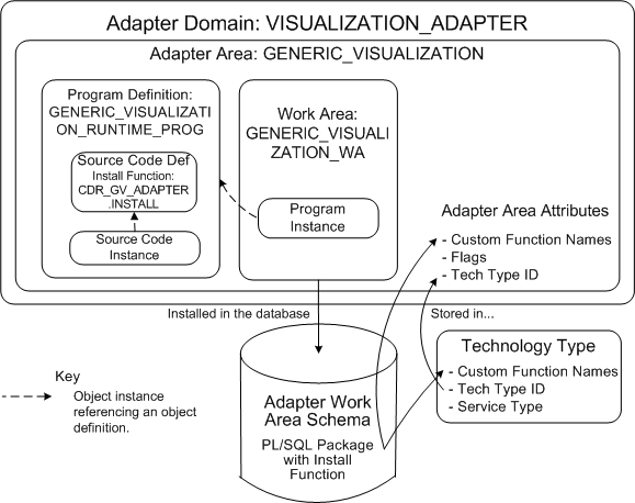

All the defined objects, from the Adapter Domain down, are shipped with Oracle Life Sciences Data Hub.

Generic Visualization Adapter Definitional Components
As shown in Figure 5-1 these include:
- Adapter Domain VISUALIZATION_ADAPTER
- Adapter Area GENERIC_VISUALIZATION; see Table 4-2 for its attribute values.
- Program GENERIC_VISUALIZATION_RUNTIME_PROG contains a Source Code definition that includes a single function, the install_function, named CDR_GV_ADAPTER.INSTALL. This function is called whenever a Definer installs a Generic Visualization Business Area instance. It does the following:

- Work Area GENERIC_VISUALIZATION_WA containing an instance of the Program GENERIC_VISUALIZATION_RUNTIME_PROG. The Adapter Area Work Area is installed in its own Oracle Life Sciences Data Hub schema.
- Technology Type GVA; see Table 4-1 for its attribute values.
Generic Visualization Business Area instance attributes Schema Name, Default Currency, and Default Blinding Access Type are not stored in the define-time Parameter Set as in other adapters. They are stored in satellite table CDR_BUSINESS_AREA_REFS so that the public APIs can change their values.
Figure 5-1 Generic Visualization Adapter Components
Description of "Figure 5-1 Generic Visualization Adapter Components"
Parent topic: Using the Generic Visualization Adapter
