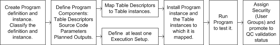

Figure 3-1 shows the process of creating an instance of an existing Program definition. The process is similar for all object types. When you create a new instance of an existing Program definition, you do not need to create Table Descriptors, Source Code, Parameters, or Planned Outputs because they are included in the Program definition. You do need to map the Table Descriptors to Table instances and define at least one Execution Setup. You then install the Program instance and the Table instances to which it is mapped, run and test the Program instance, validate it and assign user groups to it according to your company's policies.
Figure 3-1 Creating a New Program Instance from an Existing Program Definition
Description of Figure 3-1 follows
Description of "Figure 3-1 Creating a New Program Instance from an Existing Program Definition"

Figure 3-2 shows the process of creating a new Program definition and instance. The process is similar for all object types. You first create the object as a whole, classify both the definition and the instance, then define component objects: in the case of Programs these include Table Descriptors, Source Code, Parameters, and Planned Outputs. All executable instances require mapping Table Descriptors to Table instances and defining at least one Execution Setup. You must install all object instances in their Work Area, assign user groups for object security and validate the definition and the instance according to your company's policies.
Figure 3-2 Creating a New Program Definition and Instance
Description of Figure 3-2 follows
Description of "Figure 3-2 Creating a New Program Definition and Instance"
