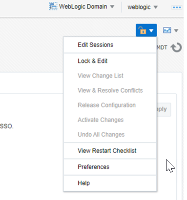

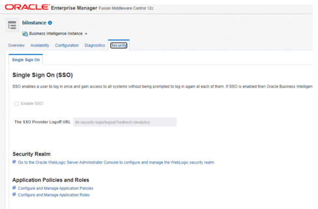

6.4.1.2 Disable Oracle Business Intelligence Enterprise Edition 12c Enterprise Manager SSO authentication
With Oracle Business Intelligence Enterprise Edition 12c, SSO authentication is enabled by default. For Oracle LSH users to access Analytics, disable the SSO authentication as described in the following procedure.
