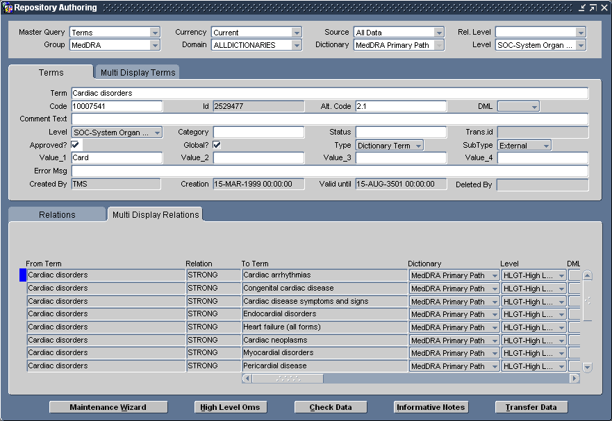

Structure of the Window
Organizationally, the Repository Authoring window has three sections that follow the creation of a relation between terms.
Figure 12-3 Figure 12-3 The Repository Authoring Window
There are three sections in the window:
- The Filter block at the top of the window enables you to narrow the parameters of your query.
- The Terms block displays information about one term in the relation. You can view detailed information about one term in the Terms tab window, or view all terms that match your query in the Multi Display Terms tab window.
- The Relations block displays information about the other term in the relation, as well as information about the strong or named relation between the terms. As with the Terms block, you can view detailed information in the Relations tab window, or view less detailed data about all matches by using the Multi Display Relations tab window. In the example shown in Figure 12-3, TMS displays relations in the lower block that contain "Cardiac disorders," the term selected in the upper block.
When you double-click a record in the Relations block, TMS requeries for relations that contain the other term in the selected row. In the example in Figure 12-3, if you double-click the second row shown in the Multi Display Relations block ("Cardiac disorders – STRONG – Congenital cardiac diseases"), TMS displays "Congenital cardiac diseases" in the Terms block, and displays relations that contain that term in the Relations block.
