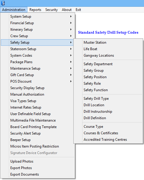

The Safety Setup contains all the codes required in Standard Safety Drill and Advance Safety Drill modes. The setup varies depending on the mode defined in Parameter group, Safety, Advance Safety Drill (0=Standard Safety Drill / 1 = Advance Safety Drill).
Safety Setup Type
In below figures, you will see the list of codes available to Standard Safety Drill and Advanced Safety Drill mode.
Below is the function codes available to Standard Safety Drill mode where Parameter, Safety, Advance Safety Drill set to “0”.
Figure 7-1 Standard Safety Drill Setup Codes
Figure 7-2 Advance Safety Drill Setup Codes
Table 7-1 Safety Setup Configuration Codes

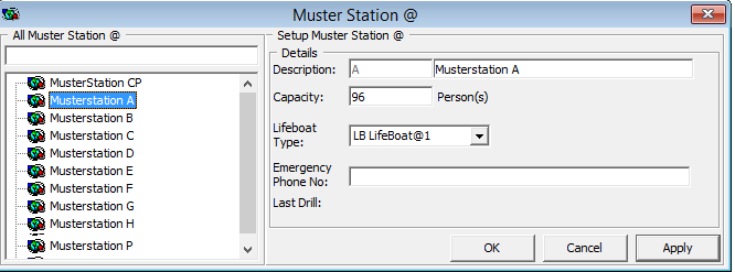

Setting Up Muster Station

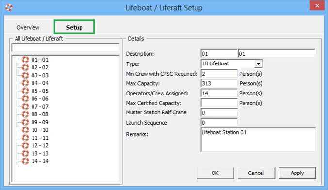

Setting Up Lifeboat/Liferaft
A lifeboat/liferaft has a maximum capacity and does require a number of qualified crew to handle them in the event of an emergency.
Figure 7-4 Lifeboat/Liferaft Setup
Table 7-2 Lifeboat/Liferaft Setup Field Definition
| Field Name | Description |
Description |
Short code and description of the lifeboat/liferaft. |
Type |
The type of lifeboat/liferaft. These codes are predefined and hard coded. |
Min. Crew with CPSC Required |
Minimum number of CPSC certified crew on lifeboat/liferaft. |
Max Capacity |
Maximum capacity allowed per lifeboat/liferaft. |
Operators/Crew Assigned |
Number of crew assigned to this lifeboat/raft. |
Max Certified Capacity |
Maximum certified capacity of the lifeboat/raft. |
Muster Station Raft Crane |
Raft crane the lifeboat is assigned to in Muster Station. |
Launch Sequence |
Launch sequence of the lifeboat. |
Remarks |
Additional remarks of the lifeboat. |
To setup the codes, repeat steps in Setting Up Muster Station. You can also duplicate an existing Lifeboat code using the same steps.

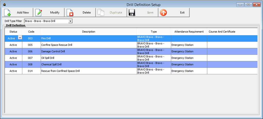

Setting Up Drill Definition
Figure 7-5 Drill Definition Setup
- From the Safety Setup menu, select the Drill Definition.
- To add a new drill, click Add New.
- Select the Status from the drop-down list. and enter the Drill Code and description.
- In the Drill Definition section, select the Drill Type from the drop-down list.
- Enter the Unit of Frequency and Required x Days after embarkation.
- Click Save to save the record.
- Select the drill and click Modify.
- Enter the Location, Instructor, Required Operational Positions and Assigned Manning Number.
- At the Location and Instructor section, right-click and select Add New.
- Select the location from the drop-down list and enter the comment or function, if any.
- At the Required Operational Positions section, right-click and select Add New.
- Add a position individually or select Add All to select multiple positions or all.
- In the Assigned Manning Number section, repeat step 7 and select Assigned Manning number.

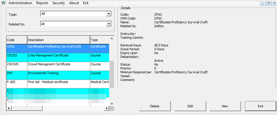

Setting Up Course and Certificates
Figure 7-6 Course and Certificates Setup Window
- Select the Course and Certificates from the Safety Setup menu.
- In the Course and Certificate window, click New.
- In the Code and Name section, enter the code and the name of the course.
- Select the Type and Related to from the drop-down list.
- Enter the course description, instructor’s name and the training center location.
- Select the type of expiration section.
- Enter the Minimum Required Per Vessel.
- The Active checkbox is checked by default. Un-check if you wish to disable the course.
- Check the Priority checkbox if the course is a priority.
- Click OK to save the code.

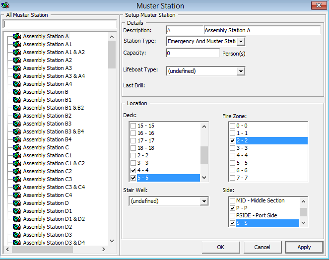

Setting Up Muster Station In Advance Drill Mode
Setting Up Lifeboat/Liferaft in Advance Drill Mode

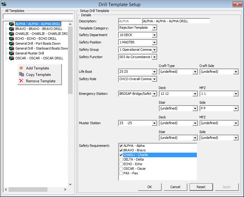

Setting Up Drill Template in Advance Drill Mode
A drill template is setup to assist you in generating a crew list under Proposed Crew section using the criteria defined when creating a drill.
Figure 7-10 Drill Template Setup
- Select Drill Template from the Safety Setup menu.
- Right-click the blank space and select Add Template.
- In the Details section, enter a short code and description, and then select the applicable code in all the fields.
- Click Apply to save the template.
- Click OK to exit.
- Click Reset to clear the selected information from the screen.

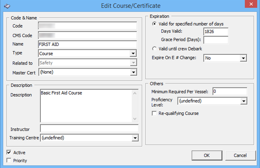

Setting Up Course and Certificates in Advance Drill Mode
Figure 7-11 Course and Certificate Setup Advance Drill Mode
Figure 7-12 Edit Course/Certificate Window
- Select the Type and Related to and Master Cert from the drop-down list.
- In the Description section, enter the course description, instructor’s name and the training center location.
- In the Expiration section, Select the type of expiration.
- Enter the Minimum Required Per Vessel, Proficiency and check the Re-qualifying Course, if required.
