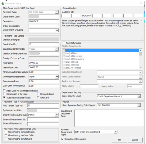

Department Setup
Department Setup
A debit and credit department code of each credit card type accepted by the ship must be configured for charging and posting to take place.
Credit/Debit Card Department Code Setup
  1. Login to Administration module and select Financial Setup, Department Setup from the drop-down list.
  2. Click New to create a Sub-Department code.
    Figure 2-1 Department Code Setup
    This figure shows the Department Code Setup
  3. Under the Main Department section, enter the credit/debit card information such as Payment type, department code and description.
  4. In the Payment Type Details section,
    1. Enter the first two digits of the first set of the credit card number in Credit Card digit.
    2. Enter the Credit Card ID, for example MC — MasterCard, VI — Visa, and others.
    3. Select the corresponding Credit Card Internal ID from the drop-down box.
    4. Enter the Credit Card Merchant Number provided by the Service Provider.
    5. Set the Minimum Authorized Value to 0.
    6. Select the Commission department from the drop-down list and update the commission rate in percentage.
    7. Check the Debit Card No Commissioncharge if commission is not applicable to debit card.
  5. In the Department Security access, select the appropriate security level from the drop-down box.
  6. Select the Payment Type under the Payment Department Type, either Both Credit and Debit card, Credit card or Debit card.
  7. Click OK to save.

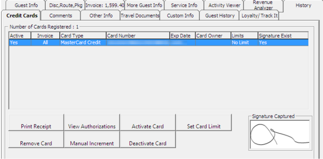

  1. Login to Management module and navigate to Guest Handling screen.
  2. In the Search Panel, browse for the guest account and navigate to the Credit Card tab in the guest account. The registered card should be in an Inactive mode.
  3. To display the initial authorization, select the credit card and click CView Authorization in the middle section of the screen.
  4. Navigate to the Invoice tab to view the sale transaction of the credit card. The amount is credited automatically onto the invoice if the card is a Debit Card.

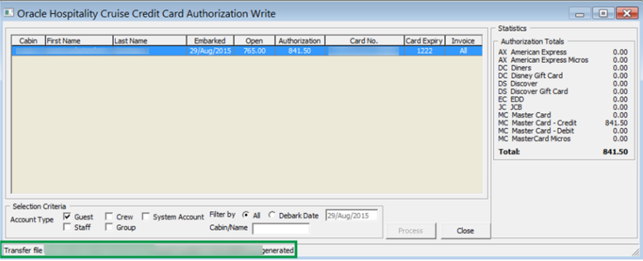

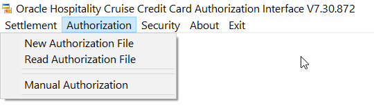

Creating Incremental / Top up Authorization File
  1. Start the Credit Card Transfer Interface and select Authorization menu, and New Authorization File from the drop-down menu.
    Figure 2-6 Credit Card Transfer — Authorization Tab
    This figure shows the Credit Card Transfer — Authorization Tab
  2. In the Cruise Credit Card Authorization Write screen, a list of credit cards requiring incremental authorization are displayed in the grid. Use the Selection Criteria to filter the desire information.
    Figure 2-7 New Authorization Screen
    This figure shows the New Authorization Screen
  3. Click the Process button to generate the Authorization file. After the file generation completes, location of the saved file is indicated on the screen.
    Figure 2-8 Authorization File Location
    This figure shows the Authorization File Location
  4. In Management module, Guest Handling function, select the guest account and navigate to Credit Card tab. Click View Authorization to open the Authorization screen. Status of the transaction pending authorization are reflected as ‘Outstanding’.
Figure 2-9 Management — Authorization Screen Manual
This figure shows the Management — Authorization Screen Manual

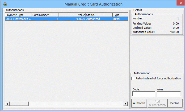

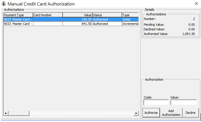

Obtaining Manual Authorization
A manual authorization is available on an ad hoc basis and this is performed within the guest account.
  1. In Management module, Guest Handling function, select the guest account.
  2. Navigate to the Credit Card tab and click View Authorization.
  3. In the Authorization screen, select Add Authorization.
  4. Enter the value and the authorization code in the Credit Card Authorization screen when prompt, and click OK to save. This sets the status to ‘Authorized’ in the Manual Authorization screen.
    Figure 2-11 Management — Add Authorization Screen — Credit Card Authorization
    This figure shows the Management — Add Authorization Screen — Credit Card Authorization
  5. The Authorized code and value is shown at Authorization section when selecting the manual authorized transaction.
Figure 2-12 Manual Authorization Screen, Forced Status
This figure shows the Manual Authorization Screen, Forced Status

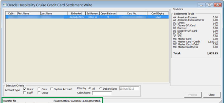

Creating Settlement File
At the end of an invoice settlement, the system writes the settlement into the Settlement file, to be process in a batch.
  1. In the Credit Card Transfer Interface program, select from the drop-down menu Settlement, then New Settlement File.
  2. Click the Process button to generate the Settlement File. After the Settlement file is created, location of the saved file is shown on the screen.
Figure 2-13 Settlement Write Screen
This figure shows the Settlement Write Screen

File Name Format
The file naming format for Generic Credit Card is explained in below table. For example: GuestTransfer#######.pci.
Table 2-8 Generic Credit Card File Format
Name Description
Guest
The first word of the file name is representation of the Account Type base on the filter used to generate the authorization file.
Guest - GuestTransfer#######.pci
Crew - CrewTransfer#######.pci
Group - GroupTransfer#######.pci
Staff - StaffTransfer#######.pci
All filter - <Blank>Transfer#######.pci
Transfer
The second word of the file name represent the type of transfer.
TestTransfer = test authorization file
Transfer = Authorization transaction file
Settle = Settlement transaction file.
071020161138
The date/time format of the authorization file
DDMMYYYYHHMM.
PCI or PCR
The file format extension of the authorization file
pci = request file
pcr = response file
