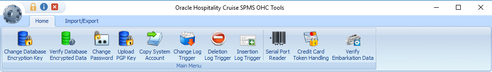

Run OHC Tools and select Upload PGP Key to upload PGP key pair for DCC handling.
Figure 6-2 OHC Tools Menu

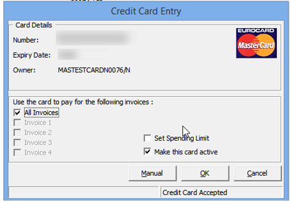

Select a checked-in guest and click Get Credit Card button in guest handling screen.
The system will prompt a message requesting the card to be swiped. Swipe the card through the card slot of the card device.
After the card is swiped, the credit card information and its status are reflected on the credit card entry. If the credit card is valid, the credit card accepted status is shown on the screen.
Figure 6-5 Credit Card Entry Details
The processing screen displays during the credit card registration in the Credit Card Entry screen.

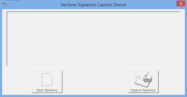

To use the Signature Capture feature, the parameter ‘Enable Signature Capture for Credit Card’ must be enabled and the Signature screen will prompt when the card is registered at both the Management module and the device.
Figure 6-7 Signature Screen at Module
After the guest places their signature on the device, click Enter to complete the credit card registration process. If Cancel is pressed, you will receive a No Signature Received promptly in Guest Handling screen.
A Transaction Completed screen will display on the device when the registration completes or Transaction Cancelled when the Cancel button is pressed.
The signature captured is shown on the signature screen. Clicking the Clear Signature button resets the signature and allow the guest to place a fresh signature.
Click the Capture Signature button to complete the credit card registration on the guest account.

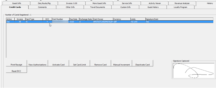

The registered credit card details are stored in the Credit Card tab of Guest handling screen, with the DCC column flagged with ‘Y’ when the card is enrolled with DCC. At the Signature Captured column, the signature captured during the credit card registration is shown. The program does not allow credit card registration without a signature when parameter Enable Signature Capture for Credit Card is enabled.
Figure 6-8 Guest Handling Credit Card Screen

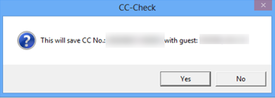

For DCC handling, below message box will prompt when the ‘Card Reader Type’ is assigned to magnetic swipe device. This shows that the credit card is eligible for DCC enrolment.
Figure 6-9 DCC Enable Screen — Manual Card Swipe
Click Yes to enroll the DCC handling or No to register credit card without DCC handling.

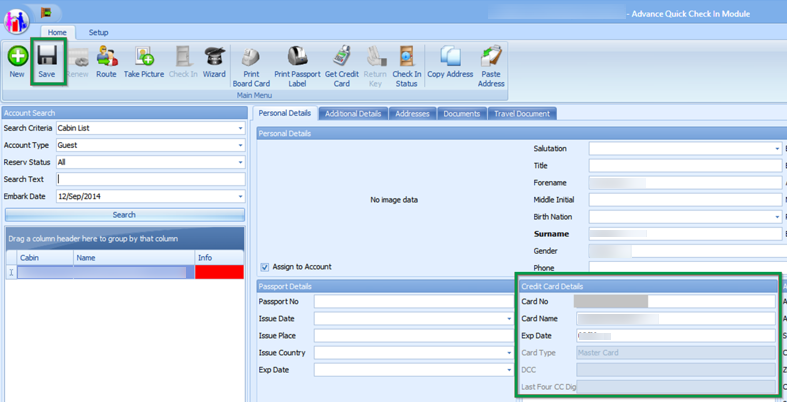

After the card is swiped, the credit card details populate in the respective field of Credit Card Details section.
Figure 6-10 AQCI Credit Card Section
Click Save to proceed with the registration. If the credit card is eligible for DCC enrolment, the system prompts the DCC handling message, requesting you to select the currency on the device.

Have the guest place the signature on the device signature screen and press Enter to complete the card registration. The guest signature is captured and shown on AQCI screen. Click the Capture Signature to save and complete the registration.
Clicking the Clear Signature button erases the signature, allowing the guest to replace the signature. This prompts a No Signature Received on AQCI screen and Transaction Cancelled on the device.

For DCC handling, when the ‘Card Reader Type’ is assigned to magnetic swipe (not Verifone device), the system prompts a message if you would like to settle the invoice in xxx currency. This shows that the credit card is eligible for DCC enrolment.

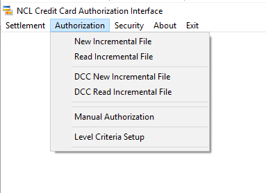

OHC Credit Card Transfer
DCC New Incremental File: For credit card enrolled with DCC Handling.
New Incremental File: For normal credit card registration that is not enrolled with DCC Handling.

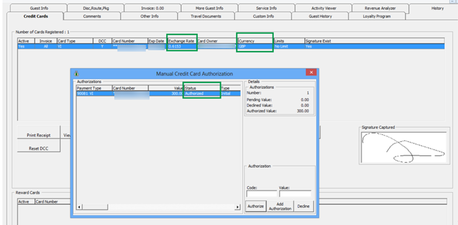

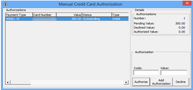

At the Authorization menu, clicking the DCC New Incremental File will list all the credit card requiring authorization that is flagged with DCC= “Y” on the DCC Credit Card Authorization Write screen.
Figure 6-13 DCC Credit Card Authorization Write Screen
The initial authorization amount refers to Minimum Authorization in Credit Card Financial Setup. -
After the Process button is clicked, an Authorization file is generated and encrypted with a PGP key.
Figure 6-14 Sample PGP Encrypted Authorization File
Status for the pending approval authorization transaction is Outstanding, and the transaction can be traced in Management module, Guest handling, Credit Card tab, View Authorization.
Figure 6-15 Credit Card Authorization in Management Module

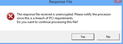

After you have obtained the response file from the merchant, at the Authorization menu, select DCC Read Increment File.
Click the Open File button and locate the response file from the merchant.
If the response file is not encrypted, an alert message box shall prompt. Select the appropriate response.
Figure 6-16 Non-encrypted Response File

Click the Process button to continue and this populates the authorization transactions onto the grid.
Figure 6-18 DCC Credit Card Authorization Read Screen with Data
Click the Process button again to begin the process. The progress status is displayed on DCC Credit Card Authorization Read screen.
After the authorization completes, the authorization status in Guest Handling, Credit Card tab, View Authorization is updated to Authorized, with the exchange rate provided in the response file. The exchange rate is also stored in the DCC table.
Figure 6-19 OHC Management — Credit Card Tab

Generating Incremental File with Authorization Template
An Authorization Template is used to obtain additional authorization amount. Usage of this template only applies to Incremental Authorization and does not apply to Initial Authorization. Below are the steps to setup the Authorization Template.
At the Authorization menu, clicked the Level Criteria Setupfrom the drop-down list.
Figure 6-22 OHC Credit Card Transfer — Authorization

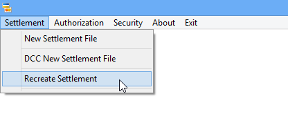

Click the Recreate Settlement from the Settlement menu.
Figure 6-28 Settlement Menu — Recreate Settlement
