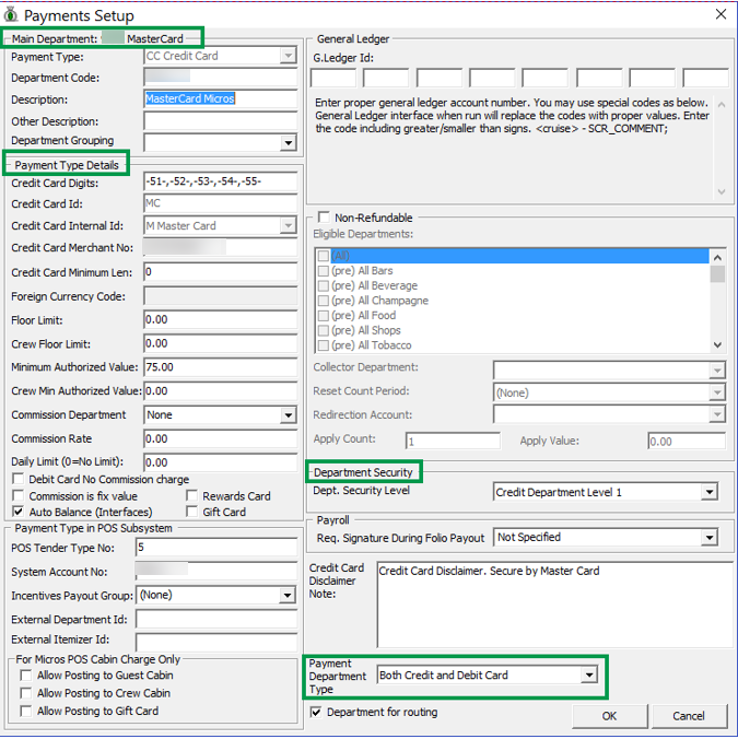

A debit/credit department code of a credit card type is required for charge/posting and this is setup up in Administration module, Financial Setup, Department setup.
Credit/Debit Card Department Code Setup
  1. Login to Administration module and select Financial Setup, Department setup from the drop-down list.
  2. Click New to create a Sub-Department code.
    Figure 5-1 Department Code Setup
    This figure shows the Department Code Setup
  3. At the Main Department section, enter the credit/debit card information such as Payment type, department code and description.
    1. Enter the two digits of the first set of the credit card number of the Credit Card type.
    2. Enter the Credit Card ID. For example, MC for MasterCard, VI for Visa, and others.
    3. Select the corresponding Credit Card Internal ID from the drop-down list.
    4. Enter the Credit Card Merchant Number provided by the Service Provider.
    5. Select the Commission Department from the drop-down list and update the commission rate in percentage.
    6. Check the Debit Card No Commission charge if the commission is not applicable to debit card.
  4. At the Department Security access, select the relevant security level from the drop-down list.
  5. Select the relevant Payment Type under Payment Department Type, either Both Credit and Debit card, Credit card or Debit card. This field determines whether the payment type is a Credit Card or Debit Card.
  6. Click OK to save.

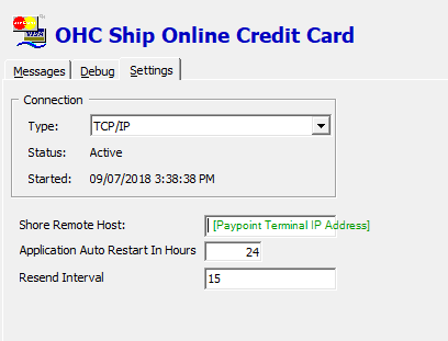

  1. Start OHC Ship Transf.exe and navigate to the Settings tab.
  2. Enter the Shore Remote Host IP address. The shore remote host is the Paypoint Terminal IP address.
    Figure 5-2 OHC Ship Transfer — Setting Screen
    This figure shows the OHC Ship Transfer — Setting Screen

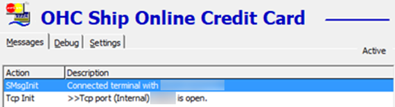

  3. The connection is shown in Message tab per below figure.
Figure 5-3 OHC Ship Transfer — Message Screen
This figure shows the OHC Ship Transfer — Message Screen

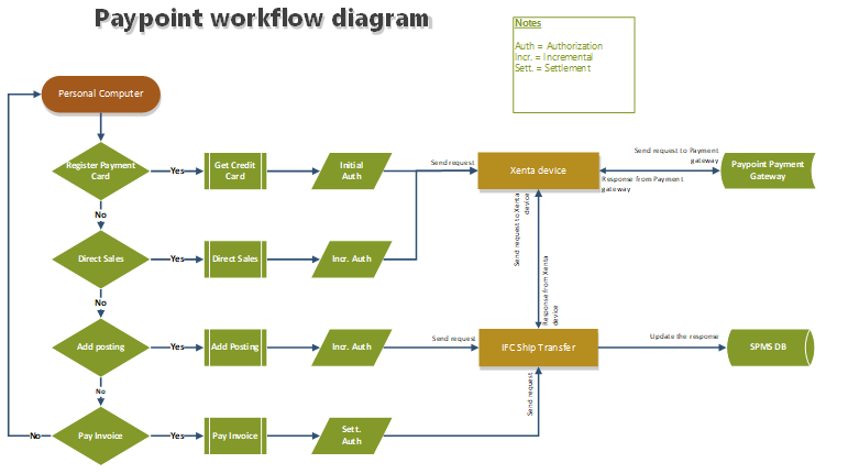

Paypoint Workflow
The SPMS application communicates with Paypoint device through a TCP/IP protocol and the device handles the communication with the host through its own network card. The IP address is stored in the Paypoint device itself.
Send Initial Authorization
Authorization requests performed at Management module, Get Credit Card or Advance Quick Check-in module, Get Credit Card/Direct Salesare sent to the Paypoint device before passing them to the Paypoint Payment Gateway.
Send Incremental/Settlement Authorization
An Incremental/Settlement request performed at Management module, Add Posting / Pay invoice function is sent to OHC Ship Transfer module before being passed to Paypoint payment gateway.
Figure 5-4 Paypoint Credit Card Handling Workflow
This figure shows the Paypoint Credit Card Handling Workflow

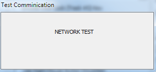

  3. After the Save PED IP button is clicked, a Test Communication between the Management module and the device shall commence.
    Figure 5-6 Management — Test Communication — In Progress
    This figure shows the Management — Test Communication — In Progress

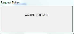

    Figure 5-7 Management — Get Credit Card
    This figure shows the Management — Get Credit Card
  4. When you click the Get Credit Card button at Guest Handling, the program communicates with the device and prompts to insert/swipe a credit card.

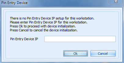

  1. At the start up the AQCI module and if the module has never been connected/configured with a card device, the Pin Entry Device screen without an IP address prompts ‘Enter the device’s IP address’ and click OK.
    Figure 5-8 Advance QCI — Pin Entry Device
    This figure shows the Advance QCI — Pin Entry Device

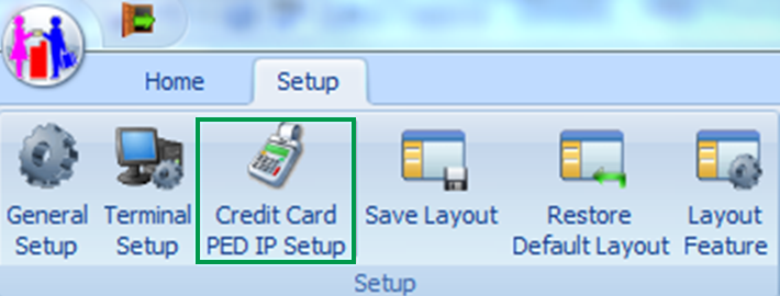

  4. To change or re-test the connection, navigate to the Setup tab, click the Credit Card PED IP setup at the ribbon bar and the Pin Entry Device IP screen shall prompt. Click the PED Overwrite button and enter the new IP address.
    Figure 5-10 Advance QCI — Credit Card PED IP Setup
    This figure shows the Advance QCI — Credit Card PED IP Setup

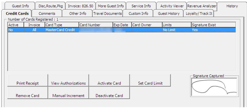

  3. Navigate to the Credit Card tab of the guest account. The registered card status should be in Inactive mode.
    Figure 5-11 Management Credit Card
    This figure shows the Management Credit Card

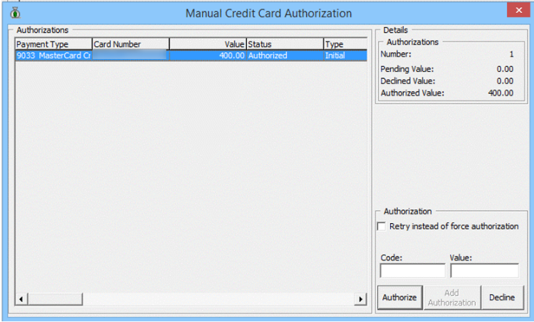

  4. To display the initial authorization, select the credit card and click View Authorization.
  5. The Authorized Value shown in View Authorization is the last authorization amount, excluding the amount from Direct Sales.
    Figure 5-12 Management View Authorization
    This figure shows the Management View Authorization

The remote shore host does not match the Paypoint terminal IP address.
