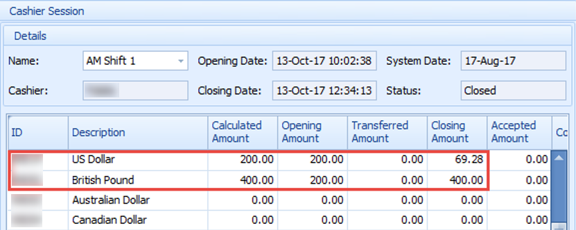

All currency exchange transactions performed are stored in the cashier session. Enabling Parameter “Cashier”, “Show on-board currency” with the On-board currency Financial Department displays the currency in the cashier session.
When performing an exchange by cash, the system captures the cash transaction as onboard currency by default. To show the currency by the specified department, a parameter is required to record in Calculated Amount column in cashier Session. For example, a Guest exchange £200 to Ship Currency (US$) at the exchange rate of $1.50 with a commission of 2%, and the opening balance is set at 200 respectively. In this instance, a Buy transaction is used and the payout to the guest is $65.36 (£200 / 1.5 minus 2% commission charge - $130.72)
Hence the amount reflected in the cashier closing in Calculated Amount is:
Cash Currency Exchange: $69.28 (Opening balance $200 minus pay out $130.72)
British Pound: £400.00 (Opening balance £200 plus amount exchanged of £200)
Do note that the Commission Charge is not included in the Cashier Session.
Figure 4-2 Exchange Transactions with Cashier Session (Balance)
