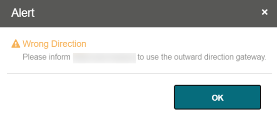

Wrong direction (occurs when a single direction is being used)
This alert message displays when the guest, resident, visitor or crew pass through the gate in the opposite direction set by Security officer.
Figure 5-1 Example of Wrong Direction message
Inward
This error message displays when the security officer selects the direction as Inward and selects the onboard guest record to go ashore.
The default message is “Please inform <Profile’s name> to use the inward direction gateway”. The message for this can be changed from OHC Administration module Administration, System Setup menu, under Labels Setup and GNG007.
Outward
This error message displays when the security officer selects the direction as Outward and selects the ashore guest record to go onboard.
The default message is “Please inform <Profile’s name> to use the outward direction gateway”. The message for this can be changed from OHC Administration module Administration, System Setup menu, under Labels Setup and GNG008.

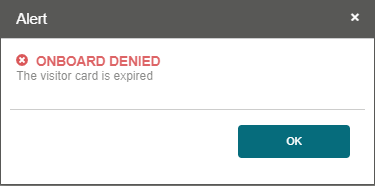

Coming Onboard Validation
Figure 5-2 Sample Onboard Denied Message
The following parameters can be configured in the OHC Administration module, System Setup menu, Database Parameters.
Check Visitor Card: 0- No checking performed; 1- Check on the validity of visitor card
Use Ashore Denied Message: 0- Do not use denied message in Ashore/Onboard Denied function; 1- Use
Deny Boarding
This error message displays when deny boarding shows as YES and the deny boarding reason is entered via the OHC Management module, Cashier Handling, Guests tab, selected guest profile or and the OHC Crew module, Crew Members, selected crew profile.
The default error message is “<Salutation><Full Name> is not allowed due to <deny reason>”. You can define your error message from OHC Administration module, Administration menu, then System Setup menu, then Labels Setup, ODCT01.
Visitor Card is expired
This error message displays when the visitor estimates that the disembark date is earlier than the Cruise System Date and the parameter ‘Check Visitor Card’ is 1.
The default error message is “The visitor card is expired.” You can define your error message from OHC Administration module, Administration menu, then System Setup menu, then Labels Setup, GNG039.

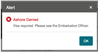

Visa Check
This error message displays when a travel visa is required for the guest, crew, visitor or resident to leave the ship. To activate the visa check, set the parameter Enable Visa Check to 1.
The visa requirements can be set up in these three (3) modules:
OHC Administration, Security, Port/Visa Requirement
OHC Management, Security, Port/Visa Requirement
OHC Crew, Security, Port/Visa Requirement
The default error message is “Visa required. Please see the Embarkation Offer.” You can define your message from OHC Administration, Administration, System Setup, Labels Setup, VMSG01.

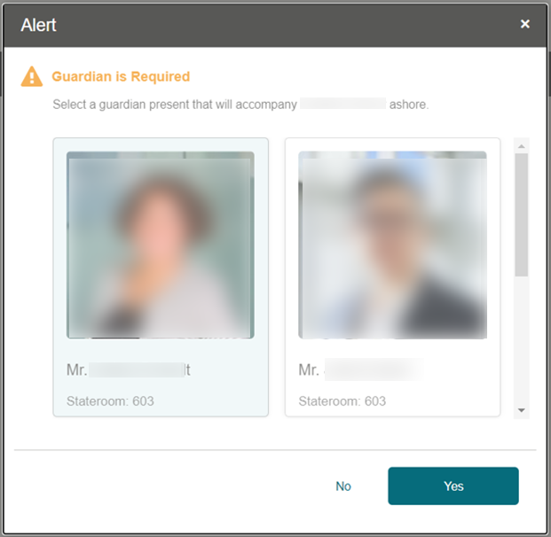

Minor validation
Assign Guardian to a minor
The Security Officer needs to verify if the assigned guardian is accompanying the minor when the minor goes ashore.
Minor with pre-assigned guardian
If the guardian profile is assigned to a minor profile, the system will display the guardian list when the Security Office processes this minor.
The default message is “Select a Guardian that will accompany <minor name> minor ashore”. You can define your message from OHC Administration, Administration, System Setup, Labels Setup, GNG116.
If the Security Officer is not able to find the guardian, the Security Officer will select No to disallow the minor from going ashore. The system displays “A guardian should be physically present with <Minor Name> Minor”.
The default message is “Select a Guardian that will accompany <minor name> minor ashore”. You can define your message from OHC Administration, Administration, System Setup, Labels Setup, GNG117.
Figure 5-4 Guardian Listing

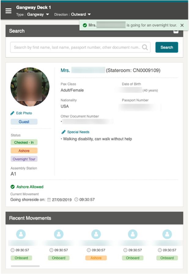

Overnight Tour Notification
If a guest, resident or crew has purchased an excursion tour that requires them to stay overnight on the shore, the system will bring up a notification indicating that the guest, resident or crew is going for an overnight tour.
The overnight tour notification is shown after the guest, resident or crew has successfully changed the onboard status to Ashore.
The default message “<guest name> is going for an overnight tour”. You can define your message from OHC Administration, Administration, System Setup, Labels Setup, GNG032.
Figure 5-5 Overnight Tour Notification
