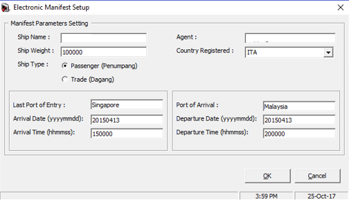

The Malaysia Customs and Immigration department requires the Ship’s operator to submit a pre-arrival passenger manifest before the ship arrival at port. Before you generate the electronic manifest, you are require to update the ship information, arrival/depart port in Manifest Parameter Setting in Malaysia Immigration module.
Setting Up Electronic Manifest
Figure 1-1 Electronic Manifest Setup Window
Table 1-1 Field Definition of Electronic Manifest Setup Window
| Field Name | Description |
Ship Name |
The Registered Name of the vessel. |
Ship Weight |
The weight of the vessel measured in gross registered tons (GRT). |
Ship Type |
Type of ship: Passenger or Cargo. |
Agent |
The Port Agent company name. |
Country Registered |
Country the Ship is registered. |
Last Port of Entry |
The port where the ship last entered. |
Arrival Date |
Arrival date at last port. |
Arrival Time |
Arrival time at last port. |
Port of Arrival |
Next embarkation port of the ship |
Departure Date |
Departure date from Port of Arrival. |
Departure Time |
Departure time from Port of Arrival. |
Run the Malaysia Immigration program.
From the Electronic Manifest, Setup, enter all the above information.
Click OK to save.
