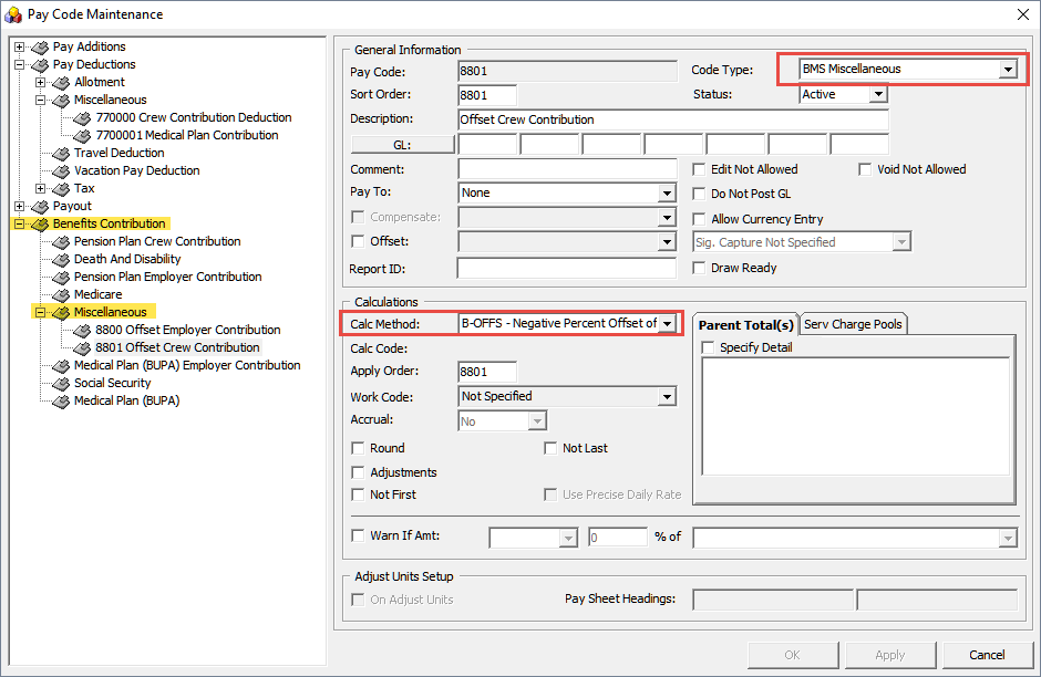

The Offset Crew Contribution or Offset Employer Contribution pay code is used to automatically balance the benefit postings during payroll paid outs at the end of the month. You may create more than one (1) offset pay code and assign it to a different benefits contribution pay code.
The Offset Crew Contribution pay is added as a sub entry in Benefit Contribution – Miscellaneous.

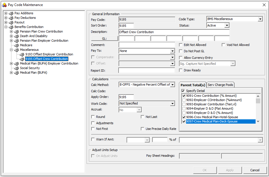

Setting up Offset Miscellaneous Contributions – Crew/Employer Contribution
Figure 4-2 Miscellaneous Contribution Pay Code Maintenance
Unique Pay Code ID
Code Type = BMS Miscellaneous
Pay Code Description. For example, Offset Crew Contribution Deduction or Offset Employer Contribution.
Sort Order. This can be the same as Pay Code ID
Calculation Method = B-OFFS Negative Percent Offset of Another Amount
Apply Order. This can be the same as Pay Code ID
Check the Do Not Post GL if you do not wish to show the pay code in the GL file.
WARNING:
Once the B-OFFS Negative Percent Offset of Another Amount calculation method is selected, the Specify Detail checkbox will become visible. The user must select all the relevant Crew Contribution pay codes IF those pay code in Payroll Benefit Administration (Pension Plan, Crew Medical Plan Contribution, Employer Contribution, Death & Disability Contribution, Medical Plan (BUPA) ) are assigned to offset this pay code. This is to obtain a 100% offset value of the specified pay code.Crew Pension Plan Contribution

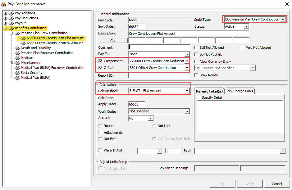

Crew Contribution by Flat Amount
This pay code enables you to specify an amount for crew to contribute to their pension plan.
Figure 4-3 Flat Amount Contribution
Unique Pay Code ID
Code Type = BCC Pension Plan Crew Contribution
Pay Code Description. For example, Crew Contribution Deduction (Flat Amount) or (%Amount).
GL Code where the contribution deductions are credited to.
Compensate must be linked to the Crew Contribution Deductions.
Offset code must be linked to the Offset Crew Contribution.
Calculation Method = B-FLAT Flat Amount
Check the Do Not Post GL if you do not wish to show the pay code in GL file.

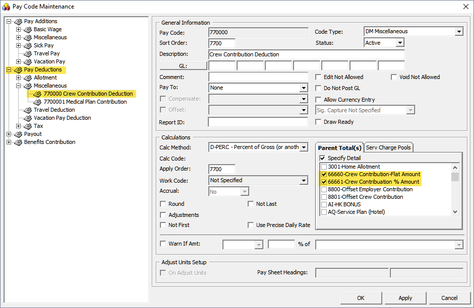

Linking Contribution Pay Codes to Pay Deductions
Once the pay codes are setup, you must link them in the Pay Deductions codes.
Figure 4-5 Pay code Maintenance form
Navigate back to the Pay Deductions – Miscellaneous, Crew Contribution Deductions.
Check the Specify Detail checkbox and select both Contribution Codes.
Click Apply to save.
If the Pension Plan Crew Contribution pay code is assigned to an offset pay code, navigate back to Benefit Contribution – Miscellaneous, Offset Crew Contribution.
Check if they are linked.
Figure 4-6 Offset Crew Contribution

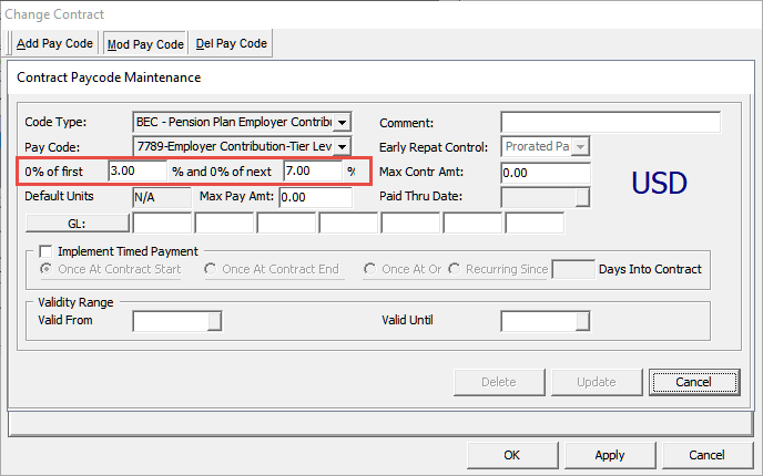

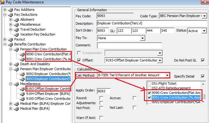

Employer Contribution by Tier Level
The following contribution code is for an employer that contributes using the Tier Level calculation method (100% of the first 3% and 50% of the next 7%) of the crew’s contribution on applicable month earnings.
The Calculation Method is B-TIER – Tiered Percent of another Amount. Select the Offset pay code if you choose to offset the employer contribution in the pay sheet.
Figure 4-8 Employer Contribution by Tier Level

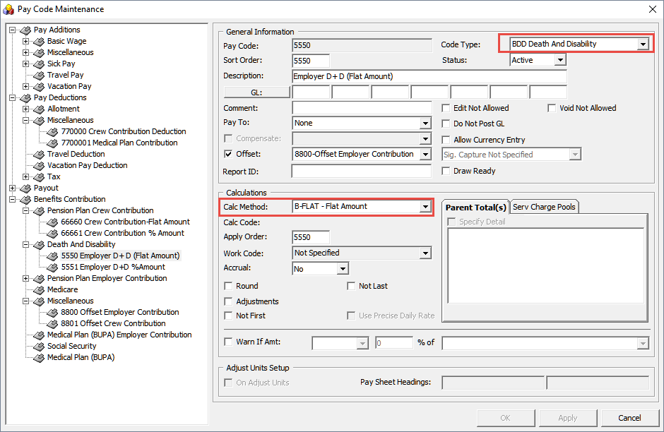

Death and Disability Contributions
Apart from the Pension Plan, one may contribute to the Death and Disability plan. For this, you need to create two (2) separate codes for the calculation method.
Death and Disability (Flat Amount)
Death and Disability (%Amount)
Set up the code just as you would for the other codes.
Figure 4-9 Death and Disability Contributions
Unique Pay Code ID
Code Type = BDD Death And Disability
Pay Code Description. For example, Employer D + D (Flat Amount).
GL Code where the employer contribution expenses are credited to.
Select the Offset pay code if you choose to offset the employer contribution in the pay sheet. The offset pay code refers to Offset Employer Contribution. See Offset Benefits Contribution - Miscellaneous.
Check the Do Not Post GL checkbox if you do not wish to show the pay code in the GL file.
Calculation Method = B-FLAT Flat Amount.
For contribution by Percentage, select:
Calculation Method = B-PERC Percent of Amount
On the Specify Detail page, select the applicable monthly earning pay code. The percentage of Employer Contribution to compensate is based on the selected pay code such as basic wage. The system will calculate the employer contribution amount against the crew’s monthly salary.
Once the Benefit Contribution pay codes have been set up and if the pay code is assigned to an Offset Employer Contribution, navigate back to the Offset pay code and link all the Benefit Contribution codes in the Specify Detail window.

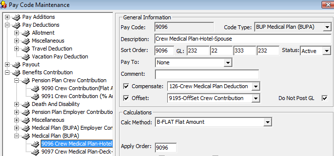

The following pay code is setup for the hotel department crew dependent’s contribution, as an example and is added to Medical Plan category. You are required to create the pay code per the above list, and link them to the Crew Contribution and Offset Crew Contribution code.
Unique Pay Code ID
Code Type = BUP Medical Plan (BUPA)
Pay Code Description. For example, Crew Medical Plan-Hotel-Spouse.
Compensate Pay code must be a Crew Contribution Deduction. This refers to a Pay Deduction. See Pay Deductions.
Select the Offset pay code if you choose to offset the employer contribution in the pay sheet. The offset pay code refers to the Offset Crew Contribution. See Offset Benefits Contribution - Miscellaneous.
Figure 4-10 Medical Plan Pay Code Maintenance

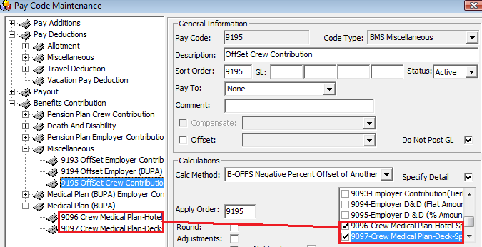

Navigate back to the Pay Deduction, Miscellaneous, Crew Medical Plan Deduction.
Check the Specify Detail checkbox and select the corresponding Crew Medial Plan Contribution pay codes.
If the Crew Medical Plan Contribution pay code is assigned to an Offset Pay code, navigate back to Benefit Contribution, Miscellaneous, Offset Crew Contribution.
Check if they are correctly linked.
Figure 4-11 Offset Crew Contribution

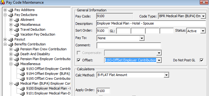

Employer Medical Plan Contribution
The Medical Plan (BUPA) Employer Contribution is the benefit contribution portion of the employer to the employee. Similarly, they are segmented to two (2) pay codes and use the same calculation method:
Medical Plan Employer – Hotel Department
Medical Plan Employer – Deck & Engine Department
Figure 4-12 Employer Medical Plan Contribution
Unique Pay Code ID
Pay Code Description. For example, Employee Medical Plan-Hotel-Spouse.
Select the Offset pay code if you choose to offset the employer contribution in the pay sheet. The offset pay code refers to Offset Employer Contribution. You may create a new Offset pay code to separate the offset value, if preferred. See Offset Benefits Contribution - Miscellaneous.
Check the Do Not Post GL checkbox if you do not wish to show the pay code in GL file.
Apply Order. This can be the same as Pay Code ID.
If the pay code is assigned to an Offset Employer Contribution pay code,
Navigate back to the Benefit Contribution, Miscellaneous, Offset Employer Contribution section.
Check the Specify Detail checkbox and select the corresponding Employer Medical Plan Contribution pay codes.

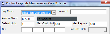

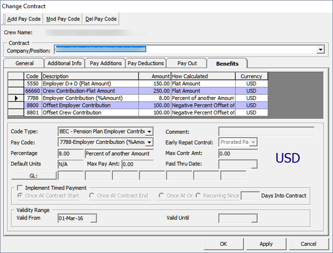

Adding a Pension Plan Code to a Contract
On the Crew Edit Detail form, click Edit Contract of the selected crew.
On the Change Contract form, click Add Pay code and then navigate to the Benefit tab.
Figure 4-13 Pension Plan Contract Pay code Maintenance
Select the Code Type and Pay Code from the drop-down list and insert the value accordingly (Percentage or Flat Amount).
Enter the Validity Range and then click Insert to save the code. Click Apply before closing the form.

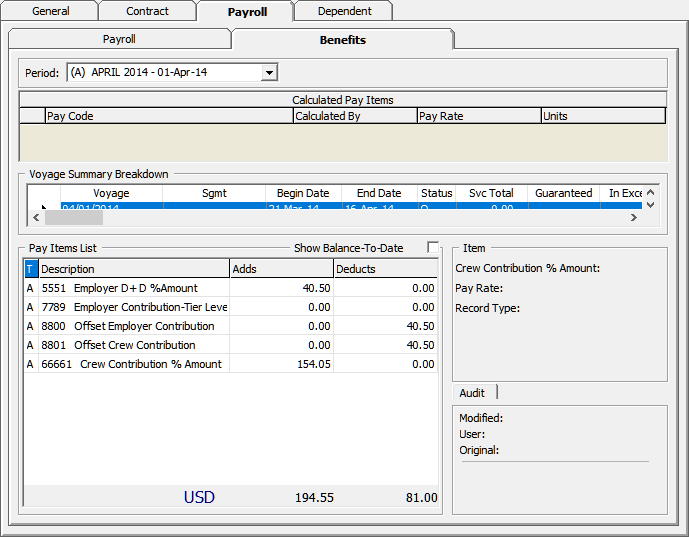

Example 1: Pension Plan with Flat Amount
In the below example, a crew is contributing $250 from his monthly income of $1500 to the pension plan, whereas the employer contributes 8% of the crew' applicable earning to the pension plan and $150 towards the Death and Disability. The crew contract would consist of these pay codes in their contract.
Figure 4-14 Pension Plan with Flat Amount
The following tabs would consist with the following information.
Pay Additions: A Basic Wage of $1500
Benefits:
A Crew Contribution by Flat Amount of $250
A Employer Contribution by Percentage of 8%
A Death and Disability Contributions of $150

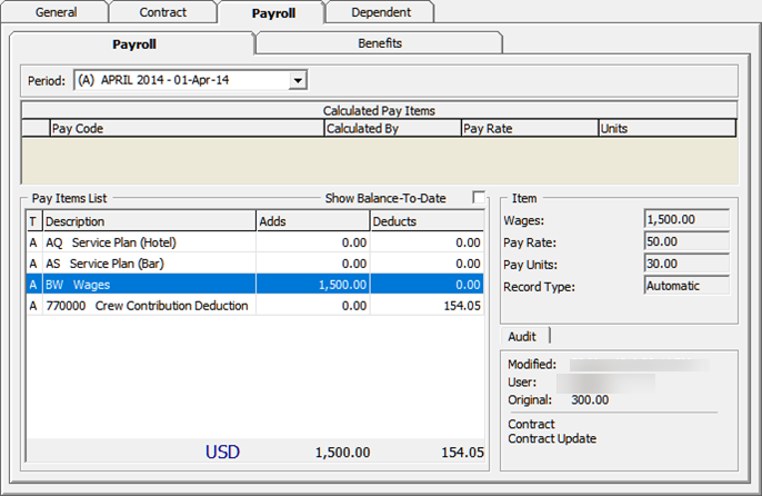

In the Crew Payroll Detail form, the crew member contribution of $250 is reflected on the crew pay sheet under Pay Code Deduction. The crew contribution deduction debited from crew member’s payroll is shown in the Crew Payroll Details, Payroll, Payroll tab.

Example 2: Pension Plan with Percentage Amount
In the below example, a crew member contributes 10% of his total consolidated wages of $1500 to the Pension Plan. The employer will match 100% of the first 3% of the crew contribution and another 50% of the next 7%, based on his applicable monthly earning. The employer also contributes 2.7% of the crew member’s applicable monthly earnings towards the Death and Disability Plan. The crew contract would consist of these pay codes in their contract.
Figure 4-15 Pension Plan with Percentage Amount
The following tabs would contain below information.
Benefits:
A Crew Contribution by Percentage % Amount of 10%
A Employer Contribution by Percentage of 3% and 7%
A Death and Disability Contributions by (%Amount) at 2.7%
For Employer Tier Level contribution, it will have the 3% value in the first field, followed by 7% in the next field.
Figure 4-16 Employer Pension Plan Tier Level
The default 100% for the Tier Level functionality is flexible and able to change from parameter ‘Payroll’,‘Tier 1 Percentage’ and the remaining 50% is defined in ‘Payroll’, ‘Tier 2 Percentage’.Figure 4-17 Payroll Tier
Figure 4-18 Benefits Postings

To add the BUPA Health Coverage, navigate to the Benefit tab of the crew and add the Employer Medical Plan-Hotel pay code.
The system will update all the active pay codes into the crew payroll detail. The employer expense of $107 is not visible on the crew pay sheet but is stored and reported in the General Ledger Month End file.
You can view the Employer Medical Plan Contribution from Crew Payroll Detail, Payroll, Benefit tab. The Offset Employer Contribution will show a negative value to offset the benefit posting.
Example 2 – BUPA Health Coverage with Dependents
In this example, the Staff Captain is entitled to a BUPA coverage of $107 contributed by the employer and has chosen dependent coverage for his spouse. The Medical Plan rate given by BUPA for his dependent option is $107.
To add the dependent coverage,
Navigate to the Benefit tab of the Crew Payroll Detail form and select Crew Medical Plan-Deck-Spouse, and then enter the amount.
Add a pay code for the crew using the Employer Medical Plan-Deck of $107.
Figure 4-21 Health Coverage with Dependents 1
Figure 4-22 Health Coverage with Dependents 2
The system will update the active pay code into the crew payroll detail form. In the Crew Payroll Detail form, the dependent expense of $107 is deducted from the employee and reflected in the pay sheet via Pay Code Deduction.
The crew dependent coverage deduction is debited from crew member’s payroll and is shown under Crew Payroll Detail, Payroll, Payroll tab.
Figure 4-23 Health Coverage with Dependents 3
The Employer expense of $107 is not shown in the crew pay sheet but is stored and reported in the General Ledger Month End file.
You can view the Employer Medical Plan Contribution from Crew Payroll Detail, Payroll, Benefit tab. The Offset Employer Contribution will show a negative value to offset benefit posting.
Contract Templates with Pension Plan and Medical Plan
You can add all the benefit pay codes using the Contract Templates under Contract Template setup.
To add the pay code in the Contract Template,
Select the Salary Position and clickAdd Pay Code.
Select the benefit pay code and enter the percentage rate or flat amount.

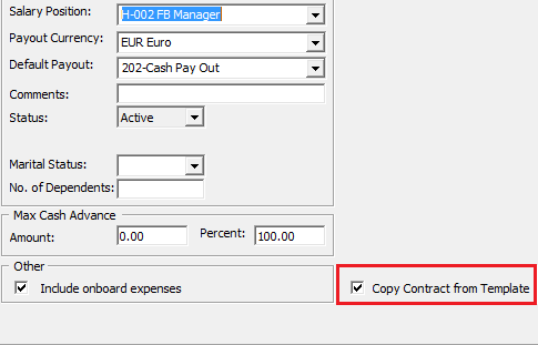

When assigning the contract to the crew member, and in order for the system to auto populate all the benefit pay codes, you must check the checkbox Copy Contract from Template.
Figure 4-24 Copy Contract from Template Checkbox

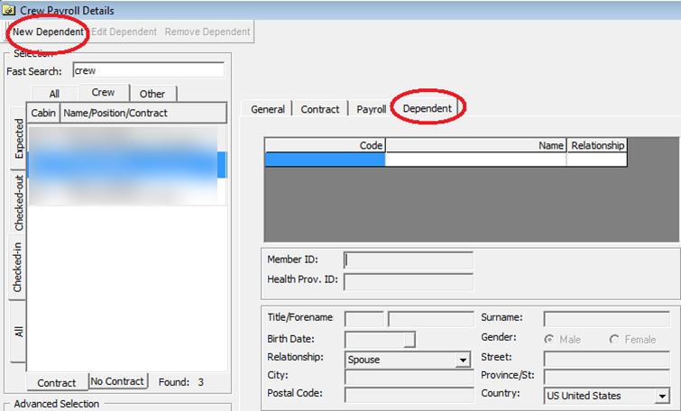

In the Crew member’s Payroll Detail form, a Dependent tab is made available to maintain the dependent’s information.
Figure 4-26 Dependent Information
To add the dependent information,
Click the New Dependent button on the Crew Payroll Details form.
Each dependent should have a unique BUPA ID associated to their Health Provider. Enter the ID in the Member ID and Health Prov. ID field, and the mandatory field such as Forename, Surname, Member ID, Birthday and Relationship Type.
Click Insert to save.
You can add, edit or remove the dependent information where necessary.
