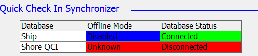

The QCI Sync Interface is an application that connects and synchronizes the Shipside database with the Shoreside database, with its database mode and connection statuses for both the database shown. Apart from that, the synchronization progress is also shown in the Messages tab of the interface.
At the program start up, the application checks both the database status, followed by the state of the database, whether it is in ‘Offline’ or ‘Unknown’ mode before synchronization commences. The status of the ShipDB and the Shore QCI database are shown. See below table for explanation of the status.
Figure 4-1 QCI Sync Mode
Table 4-1 QCI Sync Modes
| Offline Mode | Database Status | Description |
Unknown |
Disconnected |
The QCI Sync Interface is disconnected from the Shore QCI database, possibly due to a network issue, user ‘UID’ does not exist or the Oracle Database Listener has not started and results to the interface unable to determine the Offline Mode. The message "Getting Shore QCI DB Status, please wait..." appears when the interface tries to reconnect to the QCI Shore database every x seconds. |
Disabled |
Connected |
The QCI Sync Interface is connected to the Ship and the Shore QCI database has Offline Mode as Disabled. The synchronization is not able to start and the message "Off-line mode not yet enable cannot sync" appears. |
Enabled |
Connected |
The QCI Sync Interface is connected to the Ship and the Shore QCI database has Offline Mode as Enabled. This indicates the synchronization has started. |
Invalid |
Invalid |
The QCI Sync Interface is connected directly to the Shore QCI database. The system prompts message ‘Ship DB and Shore DB is the same’. |

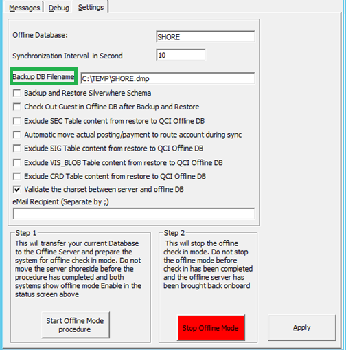

Configuring the Interface
This section describes the settings available in the interface Settings tab. To configure the interface, start the QCI Sync Interface, select the appropriate checkboxes in the Settings tab, and then click Apply to save the changes.
These settings are saved
to the OHCSettings.par file in C:\Public Document\Oracle
Hospitality Cruise folder
Figure 4-2 QCI Sync Interface Settings

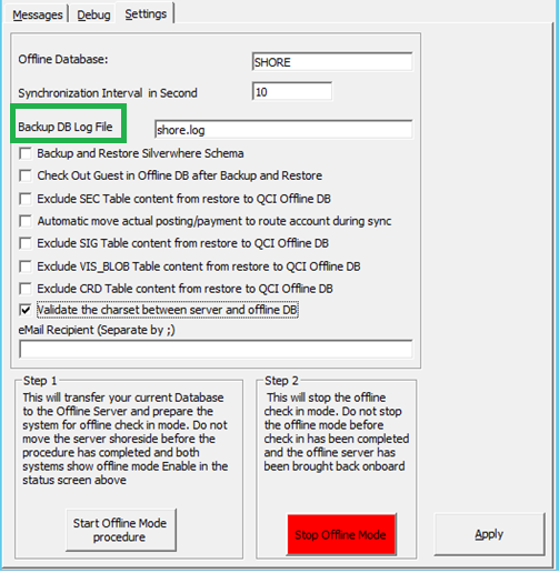

Figure 4-3 QCI Sync Interface Setting —TDE
Table 4-2 QCI Sync Interface Settings
| Parameter | Description |
Offline Database |
Defines the SID of the QCI Shore database and it must be identical to the one created in Oracle Net Manager. |
Synchronization Interval in Second |
Defines the interval time when the synchronization process starts; At every x second between the ship and the QCI shore database. The default value is ten (10) seconds. |
Backup DB Filename |
Defines the ship database backup filename. The same backup
file is used for both the backup and restores processes. The user
must define the full path name where the backup file resides and the
filename extension must be .dmp. For example, If TDE is used, the field name changed to Backup DB Log File. You should provide only the file name excluding the full path, for example; backup. This file name will be used as data import log file. |
