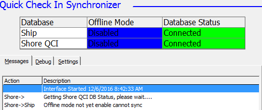

  1. At the QCI Sync Interface PC, run the QCI Sync application.
  2. Ensure both the ship and QCI Shore database status are as per below:
    • Database Status shows ‘Connected’
    • Offline Mode shows ‘Disabled’
    • Messages show ‘Offline mode not yet enable cannot sync’
    Figure 5-1 QCI Sync Offline Mode
    This figure shows the database connection in an Offline Mode.
