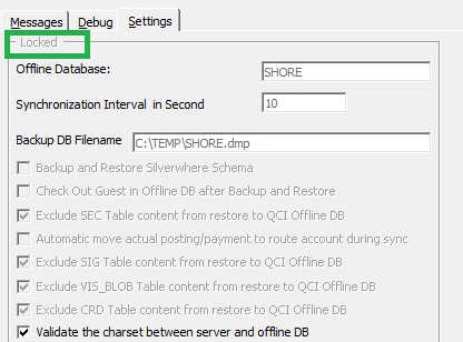

Process 13 |
The system disables all parameters in the Settings tab and a dimmed ‘Locked’ is shown on the window when the Offline Mode is ready. |

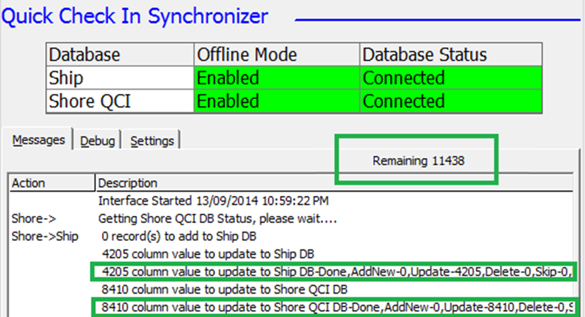

Below are some examples of records that were added from the QCI Shore database to the ship database or vice versa.
The system indicates the number of remaining records to process, updated, or skip during synchronization in the Messages tab.
