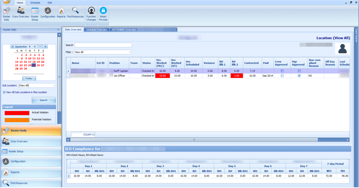

Daily Overview
Figure 4-1 Daily Overview in Time Approval Method
Table 4-1 Field Definition of Daily Overview Tab
| Field Name | Definitions |
Name |
Crew’s name |
Ext ID |
Crew identification number linked to an external system |
Position |
Crew Operational Position |
Team |
Crew’s assigned team |
Status |
Embarkation Status |
Hrs Worked (ILO) |
Actual hours worked. It sums up all worked hours regardless of work codes. The column is highlighted in red for Time Approval mode and the text is in red for Clock-In/Out mode when the total worked hours exceeds the value set in Parameter, “Time Attendance”, “ILO Maximum Work Hours in 24-hour period” |
Hrs Worked (OT) |
Actual hours worked. It sums up all work codes flagged with “Include into Working Hours”. The total hours worked is used to calculate the Overtime against the contracted hours |
Hrs Scheduled |
Hours scheduled by Manager. Sums up all hours regardless of work codes |
Variance |
Differences between Hrs Worked (ILO) input by Crew at Time & Attendance Terminal and Hrs Scheduled by Manager, and only shown in Time Approval mode |
RH Blk1 |
Scheduled largest rest hours block |
RH Blk2 |
The second largest rest hours block in Time Approval mode |
Contracted |
Contracted hours prior to overtime calculation in Time Approval mode |
Paid |
An indicator of whether worked hours is paid in Payroll in Time Approval mode |
Crew Approved |
Schedule approved by Crew at T&A Terminal |
Mgr Approved |
Schedule approved by Manager |
Non-Compliant Reason |
Non-compliant schedule reason approves by Manager |
Off Day Reason |
Reason entered by the crew at T&A Terminal when approving zero hours worked or when Manager approves crew zero hours scheduled |
Last Scheduled |
Date of last scheduled in Time Approval mode |

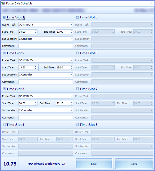

Select the date from the Calendar Editor, in Roster Daily.
Go to the Daily Overview tab and double-click the crew name to open the Roster Daily Schedule window.
Figure 4-2 Roster Daily Schedule

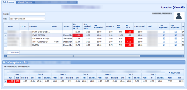

ILO Compliance
Figure 4-3 ILO Compliance in Daily Overview
At the ILO Compliance section, the system automatically sets the columns in red when daily worked/rest hours violates the ILO Regulation. The hours shown in Worked Hours (WH) and Rest Hours (RH) are the accumulated daily worked/rest hour.
Selecting a crew will display the total WH and RH for seven-day period in the ILO Compliance section.
Modifying Roster Daily Schedule
The system allow you to modify a roster schedule created from the template by removing or adding new time slots. You are not allowed to modify or delete the schedule if the Roster has been paid through payroll. This function is only accessible by users that are granted with access rights “#3292 – Allow to Create & Modify Roster Schedule”.
At the Roster Daily Schedule window, select the time slot checkbox and enter the roster task, start/end time, and the sub location and click the Save button. See Figure 4-2.

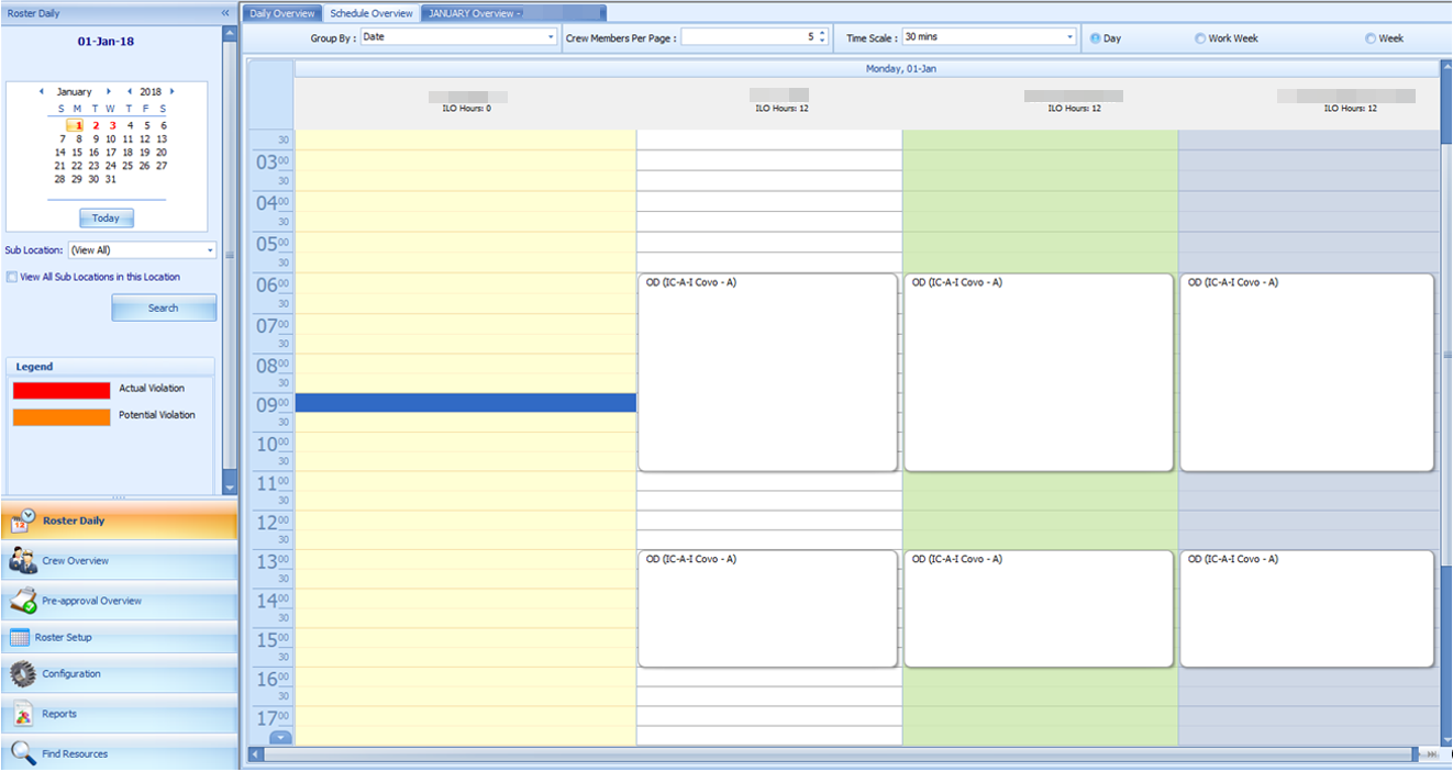

Schedule Overview
The Schedule Overview displays the crew schedules in a graph view, based on the following options and as shown in below figures.
Figure 4-4 Schedule Overview by Date
Figure 4-5 Schedule Overview by Crew Members
Date: Displays schedule by date
Crew Member: Displays schedule by Crew Member
Displays schedule with the number of members defined
Day View: Displays schedule by day
Work Week: Displays schedule by the work week
Week: Displays schedule by week
Month: Displays schedule by month
Displays the hour in 15 or 30 minutes block
Creating a Roster Schedule in Schedule Overview
A schedule can be added into the Schedule Overview tab using the drag and drop option or from a context menu.
Adding Schedule Using Context Menu
At the crew name, select the time slot from the grid.
Right-click to open the context menu.
Select the task to add the schedule. This creates the bar graph in the Overview tab.
Adding Schedule Using Time Slot
At the hour grid of the crew, double-click to open the Time Slot window.
Select the Roster Task, Sub-Location from the drop-down list and insert a comment, if any.
Select the Start and End Time for the task.
Click OK to save. The system prompts:
An ILO Violation if the schedule hours is more than the allowed ILO hours per day
An Overlapping of Time Slots warning if the schedule is overlapping with others

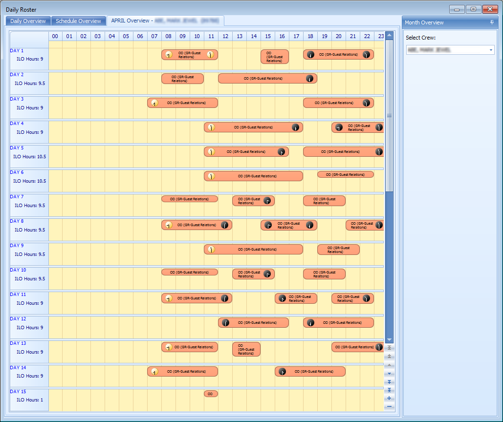

Monthly Overview
The Monthly Overview window provides an overview of the crew monthly schedule.
Figure 4-6 Monthly Overview
From the Roster Daily, Calendar Editor, select the month to view.
At the Daily Overview tab, select a crew and then navigate to the Monthly Overview tab to view the selected crew monthly schedule.
To view another crew for the same month, select the name from the drop-down list. You can only select one crew at any given time.
In the Monthly Overview tab, the same function as the Schedule Overview applies where you are allowed to add, modify, remove or paste a roster schedule.
If the Parameter “Time Attendance”, “Use Clock-In/ Clock-Out” is enabled, the View Clock-In/Out menu button and Show Actual Hours checkbox will be available.
Select the Show Actual Hours checkbox will show the crew actual clock-in/ clock-out hours on the grid. The actual hours is displayed in grey color for each time slot.

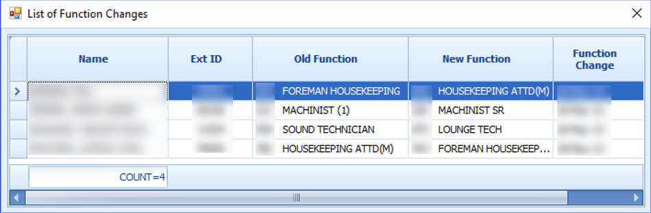

Function Change
The Function Change feature is an information window that lists all the position change and the date it was changed. The fields are not editable.
Figure 4-8 List of Function Change

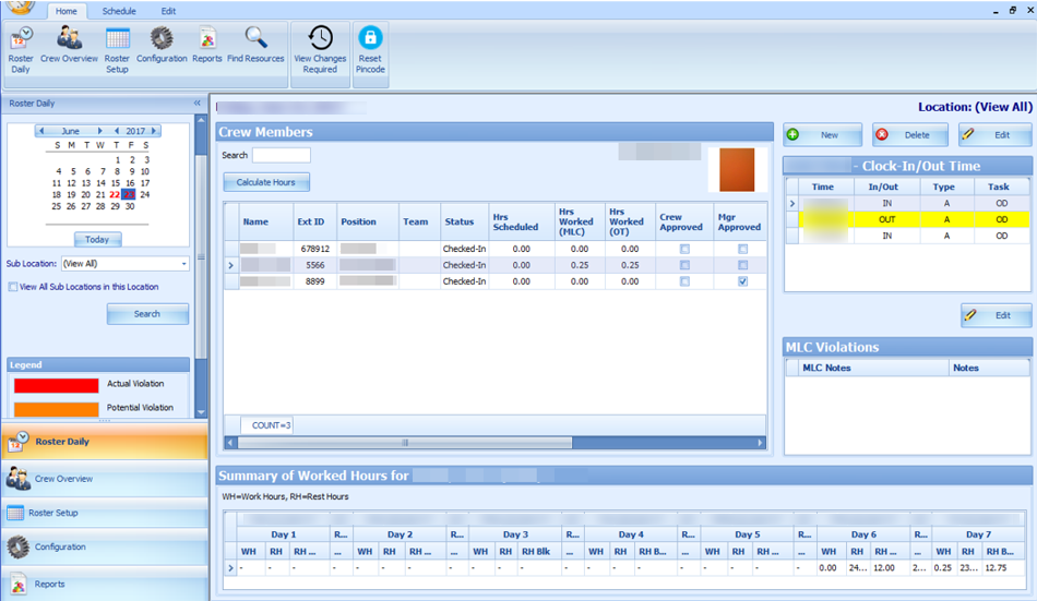

Clock-In/Clock-Out
This feature tracks the Crew Work Hours according to the ILO requirements. The function requires crew members to clock in/out at the start and end of their shift or when they are off for a break.

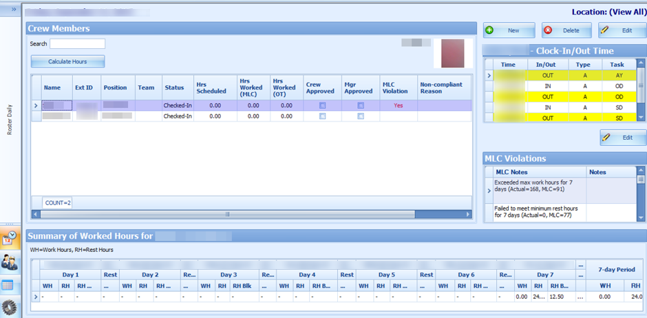

Daily Overview
Figure 4-9 Clock In/Out Daily Overview
Calendar: Dates marked in red denotes dates with roster schedules created
Overview Tab: Lists all crew members that has schedule on the selected date
Clock-In/Out Time: Clock-In/Out time recorded by the system
ILO Violations: Violations of work hours if any. Refer to the Legend indicators for type of violations
Summary of Worked Hours: A weekly summary of hours worked or rested
Viewing of Crew Schedule
Select the date using the Calendar editor and the Sub-Location from the drop-down list.
Click Search to refresh the window.
At the Crew Member section, a list of crew matching the search criterion is shown.
Select a crew name and click Calculate Hours to refresh the information shown.
At the Clock-In/Out Time section, the time logged for each task is shown.
In the Summary Worked Hours section, the past week hours worked/rested is shown.
If the crew work hours violates the ILO Compliance, a note is added to ILO Violations section.
See Table 4-1 description in Time Approval Method section.

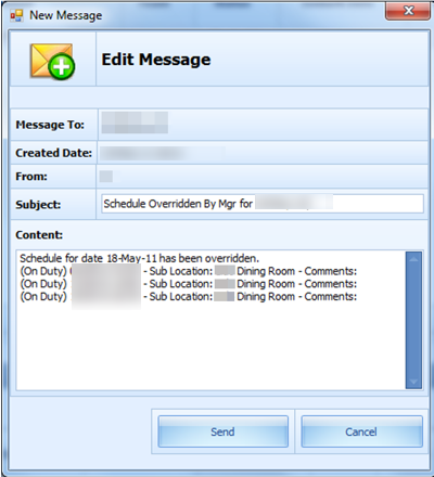

The system generates a notification message informing the crew of the schedule approval/unapproval
If the schedule is approved by the crew and changed by the manager, the crew is notified with a system generated message, indicating the reason for the change
Figure 4-11 Schedule Change Notification
When the manager approves a schedule that are yet approved by the crew, the system generates a warning message, notifying the crew of the change

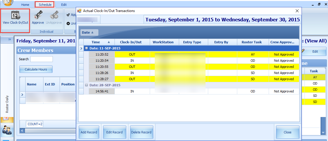

Editing Clock-In/Clock-Out Time
Figure 4-12 Clock-In/Clock-Out Transactions
Go to the Schedule tab and click the View Clock-In/Out button at the ribbon bar.
At the Actual Clock-In/Out Transactions window, select a record to edit.
Click the Edit Record button and alter the necessary details, and click Save.
You can also click Add Record to insert a new clock-in/out record. The "Entered by" column is empty if the record is added/edited by the crew. Otherwise it will display the user name.
Clicking the Delete Record prompts a confirmation window. Click Yes to proceed or No to return to previous window.
To manually add a record, see Manual Clock-In/Clock-Out.

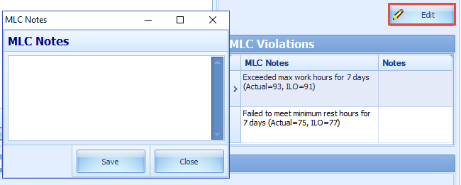

Editing ILO Violations
The edit function in ILO Violations enables the manager to view and input/edit the MLC notes.
To edit, click the Edit button and enter an MLC Notes in the MLC Notes window and click Save to update.
Figure 4-13 ILO Violations

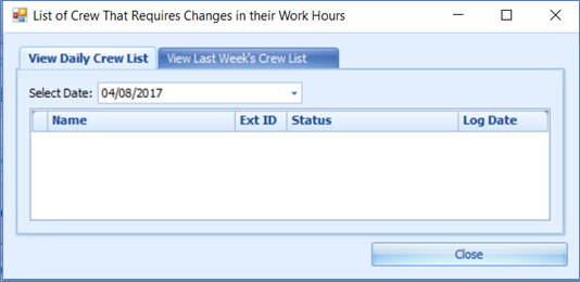

View Changes Required
Figure 4-14 Crew List Requesting Work Hour Change
The View Changes Required function lists all changes requested by crew through the Time and Attendance Terminal and function is only accessible by the manager. A change request is generated when the crew presses the Changes Required during Clock-In/Out at the Time and Attendance Terminal, and crew member are to discuss the change with their respective manager. It displays the daily/weekly or both daily/weekly request depending on the value defined in Parameter Approved Weekly Hours and/or Parameter Approve Daily Worked Hours Clock-In/Out.
To access this function, click the View Changes Required button at the ribbon bar. The information displayed on this window is a view only. See Editing Clock-In/Clock-Out Time or Manual Clock-In/Clock-Out section on how to change the information.
You can manually enter a clock in/out in the In Clock In/Out mode. To access this function, go to Roster Daily, Crew Members screen, Location (View All) section.
Click New at the Location (View All) section.
At the Add Record window, select the Time, Clock-In/Out and Roster Task from the drop-down list, and click Save. The manually added Clock-In/Out time are classified as “M” type.
The system prompts a warning message when a manual clock-in/out is entered. The warning message defers, depending on the previous activity log. The system does not prevent an entry from being inserted or overrides the previous entry. We strongly recommend that you read the warning prompt before click the OK button.
