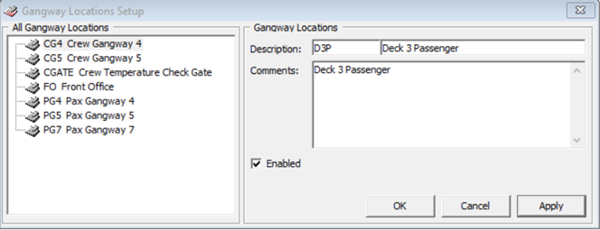

The Ship operator is responsible in preparing a list of the gangway locations on-board and the location of the workstations set up to run the WPF Security. Setting up multiple workstations in different locations are permissible, for example, a workstation to manage passengers and another for crew at the same deck location, and all the configurations are coded in Administration module.
Gangway Location
Figure 1-1 Gangway Location Setup
Login to Administration module and select Safety Setup, Gangway Locations from the menu.
On the All Gangway Locations pane, right-click and select Add New.
At the Description field, enter the gangway location code and name, and additional comments of the location if any.
The new code is Enabled by default. To disable, deselect the Enabled checkbox.
Click Apply to save the new record.
