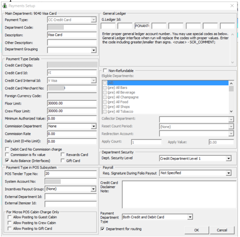

A debit and credit department code for each credit card type accepted by the ship must be configured for charging and posting to take place.
Credit/Debit Card Department Code Setup
  1. Log in to the Aministration module and select Financial Setup, Department Setup from the drop-down list.
  2. Click New to create a Sub-Department code.
    Figure 2-1 Department Code Setup
    This figure shows the Department Code Setup
  3. Under the Main Department section, enter the credit/debit card information such as payment type, department code, and description.
  4. In the Payment Type Details section,
    1. Enter the first two digits of the first set of the credit card number in Credit Card digit.
    2. Enter the Credit Card ID, for example MC — MasterCard, VI — Visa, and others.
    3. Select the corresponding Credit Card Internal ID from the drop-down box.
    4. Enter the Credit Card Merchant Numberprovided by the service provider.
    5. Set the Minimum Authorized Value to 0.
    6. Select the Commission department from the drop-down list and update the commission rate in percentage.
    7. Select the Debit Card No Commission chargecheckbox if a commission is not applicable to the debit card.
  5. In the Department Security access, select the appropriate security level from the drop-down box.
  6. Select the Payment Type under the Payment Department Type, either Both Credit and Debit card, Credit card or Debit card.
  7. Click OK to save.

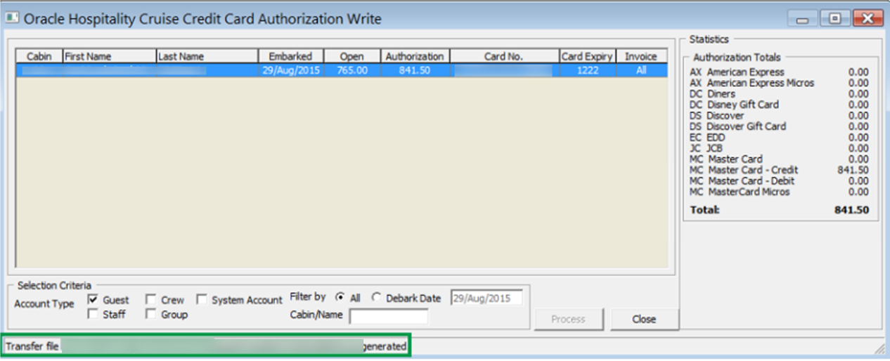

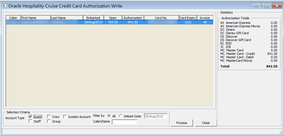

  2. In the Cruise Credit Card Authorization Write screen, a list of credit cards requiring incremental authorization appear in the grid. Use the Selection Criteria to filter the desired information.
    Figure 2-7 New Authorization Screen
    This figure shows the New Authorization Screen
  3. Click the Process button to generate the Authorization file. After the file generation completes, the location of the saved file is indicated on the screen.

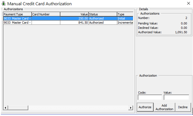

  4. In the Management module, Guest Handling function, select the guest account and navigate to the Credit Card tab. Click View Authorization to open the Authorization screen. The status of the transaction pending authorization is reflected as: Outstanding.
Figure 2-9 Management — Authorization Screen Manual
This figure shows the Management — Authorization Screen Manual

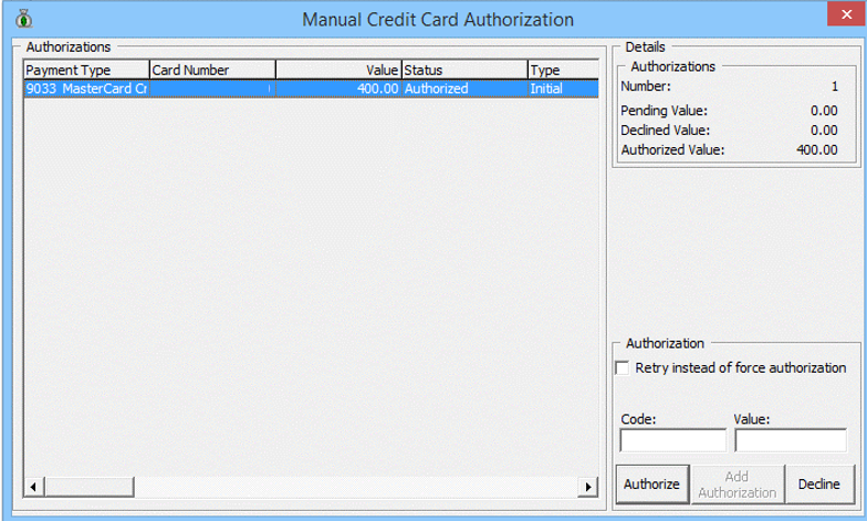

Obtaining Manual Authorization
A manual authorization is available on an ad hoc basis and is performed within the guest account.
  1. In the Management module, Guest Handling function, select the guest account.
  2. Navigate to the Credit Card tab and click View Authorization.
  3. In the Authorization screen, select Add Authorization.
  4. Enter the value and the authorization code in the Credit Card Authorization screen when prompted, and click OK to save. This sets the status to ‘Authorized’ in the Manual Authorization screen.
    Figure 2-11 Management — Add Authorization Screen — Credit Card Authorization
    This figure shows the Management — Add Authorization Screen — Credit Card Authorization
  5. The Authorized code and value is shown at Authorization section when selecting the manual authorized transaction.

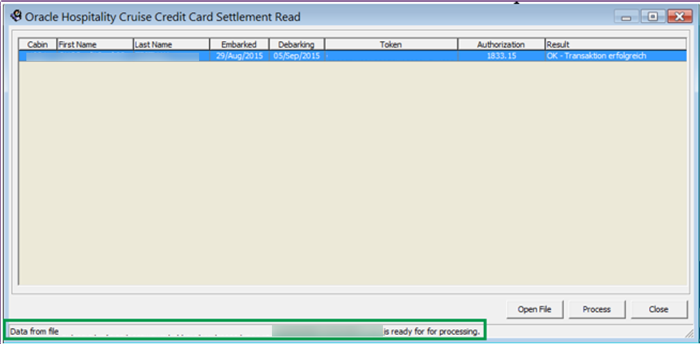

Reading Settlement File
After the Merchant or Service Provider returns a Response File, you must upload the file and update the Settlement transactions status.
  1. From the Settlement drop-down menu, select Read Settlement File.
  2. On the Cruise Credit Card Settlement Read screen, click the Open File button and locate the Settlement Response file.
  3. The status of the process is on the Settlement Read screen. Click the Process button to read and update the Settlement record.
