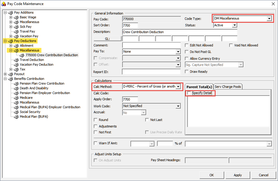

Pay Deductions
A pay deduction code is required for crew contributions to a pension or medical plan under the Pay Deductions code, and this pay code will reflect on the crew pay sheet.
The new pay deduction codes are added as a sub-code of a Pay Deductions – Miscellaneous code type. For the setup of the pay codes, see chapter Creating a Code Type.
When creating the pay codes, you must ensure the following is correctly set up in each of the categories:
Setting up Crew Contribution Deductions - Miscellaneous and Medical Plan
Figure 4-1 Benefit Pay code Maintenance
The figure shows the Pay Code Maintenance window where you can define Benefits.
  • Unique Pay Code ID.
  • Code Type = DM Miscellaneous.
  • Pay Code Description. For example, Medical Plan or Crew Contribution Deduction.
  • Sort Order. This can be the same as Pay Code ID.
  • Calculation Method = D-PERC Percent of Gross (or another amount).
  • Apply Order. This can be the same as Pay Code ID.
  • Check the Do Not Post GL if you do not wish to show the pay code in the GL file.
WARNING:
Once the D-PERC Percent of Gross (or another amount) calculation method is selected, the Specify Detail check box becomes visible. You must select the Pension Plan or Medical Plan BUPA pay codes in Benefit Contribution – Crew Pension Plan Contribution in order to get the 100 percent offset value of the specified pay code.

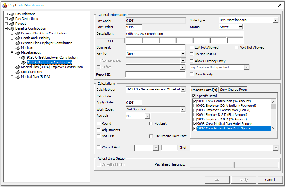

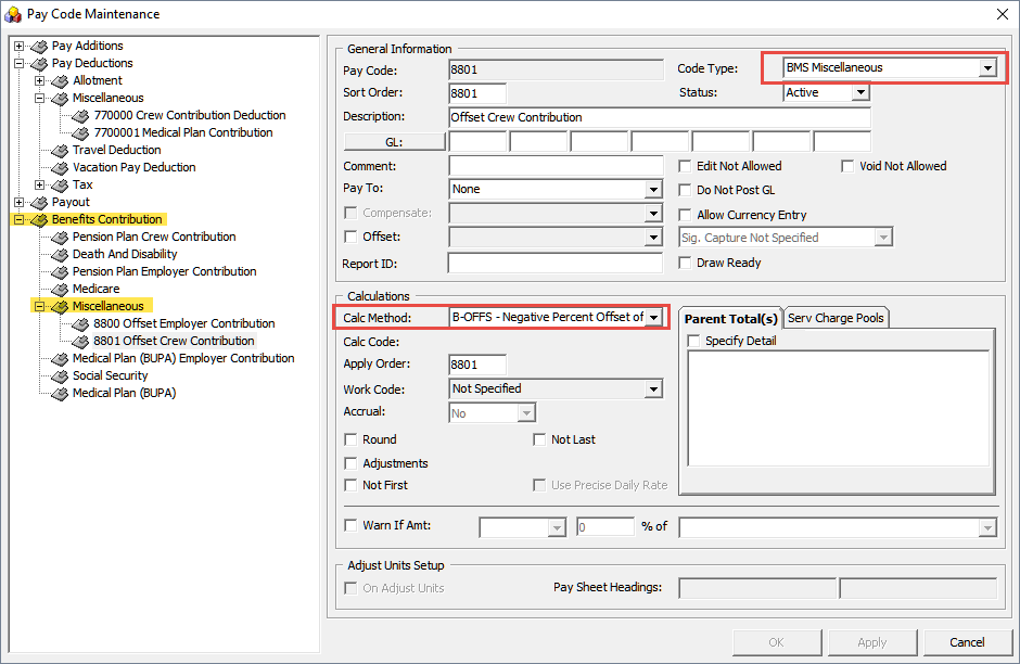

Offset Benefits Contributions - Miscellaneous
The Offset Crew Contribution or Offset Employer Contribution pay code is used to automatically balance the benefit postings during payroll paid outs at the end of the month. You may create more than one offset pay code and assign it to a different benefits contribution pay code.
The Offset Crew Contribution pay is added as a sub entry in Benefit Contribution – Miscellaneous.
Setting up Offset Miscellaneous Contributions – Crew/Employer Contribution
Figure 4-2 Miscellaneous Contribution Pay Code Maintenance
The figure shows the Pay Code Maintenance window where you can use the process Miscellaneous Benefits Contribution.
  • Code Type = BMS Miscellaneous.
  • Pay Code Description. For example, Offset Crew Contribution Deduction or Offset Employer Contribution.
  • Calculation Method = B-OFFS Negative Percent Offset of Another Amount.
WARNING:
Once the B-OFFS Negative Percent Offset of Another Amount calculation method is selected, the Specify Detail check box becomes visible. You must select all the relevant Crew Contribution pay codes if those pay codes in Payroll Benefit Administration (Pension Plan, Crew Medical Plan Contribution, Employer Contribution, Death and Disability Contribution, Medical Plan (BUPA) ) are assigned to offset this pay code. This is to obtain a 100 percent offset value of the specified pay code.

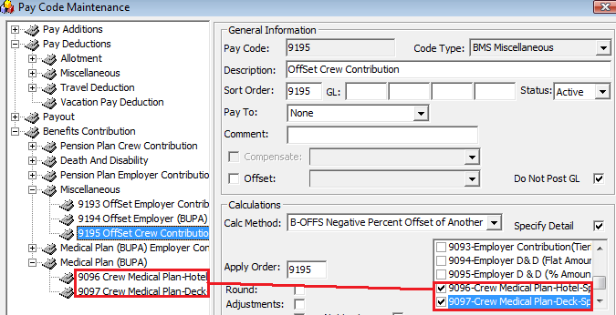

Linking Contribution Pay Codes to Pay Deductions
Once the pay codes are set up, you must link them in the Pay Deductions codes.
Figure 4-5 Pay Code Maintenance form
The figure shows the Pay code Maintenance form where you can link Contribution Pay Codes to Pay Deductions.
  1. Navigate back to the Pay Deductions – Miscellaneous, Crew Contribution Deductions.
  2. Select the Specify Detail check box and select both Contribution Codes.
  3. Click Apply to save.
  4. If the Pension Plan Crew Contribution pay code is assigned to an offset pay code, navigate back to Benefit Contribution – Miscellaneous, Offset Crew Contribution.
  5. Check if they are linked.
Figure 4-6 Offset Crew Contribution
The figure shows the Pay Code Maintenance window where you can use the process Offset Crew Contribution.

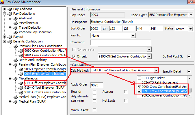

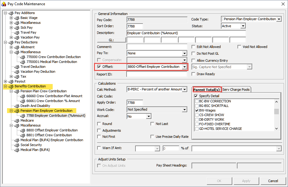

Employer Contribution by Percentage
Figure 4-7 Benefits Contribution for Pension Plan
The figure shows the Pay Code Maintenance window where you can use the process Pension Plan Employer Contribution .
This pay code is added as a sub entry in Pension Plan Employer Contribution and must contain the following:
  • Code Type = BEC Pension Plan Employer Contribution.
  • Pay Code Description. For example, Employer Contribution (%Amount).
  • GL Code where the employer contribution expenses are credited.
  • Select the Offset pay code if you choose to offset the employer contribution in the pay sheet. The offset pay code refers to Offset Employer Contribution. See Offset Benefits Contribution - Miscellaneous.
  • Check the Do Not Post GL if you do not wish to show the pay code in GL file.
  • Calculation Method = B-PERC – Percent of another Amount.
  • On the Specify Detail page, select the applicable monthly earning pay code. The percentage of Employer Contribution to compensate is based on the selected pay code such as basic wage. The system calculates the employer contribution amount against the crew’s monthly salary.

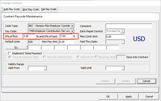

Employer Contribution by Tier Level
The following contribution code is for an employer that contributes using the Tier Level calculation method (100 percent of the first 3 percent and 50 percent of the next 7 percent) of the crew’s contribution on applicable month earnings.
The Calculation Method is B-TIER – Tiered Percent of another Amount. Select the Offset pay code if you choose to offset the employer contribution in the pay sheet.

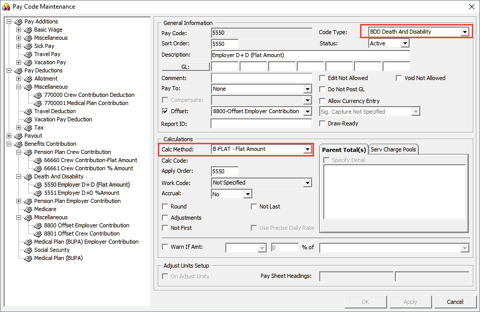

Death and Disability Contributions
Apart from the Pension Plan, you can contribute to the Death and Disability plan. For this, you need to create two separate codes for the calculation method.
  • Death and Disability (Flat Amount)
  • Death and Disability (% Amount)
Set up the code just as you would for the other codes.
Figure 4-9 Death and Disability Contributions
The figure shows the Pay Code Maintenance window where you can use the process Death and Disability Contributions.
  • Code Type = BDD Death And Disability
  • Pay Code Description. For example, Employer D + D (Flat Amount).
  • Check the Do Not Post GL check box if you do not wish to show the pay code in the GL file.
  • Calculation Method = B-FLAT Flat Amount.
For contribution by Percentage, select:
  • Calculation Method = B-PERC Percent of Amount
Once the Benefit Contribution pay codes have been set up and if the pay code is assigned to an Offset Employer Contribution, navigate back to the Offset pay code and link all the Benefit Contribution codes in the Specify Detail window.

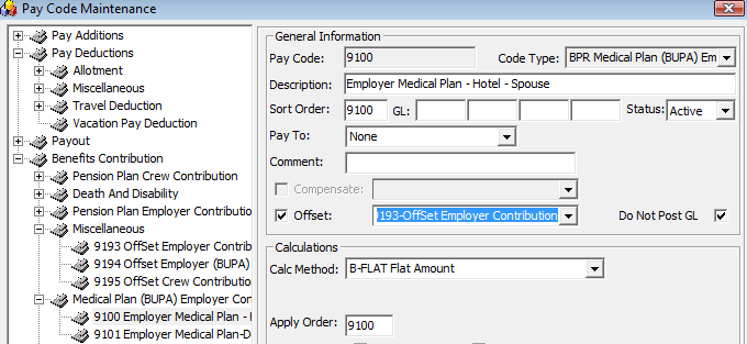

Medical Plan Contribution (BUPA)
The Medical Plan Contribution (BUPA) comprises two contributions: Employer and Employee. An employer is obligated to contribute to the employee Medical Plan. The employee may also choose to contribute for their dependent’s medical plan through deductions from their monthly earnings.

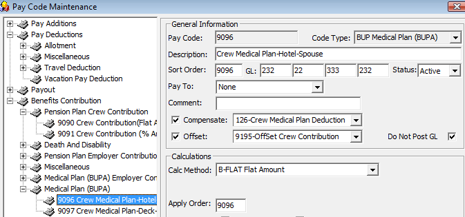

Crew Medical Plan Contribution – Hotel Department – Spouse
The Crew Medical Plan contribution is segmented into two categories – Hotel and Deck and Engine. There are eight pay codes for the Medical plan and all contribution amounts are set as flat amount.
  • Crew Medical Plan Contribution – Hotel Department – Spouse
  • Crew Medical Plan Contribution – Hotel Department – Spouse and children 21 and under.
  • Crew Medical Plan Contribution – Hotel Department – Single and children 21 and under
  • Crew Medical Plan Contribution – Hotel Department –children 21 and older
  • Crew Medical Plan Contribution – Deck & Engine Department – Spouse
  • Crew Medical Plan Contribution – Deck & Engine – Spouse and children 21 and under
  • Crew Medical Plan Contribution – Deck & Engine – Single and children 21 and under
  • Crew Medical Plan Contribution – Deck & Engine – children 21 and older
The following pay code is setup for the hotel department crew dependent’s contribution, as an example and is added to the Medical Plan category. You must create the pay code per the above list, and link them to the Crew Contribution and Offset Crew Contribution code.
  • Code Type = BUP Medical Plan (BUPA).
  • Pay Code Description. For example, Crew Medical Plan-Hotel-Spouse.
  • Compensate Pay code must be a Crew Contribution Deduction. This refers to a Pay Deduction. See Pay Deductions.
  • Select the Offset pay code if you choose to offset the employer contribution in the pay sheet. The offset pay code refers to the Offset Crew Contribution. See Offset Benefits Contribution - Miscellaneous.
Figure 4-10 Medical Plan Pay Code Maintenance
The figure shows the Pay Code Maintenance window where you can use the process Crew Medical Plan.

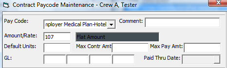

Employer Medical Plan Contribution
The Medical Plan (BUPA) Employer Contribution is the benefit contribution portion of the employer to the employee. Similarly, they are segmented to two pay codes and use the same calculation method:
  • Medical Plan Employer – Hotel Department
  • Medical Plan Employer – Deck & Engine Department
Figure 4-12 Employer Medical Plan Contribution
The figure shows the Pay Code Maintenance window where you can use the process Employer Medical Plan Contribution.
  • Pay Code Description. For example, Employee Medical Plan-Hotel-Spouse.
  • Select the Offset pay code if you choose to offset the employer contribution in the pay sheet. The offset pay code refers to Offset Employer Contribution. You may create a new Offset pay code to separate the offset value, if preferred. See Offset Benefits Contribution - Miscellaneous.
  • Select the Do Not Post GL check box if you do not wish to show the pay code in GL file.
If the pay code is assigned to an Offset Employer Contribution pay code:
  1. Navigate back to the Benefit Contribution, Miscellaneous, Offset Employer Contribution section.
  2. Check the Specify Detail check box and select the corresponding Employer Medical Plan Contribution pay codes.

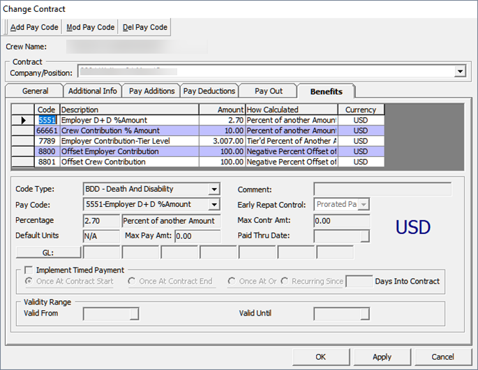

Example 2: Pension Plan with Percentage Amount
In the following example, a crew member contributes 10 percent of total consolidated wages of $1500 to the Pension Plan. The employer will match 100 percent of the first 3 percent of the crew contribution and another 50 percent of the next 7 percent, based on his applicable monthly earning. The employer also contributes 2.7 percent of the crew member’s applicable monthly earnings towards the Death and Disability Plan. The crew contract would consist of these pay codes in their contract.
Figure 4-15 Pension Plan with Percentage Amount
The figure shows the Change Contract window where you can define a Pension Plan with Percentage Amount.
The following tabs would contain the information below.
  • Pay Additions: A Basic Wage of $1500
  • Benefits:
    • A Crew Contribution by Percentage % Amount of 10 percent.
    • A Employer Contribution by Percentage of 3 percent and 7 percent.
    • A Death and Disability Contributions by (%Amount) at 2.7 percent.
For Employer Tier Level contribution, it will have the 3 percent value in the first field, followed by 7 percent in the next field.
Figure 4-16 Employer Pension Plan Tier Level
The figure shows the Change Contract window where you can define a Tier Level for a Pension Plan.
The default 100 percent for the Tier Level functionality is flexible and able to change from the parameter Payroll, Tier 1 Percentage and the remaining 50 percent is defined in Payroll, Tier 2 Percentage.

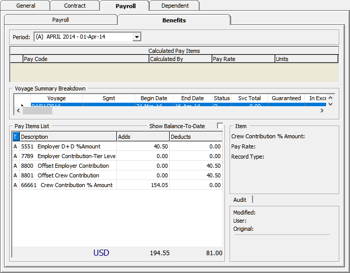

Figure 4-17 Payroll Tier
The figure shows the Payroll Tier.
Figure 4-18 Benefits Postings
The figure shows the Benefits Postings.

To add the BUPA Health Coverage, navigate to the Benefit tab of the crew and add the Employer Medical Plan-Hotel pay code.
  • The system will update all the active pay codes into the crew payroll detail. The employer expense of $107 is not visible on the crew pay sheet but is stored and reported in the General Ledger Month End file.
  • You can view the Employer Medical Plan Contribution from Crew Payroll Detail, Payroll, Benefits tab. The Offset Employer Contribution will show a negative value to offset the benefit posting.
Example 2 – BUPA Health Coverage with Dependents
In this example, the Staff Captain is entitled to a BUPA coverage of $107 contributed by the employer and has chosen dependent coverage for the spouse. The Medical Plan rate given by BUPA for the dependent option is $107.
To add the dependent coverage:
  • Navigate to the Benefit tab of the Crew Payroll Detail form and select Crew Medical Plan-Deck-Spouse, and then enter the amount.
  • Add a pay code for the crew using the Employer Medical Plan-Deck of $107.
Figure 4-21 Health Coverage with Dependents 1
The figure shows the Contract Pay code Maintenance form where you can create Health Coverage with Dependents.
Figure 4-22 Health Coverage with Dependents 2
The system will update the active pay code into the crew payroll detail form. In the Crew Payroll Detail form, the dependent expense of $107 is deducted from the employee and reflected in the pay sheet by the Pay Code Deduction.
The crew dependent coverage deduction is debited from the crew member’s payroll and is shown under the Crew Payroll Detail, Payroll, Payroll tab.

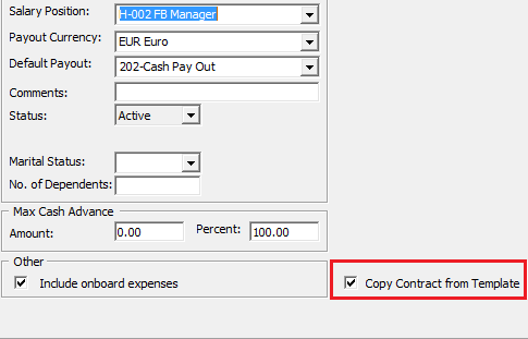

Contract Templates with Pension Plan and Medical Plan
You can add all the benefit pay codes using the Contract Templates under Contract Template setup.
To add the pay code in the Contract Template:
  1. Select the Salary Position and click Add Pay Code.
  2. Select the benefit pay code and enter the percentage rate or flat amount.
  3. When assigning the contract to the crew member, and in order for the system to auto populate all the benefit pay codes, you must select the check Copy Contract from Template.
Figure 4-24 Copy Contract from Template Check Box
The figure shows the Contract Templates window with the Copy Contract from Template check box.

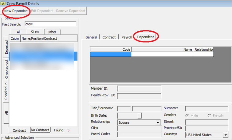

In the Crew member’s Payroll Detail form, a Dependent tab is made available to maintain the dependent’s information.
Figure 4-26 Dependent Information
The figure shows the Crew Payroll Details window with Dependent Information.
To add the dependent information:
  1. Click the New Dependent button on the Crew Payroll Details form.
  2. Each dependent should have a unique BUPA ID associated to the Health Provider. Enter the ID in the Member ID field and Health Prov. ID field, and the mandatory field such as Forename, Surname, Member ID, Birthday, and Relationship Type.
  3. Click Insert to save.
  4. You can add, edit, or remove the dependent information where necessary.
