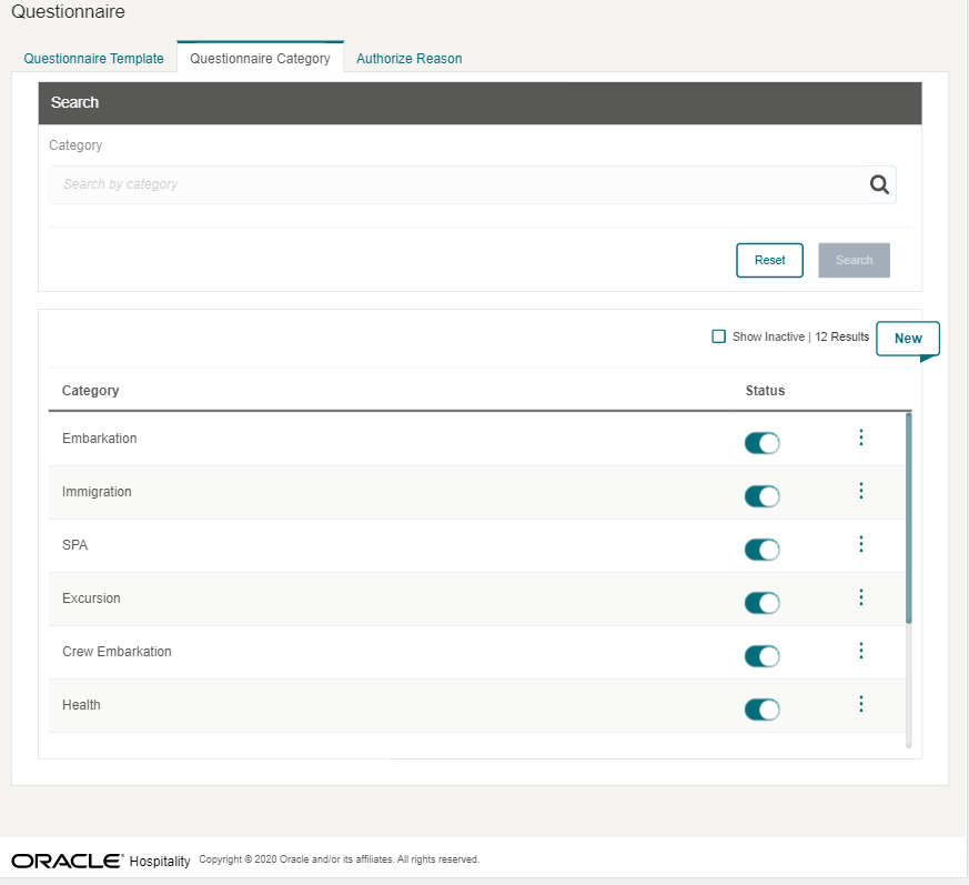

Questionnaire Category
Figure 8-1 Questionnaire Category List
The Questionnaire Category setup allows you to categorize the questionnaire template by group and assign it to a Questionnaire Template. You can either pre-define a category before setting up a questionnaire template or while setting up the template.
Searching for a Questionnaire Category
Navigate to the Questionnaire Category tab. All active questionnaire categories records appear in the results view section.
Enter the category name in the search box and select the Search button. The searched record appears in the results view if the record is found. Otherwise, the system returns a no result prompt.
Select Reset to clear the search box value.
To view an inactive category, select the Show Inactive check box to display all the inactive categories in the results view.
Editing a Questionnaire Category
Figure 8-2 Questionnaire Category Options
On the Questionnaire Category tab, questionnaire category record, select the vertical ellipsis to display the Edit and Delete option.
Select Edit and the system displays the Edit Category page.
You can change the category name and status (active to inactive or vice versa) if the category is not assigned to an active Questionnaire template and has no transaction history. If the category is inactive, the Status button is greyed out.
You can also change the category status from the main screen by sliding the Status button.
Creating a new Questionnaire Category
On the Questionnaire Category tab, click New to open the Create Category page.
Enter a value at the Category field. This is a mandatory field.
Click Save.
Click Cancel to exit the Create Category page without updating and return to the Questionnaire Category listing page.
A duplicate category name is not allowed.Delete a Questionnaire Category
On the Questionnaire Category tab, select the category you want to delete.
Click the vertical ellipsis and select Delete.
The system displays a confirmation message, “Are you sure you want to delete this record?” Click Delete to remove the category from the Questionnaire Category list. If you select Cancel, the selected category will remain.
If the Category you are deleting is in use, the system displays a message, “Delete cannot be performed. Already have transaction history.”

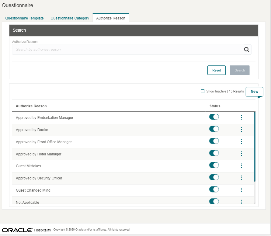

Authorize Reason
Figure 8-3 Authorize Reason
The Authorize Reason setup allows you to create overriding reasons to use in the Questionnaire to answer the questions that trigger alerts.
Searching for an Authorize Reason
Navigate to the Authorize Reason tab to display all active records in the results view section.
In the search box, enter a keyword for the authorization reason and select the Search button. If a matching record is found, the system displays the search record in the results view. Otherwise, you are prompted with a “no record found” message.
Select the Show Inactive check box to display all inactive reasons in the results view.
Editing an Authorize Reason
Navigate to the Authorize Reason tab to display all the active authorize reason records in the results view section.
Select an authorize reason record, select the vertical ellipsis button, and then select Edit.
In the Edit Authorize Reason page, change the authorize reason name and select Save. You can change the authorize reason name that has no transaction history, otherwise, the system displays an error message.
You can change the authorize reason status from active to inactive or vice versa.
Also, you can enable/disable the authorize reason status from the main screen by sliding the Status indicator or select the vertical ellipsis for more options.
Creating a New Authorize Reason
On the Authorize Reason tab, select New to open the Create Authorize Reason page.
Enter the value at the Authorize Reason field. This field is mandatory.
Click Save.
A duplicate authorize reason name is not allowed. -
Click Cancel to exit without updating and return to the Authorize Reason listing page.
Deleting an Authorize Reason
At the Authorize Reason tab, select the category to delete.
Click the vertical ellipsis followed by Delete.
The system displays the confirmation message “Are you sure you want to delete this record?”. Click Delete to proceed or click Cancel to return to the previous page.
If the authorize reason is in use, the system displays a message “Delete cannot be performed. Already have transaction history.”

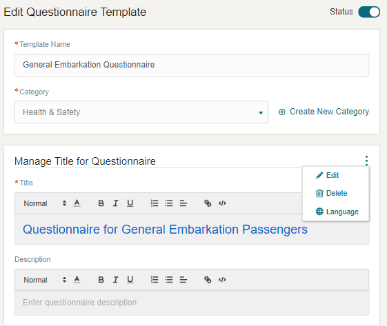

Editing a Questionnaire Template
Navigate to the Questionnaire Template tab to display all the active questionnaire template records in the results view section.
On the questionnaire template record, click the vertical ellipses button and then click Edit.
On the Edit Questionnaire Template screen, you can change the questionnaire template content and status from active to inactive or vice versa, if the template is not in use or has and no transaction history.

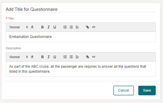

Add Title for Questionnaire (optional)
Figure 8-5 Questionnaire Title
This configuration section allows you to define the questionnaire title and description for the questionnaire template, and is optional.
There are two sections within the Add Title for Questionnaire.
Title: Title of the questionnaire template, which is a mandatory field.
Description: A brief explanation of the questionnaire template that is optional.

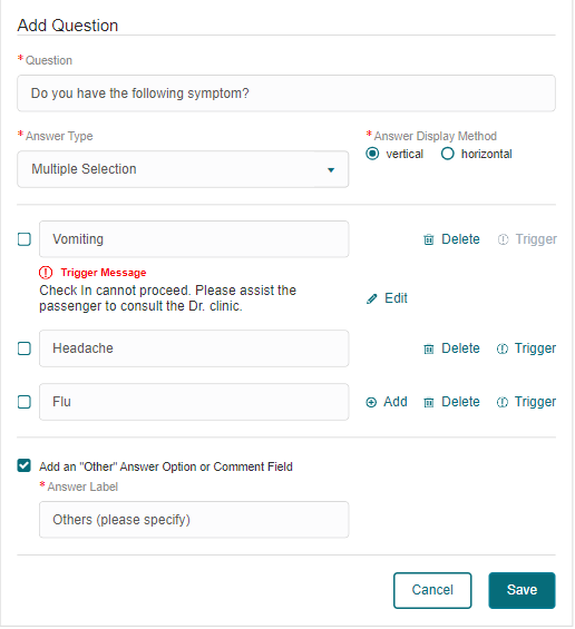

Add Question
Figure 8-6 Questionnaire Add Question with trigger
The Add Question option creates a question without linking it to a question group. The system opens the Add Question section after you select the Add Question option from either the Question Group or directly from the Add Question option.
To add a question, enter all the required information, then click Save or Cancel to exit without saving.
The Save button is disabled if the answer row is empty. You can either delete it or fill in the information.
Question – Field in which to enter the question.
Answer Type – Select the type of answer: single or multiple selection or free text answer.
Answer Display Method – Option to display the answer vertically or horizontally.
The Answer field is where you can specify the available answer to the question.
Delete – Option to delete the answer.
Add – Option to create/add more answer.
Trigger – Option to define the answer will have an answer trigger notification with user definable message.
Add an “Other” Answer Option or Comment Field – Option for answer that requires a free text input. Select the check box to enter the description on the answer label field.
You can also edit, copy, delete, and set a language for the question using the options under the vertical ellipsis.

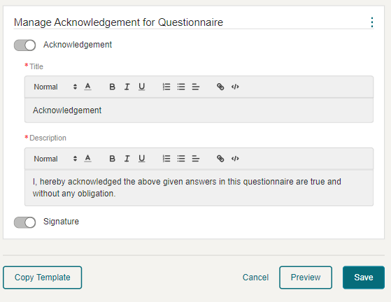

Add Acknowledgement
The Add Acknowledgement section allows you to defines the acknowledgement description or disclaimeras an option.
To enable, slide the Acknowledgment indicator and the signature indicator in the respective section. Proceed to enter the title and description and then select Save.
After saving the template, you can preview the questionnaire by selecting Preview and the language that you want to display.
Figure 8-7 Acknowledgement for Questionnaire

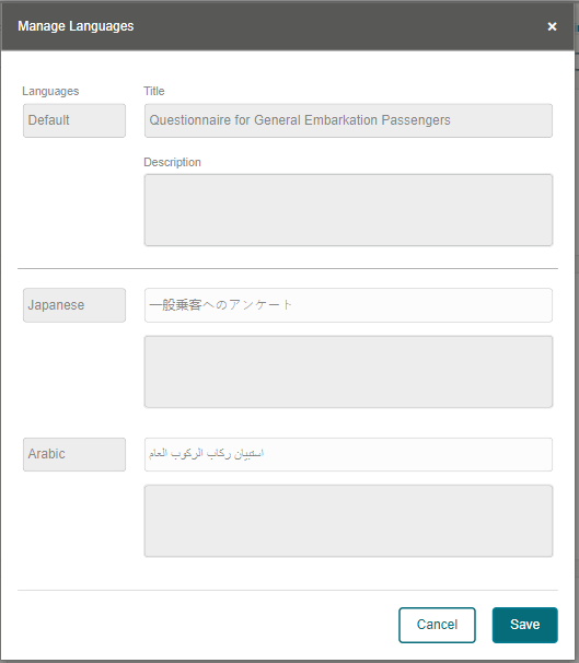

Creating Questionnaire Template with Multiple Languages
This function allows you to create a questionnaire template with multiple languages. Before you set up the questionnaire in multiple languages, you must enable the languages allowed in the questionnaire template.
To enable the languages, see the Language Templatesection.
Add Title and Description
Add Question Group
Add Question
Add Acknowledgement and Description
To configure the template in other languages, follow these steps.
On the Questionnaire Template tab, search for the questionnaire template you want to edit.
Navigate to the vertical ellipsis button and select Edit. This brings up the Edit Questionnaire Template page.
Go to the Title section, select the vertical ellipsis, followed by the Language option. This brings up the Manage Languages page.
On the Manage Languages page, the default language refers to the language used to setup the questionnaire template. You can view templates in other languages if they are enabled in Language Template setup.
Enter text in the text boxes according to the language you selected and then click Save.
After updating all descriptions in other languages, you can view the questionnaire in the languages that you configured using the vertical ellipsis button.
Figure 8-8 Questionnaire in Multi Language
Figure 8-9 Managing Languages
