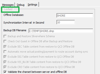

Synchronization Process for DB Using TDE
The synchronization process for a database that uses TDE are lesser from the standard process, and are listed in below table.
Figure 6-1 QCI Synchronization DB Locked
Table 6-2 QCI Synchronization Process for DB Using TDE

Process 13 |
The system disables all parameters in the Settings tab and a dimmed ‘Locked’ is shown on the window when the Offline Mode is ready. |

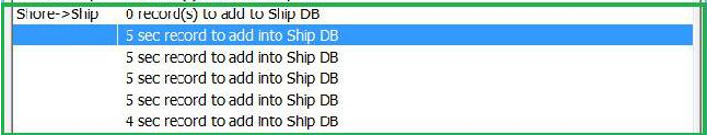

Below are some examples of records that were added from the QCI Shore database to the ship database or vice versa.
The system indicates the number of remaining records to process, update, or skip during synchronization in the Messages tab.
Figure 6-2 Quick Check In Synchronizer
The synchronization processes five pictures data (SEC records) per batch and is only applicable when adding new SEC records from Shore to Ship. Messages shown in the Messages tab are ‘x value Update to Ship DB' when updating of SEC from shore to ship and 'Adding new record to shore' when a new record is added in Ship DB and transferred to shore DB. Any changes made to the SEC table from the ship do not transfer to the Shore Database.
