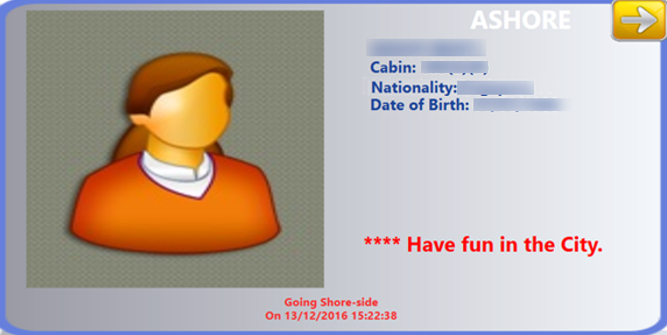

At the Check-out dialogue message, select Yes to check-in the guest. The passenger’s details appears on the Ashore Information board.
Crew Disembarkation Handling
Similar to Auto Check-Out Guest, the function is also available to crew disembarking from the ship. See Parameters section for details.
When disembarking crew swipe their board card through the MSR. The system prompts an Ashore Denied Override dialog box with the following message: ‘The person is ashore denied; do you want to override the onboard status?’. Click Yes to change the account status to Ashore and display a “Crew Disembark Today” statement on the Ashore Status Information board.
