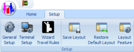

In the Setup tab, you can configure the related parameter and hardware used by the ship. It features General Setup, Terminal Setup, Wizard Travel Rules, Save Layout, Restore Default Layout, and Layout Feature.
Figure 1-1 AQCI Setup Tab

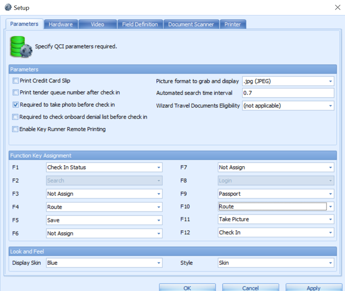

The General Setup section contains all the general settings for use in the Advance Quick Check-In Module (AQCI). The general setting tabs are described below:
Figure 1-2 AQCI General Setup
Parameters
To enable the parameters, at the Function Key Assignment section, assign the function keys according to the ship operator requirements.

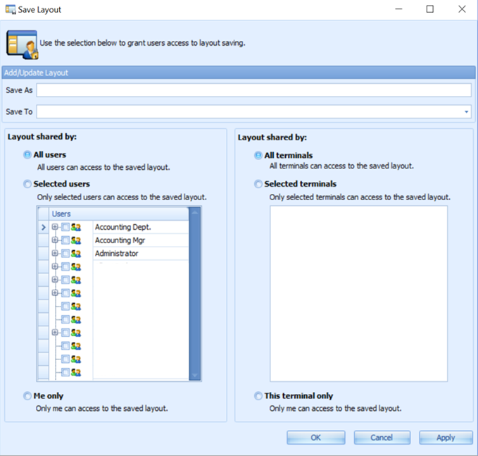

Saving a Layout
The layout selection allows you to save and grant a specific user or terminal to a layout designed to accommodate the check in process at each location.
Figure 1-3 Save Layout
For a new layout, you can select Save As to define the layout name, and click OK to save.
For an existing layout, you can select Save To and update the existing layout from the drop-down list.
You can share the layout using the following options:
All Users: All users can access the saved layout.
Selected Users: Only selected users can access the saved layout.
Me Only: Only the logged in user can access the saved layout.
All Terminals: All terminals can access the saved layout.
Selected Terminals: Only selected terminal can access the saved layout.
This Terminal Only: Only for this particular terminal can access the saved layout.

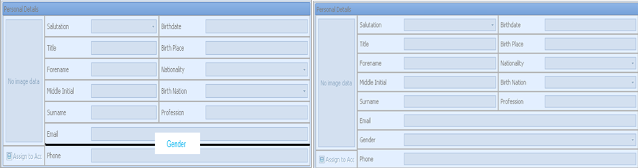

To remove a field from the All Details form, highlight the field until a dotted outline appears around the element.
Figure 1-6 Selected Label
Drag and drop the selected field into the Customization, Hidden Items tab to remove the field from the AQCI Check In form.
Once the layout is finalized, click the X to close the Customization window and return to AQCI Enable mode.
Restoring Field/Group
In order to restore a field or group back to the Detail screen, you must switch the layout mode to Disable.
At the Customization window, Hidden Items tab, highlight a field or a group from the Hidden Items list.
Drag the field or group to the AQCI form and drop the item(s) at the desired location. The new location of the field or group depends on where the splitter line is.
Figure 1-7 Layout Field Splitter

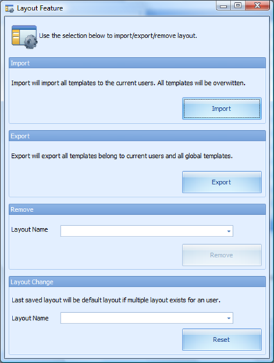

Layout Features
The Layout Feature allows you to Import, Export, and Remove the specific layout required by the users. In Layout Change, the default layout is the last saved layout, if multiple layouts exist for the user.
Figure 1-8 Layout Feature

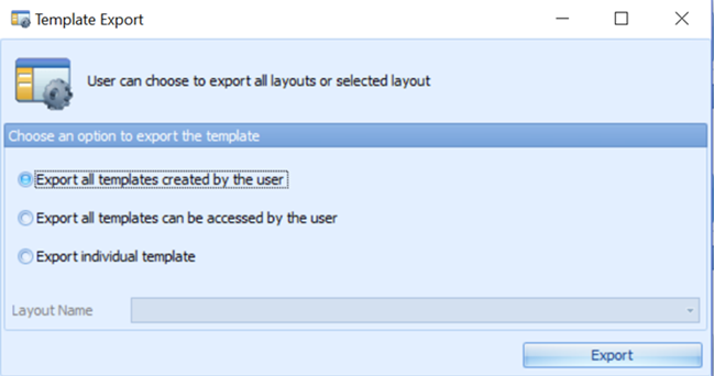

Exporting a Layout
The Export feature allows you to export the saved template and layout to an XML file format for use in the same or different database. In the Template Export screen, you can export the layout based on the following options:
Export all templates created by the user.
This exports the template created by the current logged-in user. For example, Template A is created by user A. Template B is created by user B. When User A logs in to the system, only Template A is being exported.
Export all templates can be accessed by the user.
This exports the template that are shared by the current logged-in user. For example, Template A and Template B are shared by user A. Template C is shared by user B only. When User A logs in to the system. Only Template A and Template B are being exported.
Exporting a Template
From the Layout Feature window, click Export. This opens the Template Export window.
Select the export option by selecting the radio button. If Export individual template is chosen, select the template from the drop-down list. For example, the template created by the current logged-in user is shown in the following:
Figure 1-9 Template Export
Click Export to proceed and select a location to save the file when prompted.
Click Save to complete the process.
