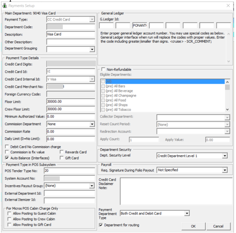

Department Setup
Department Setup
A debit and credit department code for each credit card type accepted by the ship must be configured for charging and posting to take place.
Log in to the Aministration module and select Financial Setup, Department Setup from the drop-down list.
Click New to create a Sub-Department code.
Figure 2-1 Department Code Setup
Under the Main Department section, enter the credit/debit card information such as payment type, department code, and description.
In the Payment Type Details section,
Enter the first two digits of the first set of the credit card number in Credit Card digit.
Enter the Credit Card ID, for example MC — MasterCard, VI — Visa, and others.
Select the corresponding Credit Card Internal ID from the drop-down box.
Enter the Credit Card Merchant Numberprovided by the service provider.
Set the Minimum Authorized Value to 0.
Select the Commission department from the drop-down list and update the commission rate in percentage.
Select the Debit Card No Commission chargecheck box if a commission is not applicable to the debit card.
In the Department Security access, select the appropriate security level from the drop-down box.
Select the Payment Type under the Payment Department Type, either Both Credit and Debit card, Credit card or Debit card.
Click OK to save.

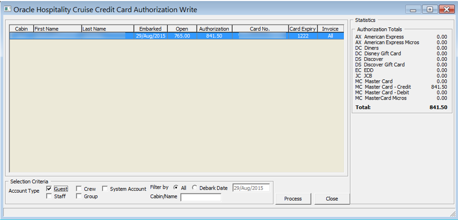

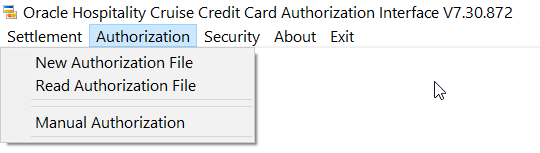

Creating Incremental / Top up Authorization File
Start the Credit Card Transfer Interface, select the Authorization menu, and select the New Authorization File from the drop-down menu.
Figure 2-6 Credit Card Transfer — Authorization Tab

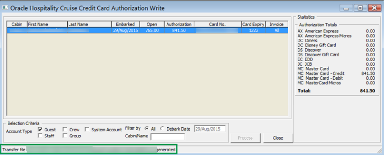

In the Cruise Credit Card Authorization Write screen, a list of credit cards requiring incremental authorization appear in the grid. Use the Selection Criteria to filter the desired information.
Figure 2-7 New Authorization Screen
Click the Process button to generate the Authorization file. After the file generation completes, the location of the saved file is indicated on the screen.
Figure 2-8 Authorization File Location

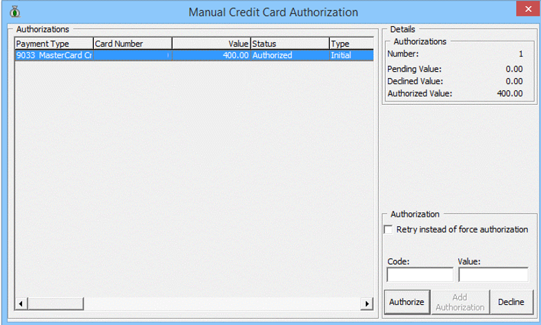

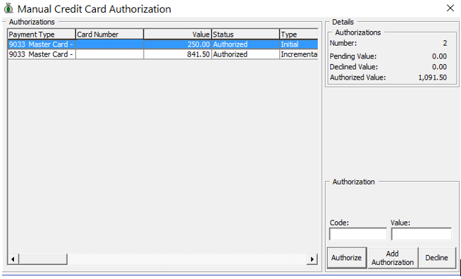

Obtaining Manual Authorization
In the Management module, Guest Handling function, select the guest account.
Navigate to the Credit Card tab and click View Authorization.
In the Authorization screen, select Add Authorization.
Enter the value and the authorization code in the Credit Card Authorization screen when prompted, and click OK to save. This sets the status to ‘Authorized’ in the Manual Authorization screen.
Figure 2-11 Management — Add Authorization Screen — Credit Card Authorization
The Authorized code and value is shown at Authorization section when selecting the manual authorized transaction.
Figure 2-12 Manual Authorization Screen, Forced Status

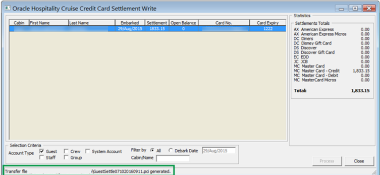

Creating Settlement File
In the Credit Card Transfer Interface program, select from the drop-down menu Settlement, then New Settlement File.
Click the Process button to generate the Settlement File. After the Settlement file is created, the location of the saved file is shown on the screen.
Figure 2-13 Settlement Write Screen

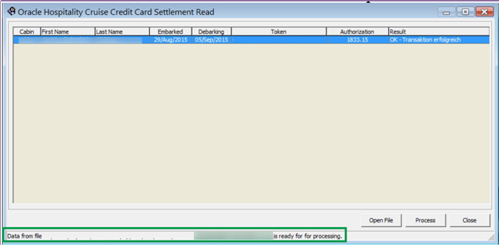

Reading Settlement File
From the Settlement drop-down menu, select Read Settlement File.
On the Cruise Credit Card Settlement Read screen, click the Open File button and locate the Settlement Response file.
The status of the process is on the Settlement Read screen. Click the Process button to read and update the Settlement record.
Figure 2-14 Settlement Read Screen

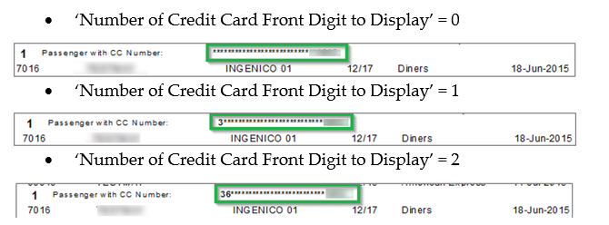

Report
The credit card digits to print on reports depends on the setting defined in the Number of Credit Card Front Digit to Display parameter. This parameter only supports value from 0 - 6.
Below are the examples of the number of front digit to show on the report based on the value defined.
Figure 2-15 Reporting — Number of Front Digit to Appear in Report
