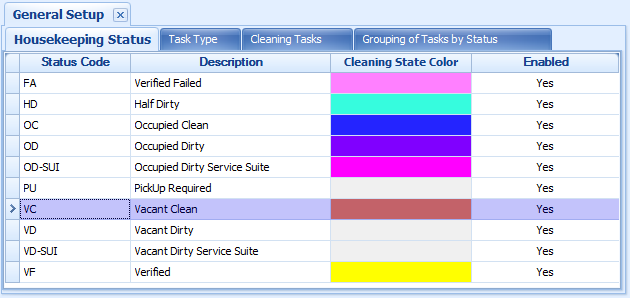

Housekeeping Status
The Housekeeping Status is an indicator of the cabin clean status. Below are the default housekeeping statuses. You can add an additional status depending on the operational requirement using the following steps.
VD: Vacant Dirty
VC: Vacant Clean
OD: Occupied Dirty
OC: Occupied Clean
Figure 2-2 Housekeeping Status Setup
Adding Housekeeping Status

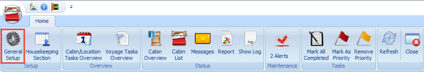

In the Home tab, select General Setup and then select the Housekeeping Status tab.
Select Add from the ribbon bar.
In the New Housekeeping Status window, enter the code, comment, and select a color that represents the status from the color palette.
The newly added code is enabled by default. Deselect the check box to disable the code.
Click Save to save the status.

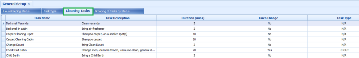

Cleaning Tasks
The Cleaning Tasks is a task code used by management to manage the assignment of duties and chores to the housekeeper.
Figure 2-5 Cleaning Tasks Setup

In General Setup, navigate to the Cleaning Task tab.

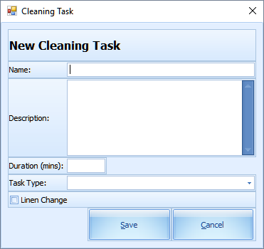

Click the Add button on the ribbon bar to open a New Cleaning Task window.
Figure 2-6 Add Housekeeping Cleaning Task
Enter a task name, a description of the task, and duration involved.
Click the Task Type drop-down menu to select a cleaning task:
Task type C-OUT for Checked Out Cabin. This is used when the cabin requires a linen change on a specified day. The C-OUT status is indicated in the cabin bubble on day of checked out.
Task type N/A for CO-Linen Change. This is used when the cabin requires a linen change on a specific date. The C-OUT status is not indicated in the cabin bubble and such service is usually for cabins that are still occupied by the guest.
Select the Linen Change to generate a task for a linen change.
Click Save to save.

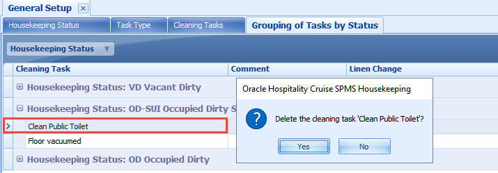

Grouping of Tasks by Status
This feature enables you to group specific tasks by status. The grouped tasks appear in each of the cabin windows in the Cabin Task Overview.
Figure 2-7 Grouping of Tasks by Status Setup

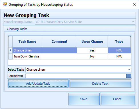

Adding Grouping of Tasks by Status
In General Setup, click the Grouping of Tasks by Status tab.
Click Add on the ribbon bar.
Figure 2-8 Add Housekeeping Grouping of Tasks by Status
In the Grouping of Task by Housekeeping Status window, select the following:
A cleaning status from the Housekeeping Status drop-down list.
A cleaning task from the Select Task drop-down list and enter a comment in the Comments field.
Click the Add/Update Task to insert the cleaning task into the grid.
Repeat step 3 to add more cleaning tasks
Click Save to save the grouping of tasks by status.

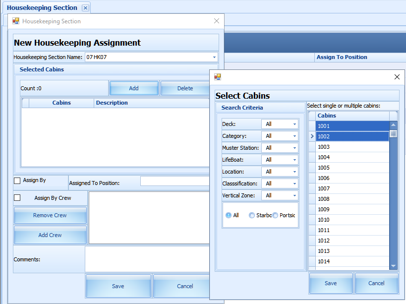

The Housekeeping Section Setup enables you to group a number of cabins or public locations into a Housekeeping section. There are two sections to set up: Cabin and Public Location. The steps to set up the Housekeeping section for both types are identical.
Figure 2-10 Housekeeping Section Setup
Setting up Location
From the Home tab, click Housekeeping Section Setup and navigate to the Cabin tab.
On the menu ribbon bar, select Add. This opens a New Housekeeping Assignment window.
Figure 2-11 Housekeeping Section by Cabin Setup
At the Housekeeping Section Name, select a section from the drop-down list and click Tab to continue.
- Click Add and select the cabin from the Select Cabins window using the Search Criteria feature to filter your search.
Figure 2-12 Add Cabin to the Housekeeping Section
Select the cabin number and then click Save. Multiple selections are allowed.
If the selected cabin is assigned to another section, an alert message appears, indicating the cabin will not be added. Click OK to add the non-conflicting cabins.

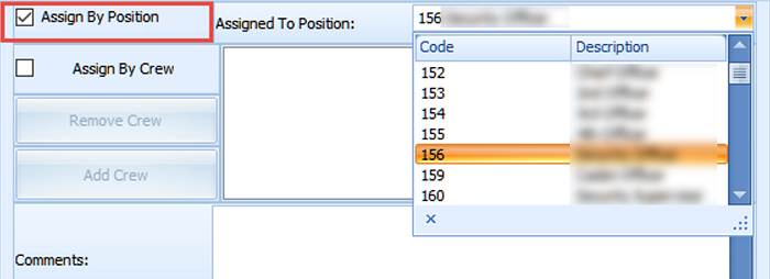

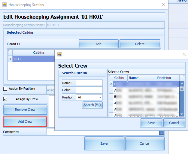

You can assign the selected section by crew position or individual crew member.
To assign by crew position, check the Assign By Position check box and select the position from the Assigned To Position drop-down list.
Figure 2-14 Assign by Position
To assign by crewmember, select the Assign By Crew check box and click Add Crew. You can use the Search Criteria to search for a crew member. Select Single or multiple crews from the grid and click Save to continue.
Figure 2-15 Assign by Crew
The selected crew is added to the Assign By Crew field.
Enter comments in the Comments textbox and click Save to save the Housekeeping Section assignment.

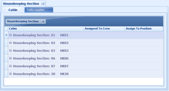

In the Cabin tab, the Assigned To Crew column lists all the crew assigned in the section, while the Assign To Position column lists all the crew positions belonging to the section.
Figure 2-16 Housekeeping Section for Cabin Overview
