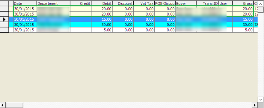

- Retrieve the account and navigate to the Invoice tab.
- Select the desire transactions and click No Print.
- If the transaction balance does not equal 0.00, the system prompts an error message.
To Reset No Print Transactions to Original State
- Select No Print transactions and click No Print.
- Transactions revert to normal postings and are no longer shaded in pale yellow.

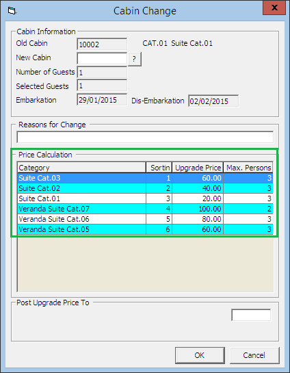

Change Cabin Function
A cabin can become unavailable due to defect, or the guest may want to move to a larger cabin or cabin closer to their family/friends. This would require a cabin change. Depending on the policy and procedures of the Ship, such a change might be chargeable. If a fee is applicable, you can set this up in the Administration, Financial Setup, Stateroom Upgrade Prices module.
You can perform a cabin change from different function — using either the Cabin Change function, Edit Information or the Edit Express Reservation function.
Changing a Cabin Using Cabin Change
When a cabin change is chargeable, it is recommended that you perform the task using the Cabin Change option in the Guest Handling function. A setup such as Financial Department, General Change Reason and Database Parameter must be in place in order for the charge to be posted. See Administration User Guide, Stateroom Upgrade Setup for more details.
Changing an Assigned Cabin
When the assigned cabin for the guest becomes unavailable at the point of check-in, re-assignment of the cabin is required. In such cases, the cabin change is done by editing the reservation.
- Repeat steps 1 to 4 of the above.
- In the Reasons for Change prompt, select the reason for the change from the drop-down list, then click OK to save the changes.
- Click OK on the Edit Information form to save the cabin reassignment.
