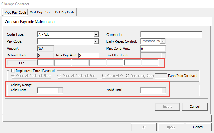

In the Contract Templates, the Pay code must have a GL code linked. The GL code for each pay code can be different even though the base wage may be the same. See section Adding Pay code to Contract Template.
Crew Payroll Details
In order to generate the GL file and correctly pay the crew, the Pay code must have:
GL Code that is entered in the Contract Templates
Validity Range entered in the Pay code of the Crew Details form, equivalent to the contract end date when the New Contract button is pressed.
The Validity Range fields refer to:
Selected Pay code Type
The value defined in Parameter Pay code for Vacation Pay.
The value of the parameter Mandatory Paid Thru Date for Vacation Pay is set to Y.
Figure 7-2 GL Entry Fields
If no validity is specified, the system will prompt you to complete them.
The Crew member may have one or more contracts and each contract may have multiple pay codes attached, and they must be updated with the validity date.

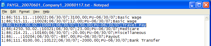

Example of Payroll GL Extract — Summary
Figure 7-4 Sample GL Extract File — Summary
The summary output file contains:
Company code.
Salary group ID – Mapping ID defined Department Mapping menu.
GL Number – Map with shore side general account ledger.
Pay Code Number.
EOM Date – The date format is set in the parameter Date Format.
Amount.
PU-MM/DD/YY – The date prefix is set in parameter Date Prefix where the date is set according to Date Format.
Pay Type Classification.

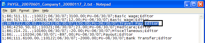

Example of Payroll GL Extract – with Position
Figure 7-5 Sample GL Extract File — with Position
Apart from the fields listed in the Summary output file, it includes a Crew Position at the end of the string.

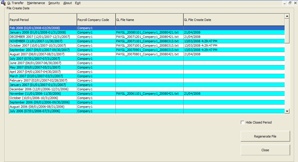

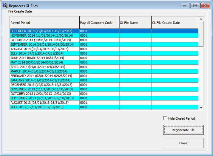

Regenerating the GL file
The system permits you to re-generate past GL files using the Reprocessing option from the GL Menu.
Figure 7-7 Regenerate GL File
Figure 7-8 Reprocess GL File
Click the Reprocessing option:
Opens the Reprocess GL Files window.
Select the file from the grid and then click the Regenerate File button.

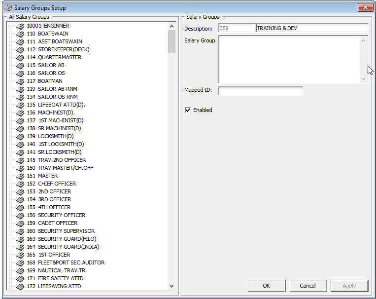

This replaces the previously generated files stored in the Transfer Folder.Department Mapping
You can map a shore side general ledger ID to the department code by selecting Department Mapping from the Maintenance menu to view the salary group.
Figure 7-9 Salary Group Setup
The mapped ID of Salary Group is equivalent to the shore side General Ledger account ID.
If there is no mapping ID defined, the output file will have a blank space at the 2nd column (salary group ID column).
