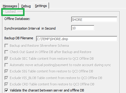

Synchronization Process for DB Using TDE
The synchronization process for a database that uses TDE are lesser from the standard process, and are listed in below table.
Figure 6-1 QCI Synchronization DB Locked

                                     The system disables all parameters in the Settings tab and a dimmed ‘Locked’ is shown on the window when the Offline Mode is ready.  |
