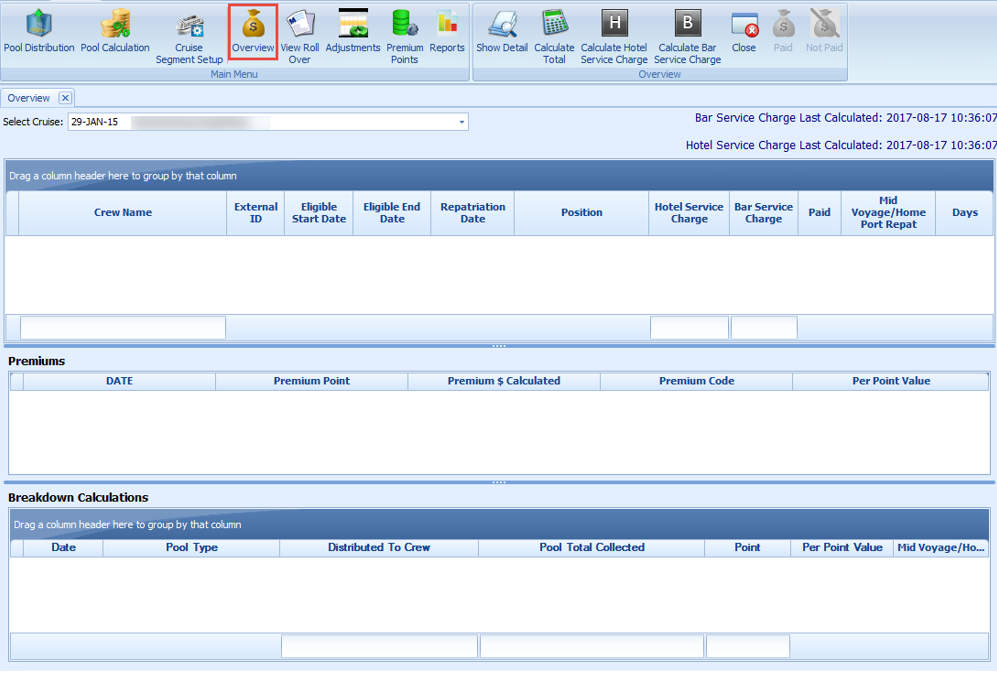

The Service Charge module calculates the total Hotel Service Charge (HSC) or Beverage Service Charge (BSC) of the day, then divides by the total pool points for the day before adding each day’s calculation to obtain the voyage total.
Figure 3-1 Service Charge Overview
Table 3-1 Service Charge Dashboard Fields

Click the Overview button to access the Service Charge Dashboard.
The Service Charge Dashboard window appears blank when you first open. Click Show Details to populate the information.
The window is divided into three (3) sections. The columns and width of these sections are adjustable by dragging the column divider.
If there are no HSC or BSC posting to the voyage at the time the Calculate Total button is first pressed, no crew members will appear in the list. The BSC list appears only when the BSC has been charged and not HSC or visa-versa.

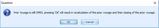

When the Calculate Total is clicked for the first time on a newly open voyage, the system automatically recalculates the previous open voyage for the final time, before closing the previous voyage and calculating the new voyage for the first time. After the previous voyage status is set to close, no further changes are allowed. Therefore, it is important to check and ensure the previous voyage that all the postings, premium points, and manual adjustments are complete.
Figure 3-2 Open Status of Prior Voyage

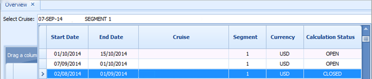

The date of the voyage status changes to Close becomes the Last Calculated date that appears in the Select Cruise drop-down list. Therefore, for reporting clarity it is best to maintain the last calculated date as the actual voyage or segment end date.
Figure 3-3 Segment Status
