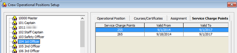

Login to Administration module, Administration, Crew Setup, Operational Positions.
Select a crew operational position. The Service Charge Points tab shows the service charge point. The points shown are for overview purposes only. All changes are performed in the Crew Management and Payroll Shipboard System (CMS), and then imported to SPMS using DGS CMS Ship Transfer.
Figure 2-1 Operational Positions Setup

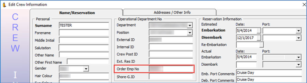

Log in to the Crew module, Crewmembers.
Search for the Beverage Staff or Room Service Stewards crew member.
Select the crew member and click Edit Information.
In the Name/Reservation tab, Operational Department No, enter the crew member employee ID in the Order Emp No field.
Click OK to save and repeat the above steps for all Beverage Staff or Room Service Stewards. The same steps apply to the new joiner that has a new employee ID card assigned.

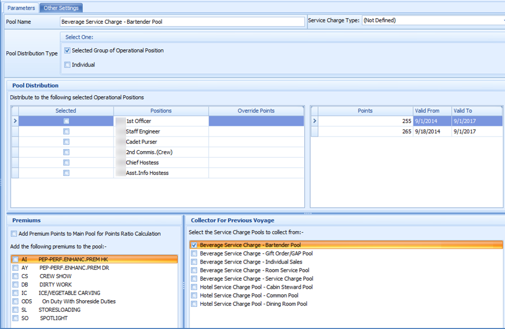

Pool Distribution
Select an Operational Position. The amount collected in this pool will be distributed to the crew member based on the selected operational position. The Override Point is an option to define different points for different positions in different pool. When processing the distribution calculation, the program will use the override point if it exist. If not, the program takes the default point.
Point
The Default Point refers to the Service Charge Point imported from CMS. Each Operational Position has a service charge point history with its validity range. If there is no Operational Position appearing in the list, import the Service Charge Point into HPO or OPO_POINT.
Premiums
Defines the premium pay amount to deduct from the pool. The premium work code is linked to Time Attendance (T&A) module, Work Code. The “Add Premium Points to Main Pool for Points Ratio Calculation” is an option to include or exclude premium points when calculating the initial point value. Applicable mainly to calculate HSC pool.
Collector For Previous Voyage
For user to define which pool the roll-over from the previous voyage should go to in the next voyage.

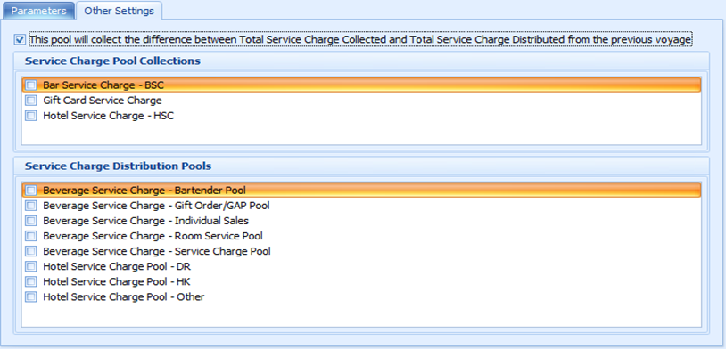

At the Other Settings tab, select the “This pool will collect the difference between Total Service Charge Collected and Total Service Charge Distributed” from the previous voyage to enable the selection window and then select the applicable check boxes.
Service Charge Pool Collections: Select a pool to collect the variance between the Collection side “Net for Distribution” and the Distribution side “Net Service Charge Distributed”. It is a collection versus distribution variance.
Service Charge Distribution Pools: Select a pool to collect the variance between ”For Distribution” and “Total Distributed”. It is a Distribution-side variance only.
Figure 2-4 Pool Distribution - Other Settings

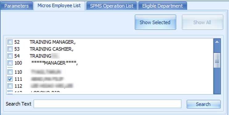

At the Micros Employee List tab, select the MICROS employee. The distribution type collects the service charge postings of the selected MICROS employee that closes the checks. This option is available to Distribution Type, By Micros Employee.
Figure 2-6 MICROS Employee List

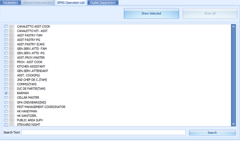

At the SPMS Operational List tab, select the SPMS operational position. The distribution type collects the service charge postings where the selected SPMS operational crew closes the checks. This option is available to Distribution Type, By SPMS Operational.

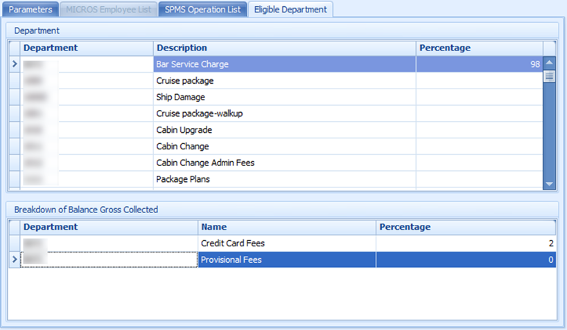

At the Eligible Department tab, select the eligible department service charge and define the percentage amount. For example, the Bartender type gets 98 percent of the total service charge posting in Bar Service Charge department.
Figure 2-7 SPMS Operational List
Information in the Breakdown of Balance Goes Collected section reports the Credit Card Fees and Provision Fees entered.
Figure 2-8 Eligible Department
The Pool Type Percentage field automatically calculates and fills the remaining column percentage to 100 percent when one of the percentages is specified.

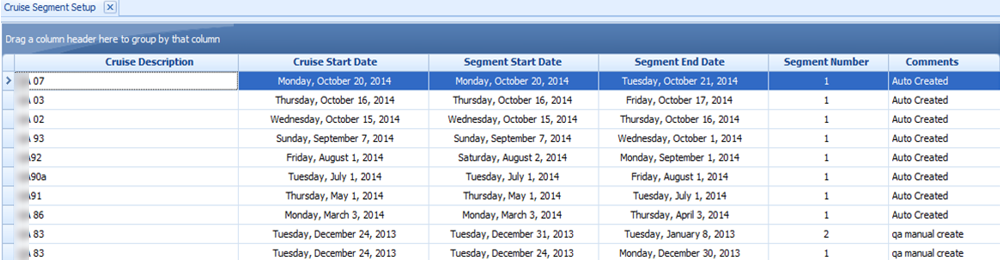

Cruise Segment
This function allows the ship operator to calculate the distribution total by segment for a long voyage or a cruise. This is useful for world cruises where the calculation is broken down into multiple segments, and calculates the total distribution weekly.
The system automatically creates the cruise segments for all future cruises based on the system cruise setup when the program starts up, and on remarks in the Comments column.
Figure 2-9 Cruise Segment
To create a Cruise Segment, click the Cruise Segment Setup button at the Service Charge Dashboard.
In Cruise Segment setup, click the Add button to create a new cruise segment.
At the Select Cruise drop-down list, select a cruise. The listing shows the current cruises and all future cruises only. Click the header to sort the display.
Do note that the cruise segment for current cruise is no longer available after running the service charge calculation on the current cruise.
Define the start date, end date of the segment, and select the Segment number from the drop-down list. You can add up to 10 segments. Note the following when adding a segment:
The earliest cruise is displayed first. The cruise end-date defaults to actual cruise end date.
When creating multiple segments, by default the displayed cruise start date is the previous segment end date, and end date is the actual cruise end date.

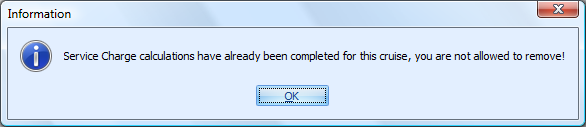

Once the service charge calculation of the cruise segment completes, it is not possible to delete them. The system prompts a warning message when an attempt is made.
Figure 2-10 Disallow Service Charge Removal Notification

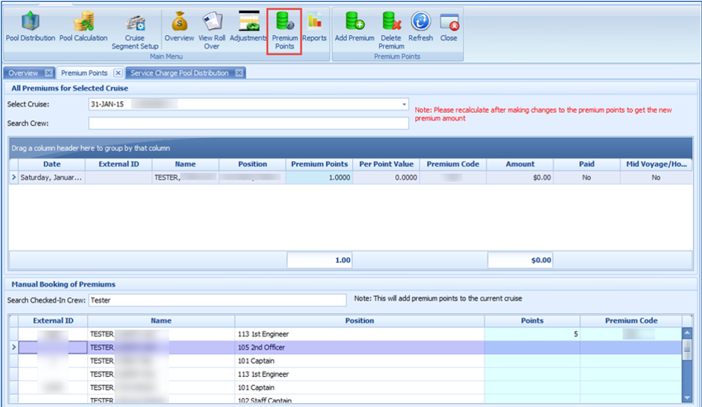

A Premium Point is a calculation that calculates the premium work hour deductible in the Hotel Service Charge calculation. There are two types of premiums payable in the Hotel Service Charge; those that are scheduled and approved in the T&A module, and those manually booked in Service Charge module. The Premium Points approved in the T&A module has a default point-value per hour in Payroll module, Interface Pay codes. After the Manager approves the premiums points, then only those points appear in the Service Charge Overview, Premium Points section. This function is controlled by the “Hotel Service Charge” and “Show Premium Points Calculation” parameter.
Login to the Service Charge module and click Premium Points.
Figure 2-11 Premium Points
Table 2-3 Premium Points Field Definition
Field Name Description Date
Actual work date entitled to premium rate recorded in T&A module.
External ID
Crew ID.
Name
Crew name.
Position
Crew operational position.
Premium Point
Premium work hour (approved in T&A module) x the pay rate. The pay rate refers to the premium work hour in Payroll, Interface Paycode.
Per Point Value
Point value as of last Calculate Total. If Calculate Total has not been process after new premium points appears, then the point value and amount will be zero until the next voyage recalculation.
Amount
(Points x point value) based on latest Calculate Total.
Paid
Payment indicator. Indicates premium point is paid through Payroll for repatriating crew.
Mid Voyage/Home Port Repat
Indicates crew member is repatriating during or at end of voyage; Flag a “YES” when system date = crewmembers’ eligibility-end date.
In the Premium Booking window, select the Select Cruise from the drop-down list. The default view is the current voyage and all premiums approved in the T&A module.
To locate the specific crew from the list, enter the Crew ID in the Search Crew field and press Enter.
If no premium work hours is approved in T&A module or Pay Rate defined in the Payroll module, a Crew officer can manually book the premium through Manual Booking of Premium.
To perform Manual booking of HSC Premium point, go to the Manual Booking of Premiums section. Enter the Crew ID or a name in Search Checked-In Crew and press the Tab key.
Click the Add Premium button at the ribbon bar. Enter the point quantity and select the Premium code from the drop-down list. Premium codes displayed in the drop-down list are for manual entry and they are different from those approved in the T&A module.
When a message prompts “Are you sure you want to manually book these premium points for the selected crew?”, click Yes to proceed. The booking displays in the Premium Points window. After the next Calculate Total is processed, the premium pay amount appears.
Manual booking of premium point(s) are added into the current cruise.
Inclusion of the Premium Point into the main pool for initial point ratio calculation must be define in Pool Distribution setup, Add Premium Point to Main Pool for Points Ratio Calculation.
Adjustment to manually booked points is allowed using the above steps. Deleting a manually booked premium entry is possible as long as the cruise status is “Open”. Select the manual booked premiums and click Delete Premium at the ribbon bar.
Click Yes at the message prompt “Are you sure you want to delete this Premium record?” to confirm the exclusion.
Re-run the calculation process.

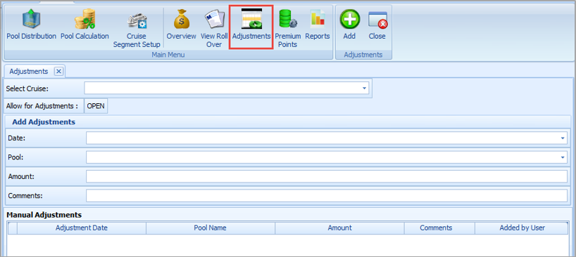

This function adds or deducts an amount to or from specific Pool(s). Before you make any manual adjustments to each pool per voyage, make sure the Allow for Adjustments is OPEN.
Click the Adjustment button from the ribbon bar.
Select the cruise using the Select Cruise drop-down menu. The default view is the current voyage with the cruise status indicated at the side.
In the Add Adjustments section, the date is defaulted to the first day of the current voyage. Use the drop-down menu to select the correct date from the date editor. Backdating an adjustment in the current (open) voyage is permissible since the Service Charge Pool calculations are based on daily values. The day’s service charge value is influenced by the adjustment posting date.
Select the specific Beverage or Hotel Service Charge pool to adjust from the Pool drop-down list.
Enter the amount to adjust in the Amount field. The amount can be positive or negative.
Enter an explanatory comment in the Comments field if necessary.
Click the Add button at the ribbon bar and then recalculate the service charge.
Do note that after adding adjustments, it is not possible to delete them. However, you can post another adjustment of the same date to offset the posting.
It is important to pay attention to the date of the adjustment booking as the calculation is based on the days point and the point value are calculated on a daily basis.

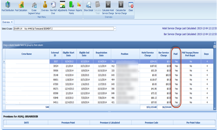

Leavers Paid Status
The Service Charge module is typically installed together with the Payroll module. For example, you can use an external Payroll system to pay the service charge, thus requiring a function to manually set the crew Paid Status in the Service Charge module.
Setting the value in the General, Use Payroll to 0 parameter activates the Paid/Not Paid button in the Overview ribbon bar. After the Crew Officer confirms all leavers are paid and receipts are generated, the Purser then manually sets all BSC leavers status to “Paid” in the Service Charge module.
Selecting the crew record(s) and clicking the Paid button flag sets the Paid column status to Yes. Similarly, clicking the Not Paid button resets the flag to No.
Figure 2-12 Leavers Paid Status
At the closure of the voyage/segment, click Calculate Total. The system automatically triggers all non-leavers Paid status as “Yes”. At the confirmation prompt, select OK to proceed.
At this time, all Beverage Service Charge (BSC) earned in the voyage by all non-repatriating Crew members status are automatically flagged as Paid and the window is locked for any modifications.
