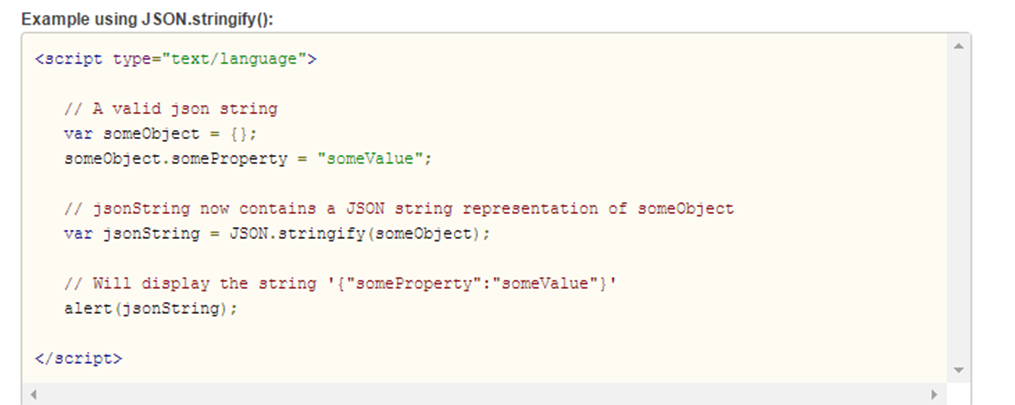

Sample JSON Http Post
For JSON you must serialize the object to string first.
Figure 4-1 Sample JSON String
POST /OHCWebServices/OHCWebServices.asmx/FidelioSPMSWSJsonPost HTTP/1.0
Host: localhost
Content-Length: 1771
{callback:"Testing",psSessionID:"ad765829-3fb7-4f1b-9754-587d43a879ab",psFunction:"FCUIPosting",psParam:["2440167",3,1,0,true,"{\"gbCallPosting\":false,\"gsPin\":\"\",\"gsUniquePostingID\":\"1234\",\"gsCheckImage\":\"INVOICE – EXAMPLE COMPANY \\r\\n RESTAURANT \\r\\n1 CASHIER 1\\r\\n--------------------------------\\r\\n1/1 1234 GST 1\\r\\n JUN12'07 6:44PM \\r\\n--------------------------------\\r\\n 1 FRIED RICE 12.34\\r\\n DISCOUNT\\t\\t 2.10- \\r\\n SERVICE CHARGE 0.12 \\r\\n TIP 1.00 \\r\\n TOTAL PAID 11.36 \\r\\n 05000\\r\\n XXXN070612184500\\r\\n MANUAL ENTRY\\r\\n Cabin/Acc:05000\\r\\n <LAST/FIRST NAME>\\r\\n CABIN CHARGE 00.00 \\r\\n---1168 CLOSED JUN12 6:45PM----\\r\\n . \\r\\nSIGN:...........................\\r\\n . \\r\\nAll Amounts in US Dollars (USD$)\",\"gbyCheckImage\":null,\"gsPosInfo\":\"\",\"gsItemDetail\":\"1234?Cashier 1?1?0?Gift Shop?205789412|T-Shift|1|12.34\",\"gbForcePosting\":false,\"goPosting\":[{\"gnServingPeriod\":0,\"gnPostingTotal\":10.01,\"gnPostingDiscount\":1.01,\"gnPostingServiceCharge\":1.02,\"gnPostingTip\":1.03,\"gnPostingTax\":1.04,\"gnInvoiceWin\":0,\"gsOutletID\":\"264\",\"gdCallStart\":\"20130620100105\",\"gsCallNoDialed\":\"12345678\",\"gnCallDuration\":159,\"gsCallType\":\"Sat\"},{\"gnServingPeriod\":0,\"gnPostingTotal\":11.0,\"gnPostingDiscount\":1.01,\"gnPostingServiceCharge\":1.02,\"gnPostingTip\":1.03,\"gnPostingTax\":1.04,\"gnInvoiceWin\":0,\"gsOutletID\":\"262\",\"gdCallStart\":\"20130620100105\",\"gsCallNoDialed\":\"12345678\",\"gnCallDuration\":259,\"gsCallType\":\"Sat\"}]}"]}
