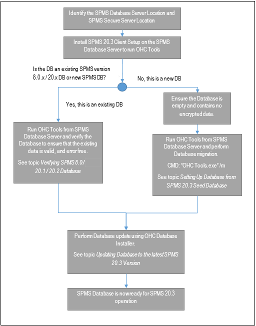

The diagram below summarizes the process of setting up the SPMS Database Server based on the options available to you when preparing the SPMS 20.3 Database.
Figure 4-1 Database Preparation Workflow
This figure shows the Database Preparation Workflow

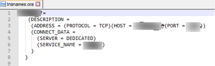

You will need the Database TNS Name entry created in the TNSNames.ora file so that SPMS can locate the correct database when it references the Database TNS.
  1. The commonly installed Oracle Client folder for SPMS is C:/Oracle/product. However, you may select to install it in a different folder. Now configure the Database TNS in the TNSNames.ora file. See Table 3-1.
        <DB_TNS_NAME> = (
            DESCRIPTION = (
                ADDRESS_LIST = (
                    ADDRESS = (PROTOCOL = TCP)
                              (HOST = <DB_ADDRESS>)
                              (PORT = <DB_PORT>)
       	  (CONNECT_DATA = (SERVICE_NAME = <DB_NAME>)
    Figure 4-2 Sample TNS Configuration in Tnsnames.ora
    This figure shows a sample TNS Configuration in Tnsnames.ora.

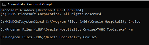

  2. Run the Windows Command Prompt as a Windows Administrator.
  3. Navigate to the Installed SPMS Application folder. For example, C:\Program Files (x86)\Oracle Hospitality Cruise.
  4. Run the OHC Tools for Database migration using the following command.“OHC Tools.exe” /m.
    Figure 4-5 Windows Command to Launch OHC Tools
    This figure shows the Windows Command to launch OHC Tools Migration mode.

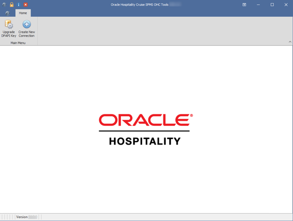

  5. This will lead to the screen as shown below.
    Figure 4-6 OHC Tools /M Mode Main Screen
    This figure shows the OHC Tools / M Mode Main Screen

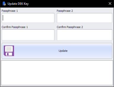

  6. Click the Upgrade DPAPI Key button to create a new Database entry record to both the local OHCSecurity.par file and at the SPMS Secure Server.
  7. At the Security Login prompt, select the Database TNS and enter the Database Password for authorization.
  8. Key in the passphrase and click the Update button.
    Figure 4-7 Encryption Passphrase Update Form
    This figure shows the Encryption Passphrase Update form
  9. Upon completion, you will find that the SPMS Database password and encryption key are safely encrypted and stored by the SPMS Secure Server.

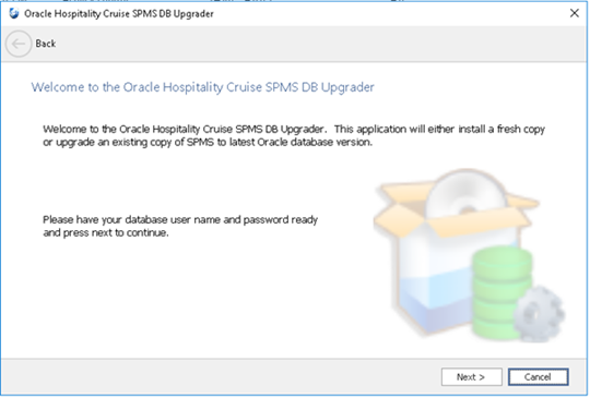

  4. Double-click the OHC Database Installer.exe to launch the program.
    Figure 4-8 OHC Database Installer Welcome Screen
    This figure shows the OHC Database Installer Welcome Screen.
  5. Click the Next button to navigate to the next screen.

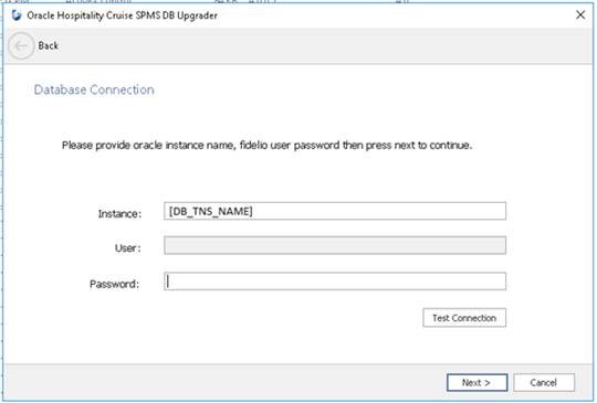

    Figure 4-9 OHC Database Connection Instance Selection/Password.
    This figure shows the OHC Database Connection Instance Selection/Password.
  6. On the Database Connection screen, enter the Database TNS name and Database Schema Password for SPMS.
    • If the Database TNS name or Database Schema password is incorrect, you will receive an error message. Correct the information and retry.
  7. To validate the Database connection, click the Test Connection button.
    Figure 4-10 OHC Installer DB Connection Successful
    This figure shows the OHC Installer DB Connection Successful,

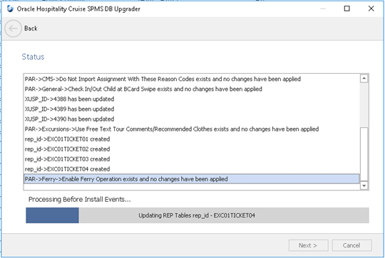

    Figure 4-11 Update Progress of OHC Database Installer
    This figure shows the update progress of OHC Database Installer
  13. The SPMS Database Version Update progress is shown in the Status screen. When the update process completes, click the Next button to proceed.
