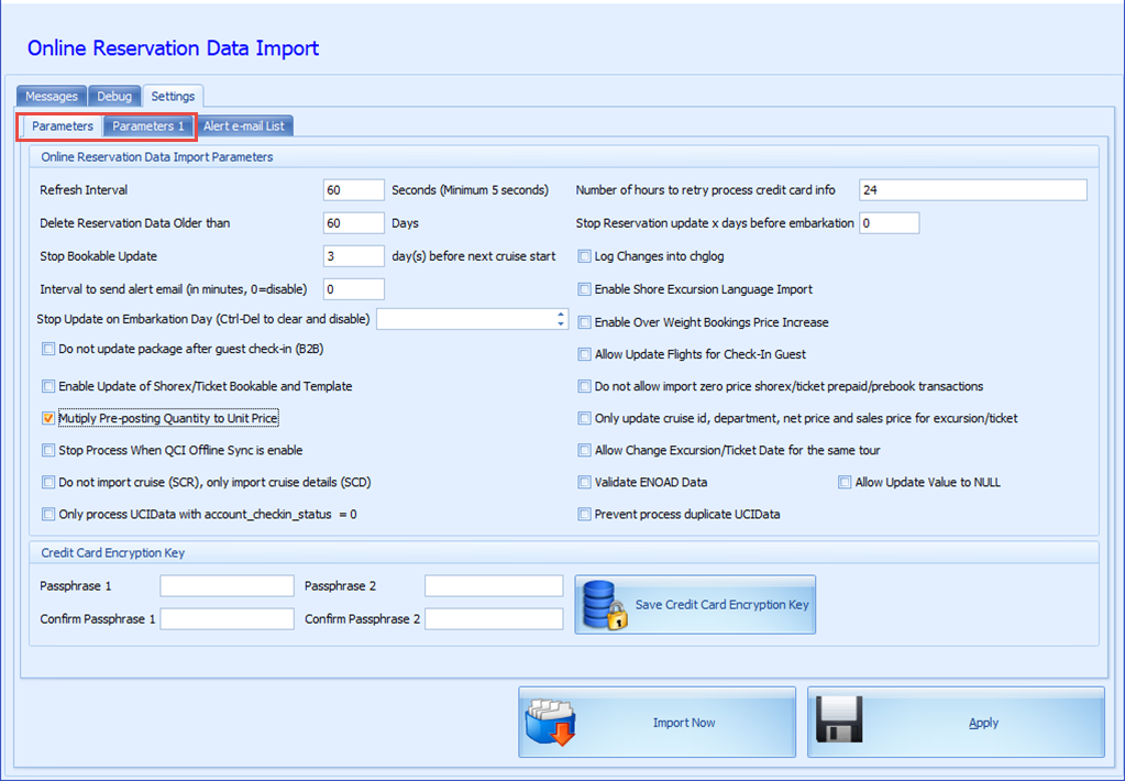

Apart from enabling the above system parameters, the program also requires interface parameter settings to further define and manage the information to be transferred to Oracle Hospitality Cruise Shipboard Property Management System (SPMS). The interface parameters are categorized into three sub-tabs in the DGS ResOnline, Settings tab.
  • Parameters: All settings for data transfer from Oracle Cruise Hospitality FleetManagement System (FMS). See Table 6-2 for detailed description of the parameters.
  • Parameters 1: All settings for data transfer from FMS (continuous).
  • Alert E-Mail List: An alert email list to inform user of the transferred reservation status.
The information transferred from FMS to SPMS depends on the settings.
Figure 6-1 DGS ResOnline Parameters
This figure shows the DGS Resonline Parameters and Parameters 1 tabs.
Table 6-2 DGS ResOnline Parameters
Parameter Description
Refresh interval by seconds
The intervals time to obtain new data to transfer if any. Default minimum interval is 15 seconds.
Delete reservation Data Older than x days
Minimum setting is seven days based on the following process:
  1. The system removes messages from Reservation that has status = 3 and Reservation modification date < system date – x days.
  2. Remove Reservation Response data (RSP) based on RSP_MODDATE compared against x days.
  3. Remove Reservation Details Log (RSD) based on RSD_RSL_ID IN (SELECT RSL_ID FROM RSL WHERE (RSL_EMB_E IS NOT NULL AND RSL_EMB_E < DATE (SYSTEM DATE – X DAYS) OR (RSL_EMB_E IS NULL AND RSL_MODDATE < DATE (SYSTEM DATE – X DAYS)
  4. Remove Reservation Update Log (RSL) - WHERE (RSL_EMB_E IS NOT NULL AND RSL_EMB_E < TO_DATE('2016-07-12','YYYY-MM-DD')) OR (RSL_EMB_E IS NULL AND RSL_MODDATE < TO_DATE('2016-07-12','YYYY-MM-DD'))
Stop Bookable Update x days(s) before next cruise start
This stops any shore excursion and bookable ticket update x days before the start of next cruise. This change only affects shore excursion bookable and templates for future cruise.
Interval to send alert email (in minutes, 0=disable)
Define the interval to send an alert email, based on email list defined in ‘Alert e-mail List’ tab.
0 = disable send alert email.
Stop Update on Embarkation Day (Ctrl+Del to clear and disable)
Define the time to stop an update on embarkation day. Press Ctrl+Del to clear the time value.
Do not update package after guest check-in (B2B)
This stops the update of package for checked-in guest, and is only applicable to back to back guest.
Enable Update of Shorex/Ticket Bookable and Template
This allows update of shore excursion/bookable ticket tour and template. This rule depends on the “Stop Bookable update x day(s) before next Cruise start.”
Multiply Pre-posting Quantity to Unit Price
This multiplies the pre-posting quantity by unit price for input to PPS_TOTAL field. Requires additional configuration in Administration module, Database parameter.
Stop Process When QCI Offline Sync is enable
This function pauses the ResOnline updates when the QCI Offline Sync process is enabled and resume when QCI Offline Sync stop is running.
Do not import cruise (SCR), only import cruise details (SCD)
This flag is to only import System Cruise Days Information, excluding Cruise Itineraries.
Only process UCIData with account_checkin_status = 0
This flag only processes UCIData with status Registration that is not complete.
ACCOUNT_CHECKIN_STATUS=RES_RGN_COMPLETE
Number of hours to retry process credit card info
Define number of hours to retry processing of credit info in DGS.
Stop Reservation update x days before embarkation
Stops reservation update x days before of embarkation date.
Log Changes into chglog
Log changes made into change log table.
Enable Shore Excursion Language import
This enables the import of language from Shore Excursion.
Enable Over Weight Bookings Price Increase
This enables price increase by percent set in Overweight Booking.parameter
Allow Update Flights for Check-In Guest
This enables the flight info update for Check-In Guest.
Do not allow import zero price shorex/ticket prepaid/prebook transactions
This disables the import of prepaid/pre-book transactions Shore Excursion with zero pricing.
Only update cruise id, department, net price and sales price for excursion/ticket
This only allow updates of cruise ID, department, net price and sales price for excursion only.
Allow Change Excursion/Ticket Date for the same tour
This enables changes made to tour/ticket of the same record even though the booking date is different.
Validate ENOAD Data
When enabled, the system validates the Electronic Notice of Arrival/Departure (ENOAD) data during import, and inserts as Import Warning if any of the ENOAD data is missing.
The ENOAD data validation warning is viewable from ResOnlineViewer application, Import warnings.
Allow Update Value to NULL
This allows the change of Excursion or Ticket Date for the same tour.
Prevent process duplicate UCIData
This enables the update of value to null when the flag is checked.
Allow Field Update for B2B Guest : Disembarkation Date
This enables the additional fields to be updated for back to back guest, even after guest has checked in.
