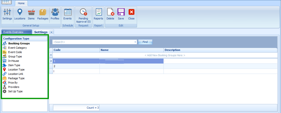

Event Settings Overview
Figure 1-1 System Setup
The Event Settings Overview is the main configuration window for setting up parameters and settings for furniture fitting, sound systems, utensils, and other equipment needed by the ship operator to organize an event. The Configuration Type features Booking Groups, Event Category, Event Code, Group Type, In-House, Item Type, Location Type, Location Link, Package Type, Price By, Providers, and Set Up Type Functions.
Configuration Type
Configuration Type contains all the general settings used in the Event module and are described below:
Booking Group: The Booking Group holds the security codes that determine who is allowed to book or change an event location.
Event Category: The Event Category code is used to categorize the type of event and is mainly used in report printing.
Event Code: The Event Code holds the Priced By, Event Category, and Event Name that enables a quick entry of an Event on the Event Detail Form.
Group Type: The Group Type code defines the specific type of Group, which vary from one Cruise Line to another.
In-House: The In-House code defines an event category associated with the department or area for a non-group event.
Item Type: The Item Type code defines the items by groups, for example, cutleries, linens, furniture and much more.
Location Link: The Location Link holds a generic code for a location that groups a few locations, to facilitate the copying of templates from one ship to another.
Package Type: The Package Type defines the packages used to help find a specific package.
Price By: This stores the price by codes available to the cruise liner. See the table below:

Providers: The Providers code defines the shipboard group responsible for fulfilling items required by the event.
Setup Type: The Setup Type defines the available seating or set up for the location. For example, U-Shape seating, Theatre, Pool Party, Conference, and others.

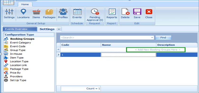

Adding New Configuration Codes
Figure 1-2 New Configuration Codes Window
- From the ribbon bar General Setup group, click Settings and then navigate to Configuration Type to select the configuration type to add.
- The Code field is mandatory. Insert the code, name, and description in the field below the Search bar, and then click Save to save the record.
- When you click Save on the input field when the code is empty, the system prompts a warning message: Please enter a unique code. Do you want to correct the value?
- Click Yes and insert the code accordingly.
- Click Save to save the record.

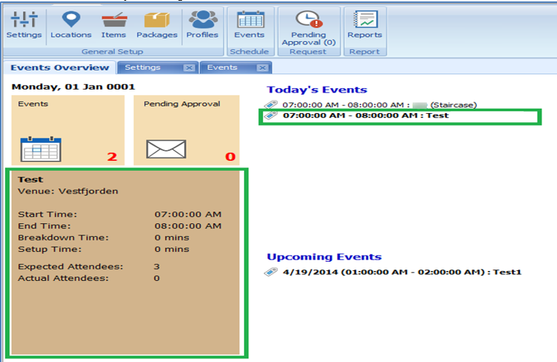

The Events Overview shows the summary of events for today and upcoming events with the summary of total events pending approval. Click the functions available on the window to view additional event information details.

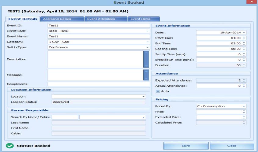

Double-clicking on any available event in the Today’s Events or Upcoming Events section launches the Event Booked window.
Figure 1-4 Event Booked

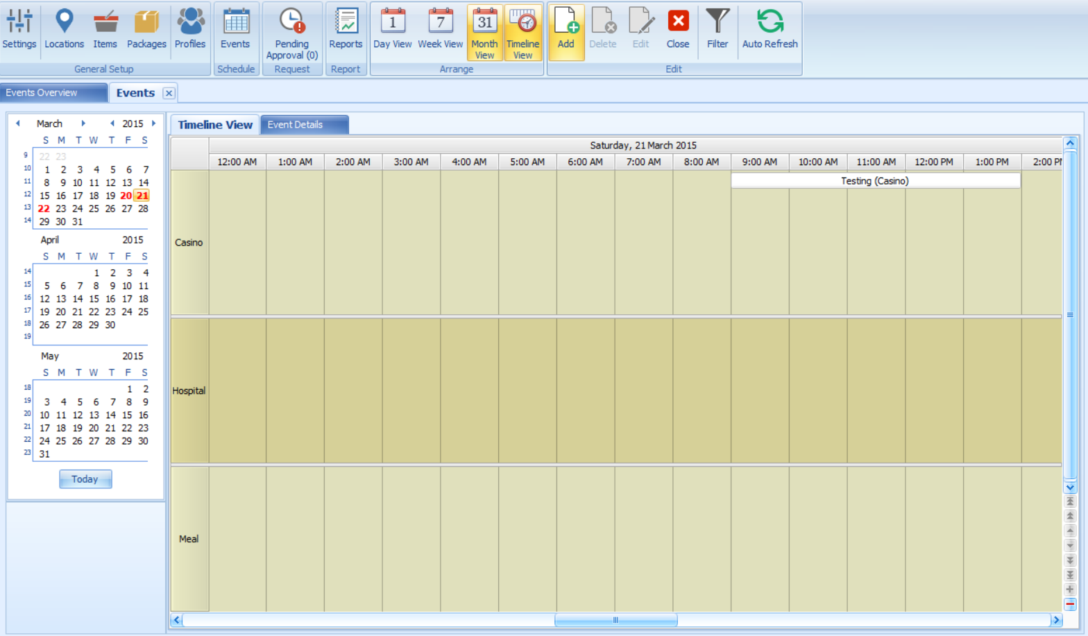

Clicking the number of events in the Events section displays the event in Date, Week, Month or Timeline grid. You can also add or edit an event from this window. See Event Management section for steps to add, delete, and edit an event.
Figure 1-5 Events —Timeline View

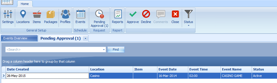

Clicking the number in the Pending Approval section displays the list of events that are waiting to be approved.
Figure 1-6 Event - Pending Approval Tab

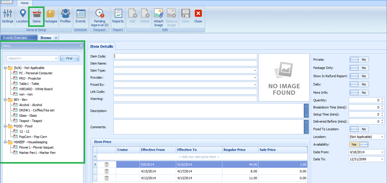

Items Setup
Figure 1-8 Items Tab
The Items Setup allows you to define every item used for an event from the type of cutleries, flower arrangements, furniture and others. Multiple prices per item based on a date period is allowed, enabling a selection based om the cruise selection and Effective From and Effective To dates.

Adding an Item/Price
- Under the General Setup group on the ribbon bar, click Item Setup. The Item Code, Item Name, Item Type, Provider, and Priced By are mandatory fields. The system prompts an error if one of the fields is empty.
- On the left of the Items tab, expand the tree view and then click Add to add a new item.
- In the Item Details section, enter all the necessary fields.
- Navigate to the Item Price section, select the cruise, select the effective date from/to from the drop-down list and insert the regular price and sale price. Overlapping dates are not permissible in item price setup. For an item price changed that is already booked for the current system date or future event, price changes apply to these events also.
- It is not permissible to set up item prices with an overlapping date. If the input item price has an invalid date, the system prompts a Confirmation prompt. Click Yes to edit or No to exit without making any changes.
- Various controls are available and switching these controls to Yes does affect the Item Price behavior.
- Once all the required information is entered, click Save to save the changes.
