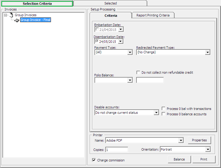

Figure 7-1 Quick Balance Selection Criteria
Table 7-1 Quick Balance Selection Criteria
Field | Description |
Passenger Invoices |
Type of invoice form. |
Embarkation Date |
Embarkation Date filter. |
Disembarkation Date |
Disembarkation Date filter. |
Express Check Out |
Select to include/exclude in Express Check-Out. |
Payment Type |
Payment type filter. |
Redirected Payment Type |
Redirect selected payment to another payment method. |
Package Plan |
Filter by Package Plan. |
Folio Balance |
Filter by folio balance, for example: greater than or equal to X value. |
Do not collect non-refundable credit |
Credit balance withheld for use in future cruise. |
Deck |
Invoice sort order by deck. |
Starboard/Portside |
Invoice sort order Starboard/Portside. |
Section |
Invoice sort order by section. |
Disable accounts |
Update account status to "allow manual postings only" or "blocked all postings" |
Process 0 bal with transactions |
Include guests that have already settled in full and allow a reprint of the invoice in Quick Billing window. |
Process 0 balance accounts |
Include 0 balance accounts with/without transactions. |
Group |
To include Group Account. |
Printer |
Printer assigned for invoice printing, number of copies to print and print orientation. |
Charge Commission |
Define whether applicable commission applies when balancing the accounts. |

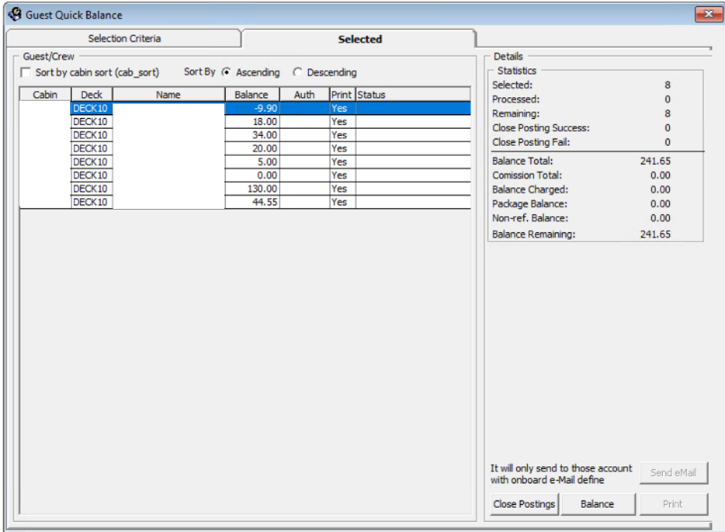

Figure 7-2 Quick Balance Selected Tab
Table 7-2 Field Definition of Guest Quick Balance
Cabin |
Cabin number. |
Deck |
Location of Cabin. |
Name |
Guest Name. |
Balance |
Total Invoice Balance. |
Auth |
Authorization Status. |
Invoice Printed status. |
Status |
Close Posting status or Invalid Address validated during Balance process. |
Statistics |
Indicator count of selected, processed, and remaining accounts and close posting - successful/fail with its value is in balance or charged. |

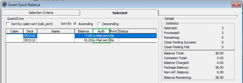

Send eMail |
Invoices are emailed to guest on-board email account. |
Close Postings |
Set invoice postings to close. |
Balance |
Process balancing for selected accounts. |
Print invoices for selected accounts. |

The Selection Criteria tab in the Guest Quick Billing function determines the type of invoices to print/pay based on the criteria chosen for all disembarking passengers, for example, passenger paying by credit card or only guest with x outstanding amount.
From the Cashier file menu, select Guest Quick Billing function.
In the Guest Quick Balance window, select an invoice type, Embarkation Date, Disembarkation Date, Payment Type, Folio Balance (if applicable), Deck, and Section.
In the Printer section, select an invoice printer, enter the number of copies to print, select the print orientation, and click Print.

Navigate to the Selected tab to verify the result, and adjust the selection until the desired result is achieved.
To exclude a passenger from the search results, right-click on the name and then click Remove. Once the passenger is removed, the statistic count updates accordingly.

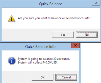

At the Confirmation prompt, click Yes to confirm and then click Balance.
Click Yes at the Quick Balance prompt, then click OK at the Quick Balance Info prompt.

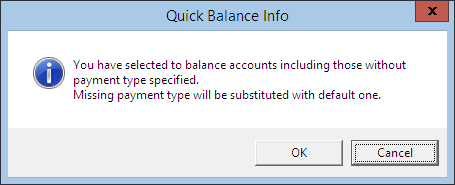

Figure 7-3 Quick Balance Info Prompt
In the Quick Balance Info warning prompt, read the warning, and then click OK to proceed.
Figure 7-4 Quick Balance Info on Balance
The total charged value and number of accounts processed are shown in the Statistic section once the account is balanced successfully.

Quick Bill eMail
Passengers or crew members that haves on-board email accounts can opt to receive copies of their invoices by email. This function is controlled by a parameter. Consult your IT Department for setup if this capability requires configuration.
