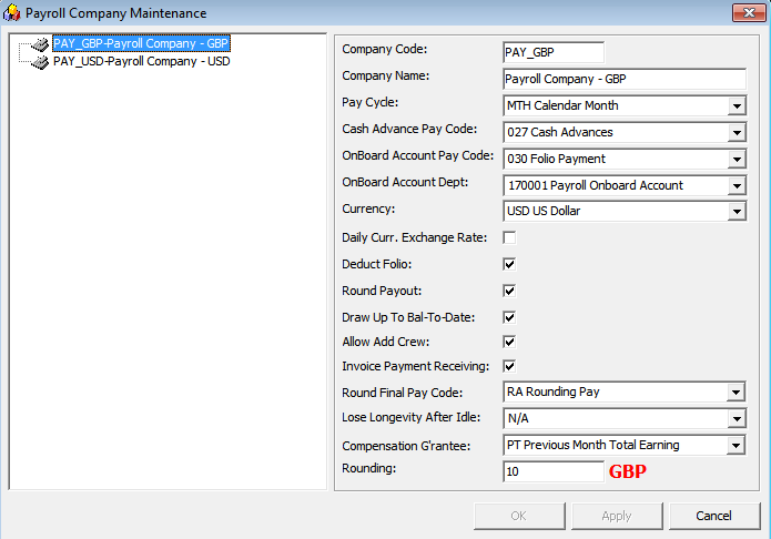

1 Setting up Payroll Codes
A Payroll company is used to separate a range of shipboard payrolls that have different processing cycles or payroll currencies. Before you begin using the payroll module, you must set up a Default System Code, Payroll Company, Salary Group, Salary Position, Calculation Method, Contract Template, Scheduled Contract Changes, Tax Type, and Payroll Setup Copier.

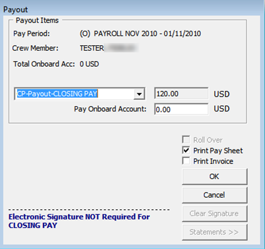

Payout This pay code is used in the final payments of the net pay to an individual. A normal payout would include cash, ship’s bank, and a financial institution or accrued to the next period.

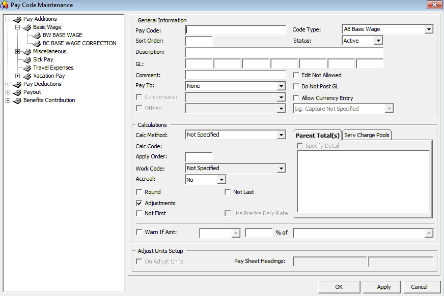

Figure 1-1 Pay Code Maintenance
Table 1-1 Pay Code Maintenance Field Definition
| Field | Description |
Pay Code |
A unique identifier for the pay code. Usually a number, but can be alphanumeric. |
Code Type |
The type and group of this pay code. |
Sort Order |
User definable sort order. If no additional sort is required, enter a zero (0) in this field. |
Status |
The current status of the pay code (Active or Inactive). |
Description |
The name of the pay code. |
GL |
The general ledger account number of the pay code. |
Comment |
Any additional information for this pay code. |
Pay To |
Determines if the pay code requires information on where to send the deduction or payment.
Compensate |
Works with code type, Benefit Contribution – BCC & BUP to populate pay deduction as the deduction of payroll for crew contributions to pension plan or medical plan. |
Offset |
Work with code type, Benefit Contribution to populate the benefit contribution pay code as the benefit posting to the balance automatically when payroll is paid out at the end of the pay period. |
Edit Not Allowed |
An option that disables the user from being able to modify the pay amount of the pay code while editing the contract or assignment. |
Do Not Post GL |
The option to not write the pay code into the GL file when generating a GL file. |
Allow Currency Entry |
A function to allow entry of currency conversion when adding posting or payroll adjustments. Note: Applicable to Quick Posting, New Pay Item, Cash Advance, and Payout. |
Signature Capture |
A signature capture is required during payout. Only applicable when selecting Payout. |
Calc Method |
This code determines the calculation method used to calculate the amount of the pay code. |
Calc Code |
Works with Calculation Method ‘A-SPEC’,’D-SPEC’ or ‘P-SPEC’. It represents a special calculation method that was added to the program to handle a calculation outside the normal methods. |
Apply Order |
The posting order of the pay codes when calculating the pay. The order is within the Additions, Deductions and Pay Out pay groups. Note: If a pay code is to be based on a previously calculated amount, then that amount must have a lower apply order of the pay code set up so that its value will be available for the calculation. |
Work Code |
Works with the Time Attendance calculation method A-TAOT, A-TAHO, A-TANO, A-PPPH. |
Accrual |
Amount accrued for the next month.
Note: Only Pay Additions and Pay Outs can be accrued. |
Parent Total |
For certain Calculation Methods (Percent of another amount for example), you can specify the percentage to include on previously calculated pay codes For example: The new Pay Code “10% Percent Bonus” is a percentage of the person’s Basic Wage and Leave Pay. Note: The apply order field for the new pay code must be greater than the apply order field for any of the amount to be used in the calculation. When this button is selected, a list box appears, allowing you to pick the pay codes. |
Service Charges Pool |
Works with the Service Charge calculation method A-HBSC to populate the service charge pool type. |
Use Precise Daily Rate |
Uses a more precise formula to calculate monthly pay. Example: 10% of Monthly Wage $2100 Used with Precise Daily Rate: 10% x (2100 *12/365) * 29 (contract day) = $200.22 Without Use Precise Daily Rate: 10% x (2100/30) * 29 (contract day) = $203 Note: This option is enabled when the pay code is selected at Specify Detail. It is used more on the A-PERC calculation method. |
Round |
Round the final amount calculated for this pay code to the nearest denomination unit of currency. |
Adjustments |
Option to allow the pay code for manual adjustments. Note: Applicable to Add New Pay Item, Quick Posting, and Cash Advanced. |
Not First |
Do not use this pay code for the first pay period of the contract. |
Not Last |
Do not use this pay code for the last pay period of the contract. |
Warn if Amt |
This restricts the amount entered on one (1) pay code based on the amounts entered for another pay code. For example: If an allocation must be at least 80% of a crew member’s base pay, you would check the Warn If check box, select “is less than” from the drop-down list, enter 80 in the percent text field and select “Base Pay”. |
Adjust Unit Setup |
Determines whether this pay code appears on a person’s pay sheet so that unit information can be entered. Pay Sheet Headings: The descriptions to display at the top of the Pay Sheets for Multiple People form. Note: Apply to calculation methods assigned to ‘PPER, HOUR, PDAY, SPEC, PDTD, PDTI, PPMW, PPTE, PWEK, PYER, VACP, TAHO, TANO and TAOT’. |

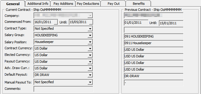

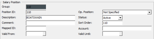

Salary Position
Salary Position groups people by its job responsibilities within a Salary Group. These groups of people typically have a similar, if not identical contract.
A set of salary positions is maintained for the entire Payroll system and is used by all companies set up in the system.
Creating Salary Position
Select the Salary Position from the Payroll Maintenance menu option.
A list of Salary Groups is shown in the Salary Position Maintenance window. Click the plus (+) key to expand the view of existing Salary Positions.
Right-click the Salary Group and select Add New to create a new position.
Enter all the require information and click Apply to save. Refer to the following table for field descriptions.
Figure 1-2 Salary Position
Table 1-2 Salary Position Field Definition
Group ID |
Field represents the Group ID of the Salary Group. This is generated automatically based on the selected Salary Group. |
Position ID |
Unique ID for Salary Position. |
Description |
Position name. |
Comment |
Additional comments. |
Mapped ID |
GL mapping field used in the GL Output field. |
Valid From/Until |
Validity Period for the position. If the field is blank, this means the position does not have a Validity date. The program checks the valid date against the current system date. An expired or invalid position is not shown when creating a crew contract/assignment. |
Op. Position |
Links the Salary Position to Operational Department. Once the position is linked, the crew member that belongs to the operational position is populated on the crew assignment screen. |
Status |
Active/Inactive. If the status is set to Inactive, the salary position is not displayed when creating a crew contract. |
Sort Order |
Sort Position by the order entered. Used as an alternative sort. If alternative sort order is not required, you may enter any number in this field. |
Account |
Department name used for the GL output field. |

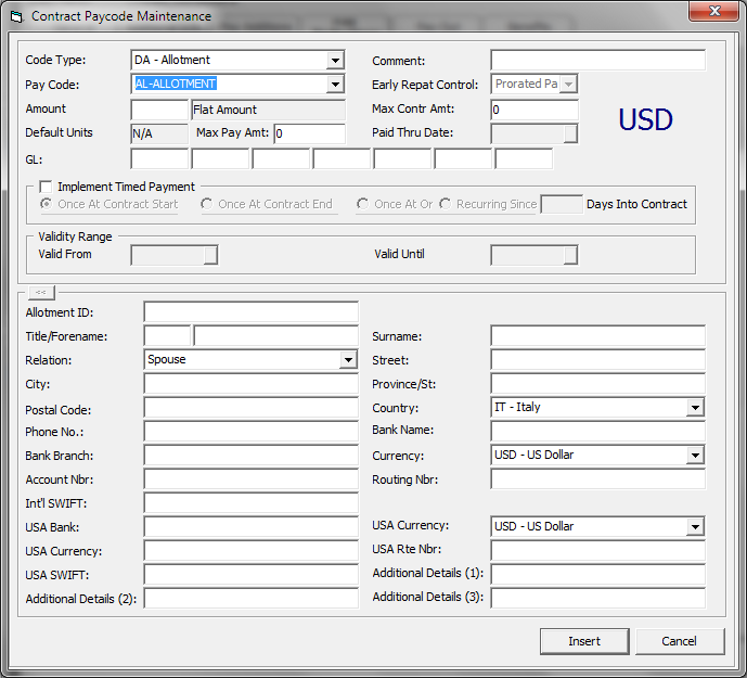

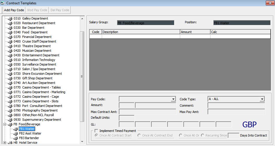

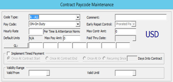

Contract Template
The Contract Template allows you to define a basic contract template for each Salary Position, by person or company specific. This can be used as initial contract pay codes when adding a contract.
Figure 1-3 Contract Templates Form
Adding Pay code to Contract Template
Select a Position on the Contract Template form.
Click Add Pay Code.
Navigate to the Template Pay code Maintenance form and fill in the details accordingly.
Click Insert to save.
Figure 1-4 Template Pay code Maintenance
Table 1-4 Template Pay code Maintenance Field Definition
Pay Code |
Pay code Selection |
Code Type |
Filter for the pay code by Code Type. |
Amount / Rate |
Amount of pay code. Note: Shows ‘Flat Amount’ when calculation method defined is amount calculation. Shows ‘Rate / Percentage’ when calculation method defined is percentage calculation. |
Comment |
Pay code comments in template. |
Max Contract Amount |
This field holds the total amount (in payroll currency units) that this pay code can accumulate to for the entire length of the contract. Once this amount is reached, no additional amounts are computed for this pay code. |
GL |
The shore side general ledger account which this pay code will be accounted for. Note: Will be auto populated if GL codes have been defined in Pay code setup. |
Implement Time Payment |
Pay code used for payable upon return. There are four (4) categories:
Note: This option only applies to Pay Additions and Pay Deductions. |
Creating Contract Template
Go to the Maintenance, Contract Templates menu. A list of all salary groups is displayed.
Expand the group by clicking the plus (+) key.
Click Add Pay Code.
On the Add Pay code form, enter the pay amount and necessary details.
Click Insert to insert a pay code into the template.
To modify a pay code of a template, select the pay code and click Mod Pay Code.
Update the details and then click Update to save the changes.
To remove a pay code from the template, select the pay code and click Delete Pay Code.
On the confirmation prompt, click OK to proceed.

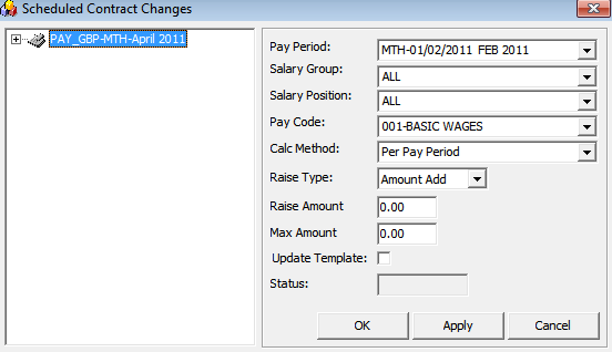

Schedule Contract Changes
Schedule Contract Changes is a scheduler that changes the pay code rates and amount for the following pay period, and can only set up a schedule for future pay periods. For instance, you would set up a schedule in March for a change to take effect in April. The changed pay rate is applied when a new pay period is activated and maintained by the company.
Figure 1-5 Schedule Contract Changes
Table 1-5 Schedule Contract Changes Field Definition
Pay Period |
Effective Pay Period for the raise. |
Salary Group |
Department to which the raise applies. |
Salary Position |
Position entitled to the raise. |
Pay Code |
Pay code for which the raise applies. |
Raise Type |
Defines the type of raise.
Raise Amount |
Value of raise |
Max Amount |
Maximum raise amount |
Update Template |
If the Update Template field is selected, the contract template updates with the raise upon opening the specified month. For example: Selected when the raise applies to the existing contract template(s) for the selected salary group, position and pay code. |
Status |
Status of schedule changes. Show ‘Closed’ when changes are being processed. |
On the Maintenance menu, select Schedule Contract Changes.
On the Schedule Contract Changes form, right-click and select Add.
Complete the setup form and click Apply to keep the form or click OK to save and close the form.
To remove the schedule, right-click the selected schedule and click Remove. You are not allowed to remove a processed schedule.

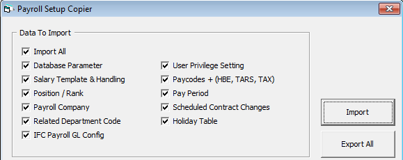

The Payroll Setup Copier is a tool that copies the entire payroll setup from one database to another, excluding these set ups:
Cost Center
Daily Currency Setup Detail
Operation Position (SPO_AID_ID will be null)
Unique record in Pay Raise table, or else the following message appears.
Figure 1-7 Payroll Setup Copier Unique Record Prompt
Tax name must be unique, or else the following message appears.
Figure 1-8 Payroll Setup Copier Unique Tax Name Prompt
When importing from a selected Payroll Company, all related loyalty bonuses and the vacation pay matrix are copied over, as well as inserting new records but will not delete the existing setup.
When importing a Salary Template & Handling and both the source ship and target ship have a loyalty bonus and vacation pay matrix set up, the existing setup of the target ship is deleted before the import continues.
If the target ship has a parent total linking or an operation position is unlinked on a source ship that has linking, the Import re-inserts the link.
Figure 1-9 Payroll Setup Copier Options
On the Maintenance menu, select Payroll Setup Copier.
The application disregards all checked items for the export function. Click Export All when ready.
On the Browse for Folder window, select the location to save the file, and then click OK.
When the export completes successfully, the system automatically saves the Extensible Markup Language (XML) file (PYRL_SETUP_v[version_number]) at the selected location and displays a confirmation box. Click OK to close the prompt.
To import the data, login to the Payroll module of the destination database.
On the Payroll Setup Copier window, select the respective check boxes for the data to be imported and click Import.
Select the file to import from the saved location.
Once the import process starts, a progress bar is shown.
At the end of the process, the system displays a confirmation prompt. Click OK to close the prompt.

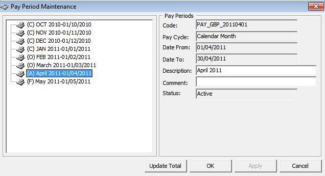

Pay Period Setup
The Pay Period is the defined time frame for every pay cycles. You are required to activate it to begin payroll transactions and closes it when the pay period is complete.
The pay periods are maintained by the Pay Company within the crew payroll system. The same period dates may have different statuses in different companies.
Setting up Pay Period
Figure 1-10 Pay Period Maintenance
Table 1-7 Pay Period Field Definition
Code |
Unique Pay Period code auto generated by the system. |
Pay Cycle |
Auto default to setting in Payroll Company, Pay Cycle. |
Date From |
Pay Period begin date. Dates are calculated automatically based on the end of the previous pay period within a company’s pay cycle. Note: You can only specify a Date-From on the first pay period added to a pay cycle, and the subsequent pay period date are auto computed by the system. |
Date To |
Pay Period end date. Dates are automatically calculated based on the previous pay period end date within a company’s pay cycle. |
Description |
Name of the pay period. |
Comment |
Additional information. |
Status |
Status of pay period - Open, Closed, Active. |
In the Payroll module, select Payroll, Pay Period from the menu.
On the Pay Period Maintenance form, right-click and select Add to adda new pay period.
Complete the pay period setup form.
Click Apply to save the record or OK to save and close the form.
To delete the pay period, right-click on the period and select Remove. You can only remove a pay period that does not have any transactions linked to it.

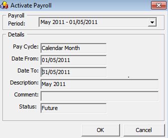

Activating a Pay Period
In a pay cycles, only one (1) pay period can be activated. Below are the statuses and steps to activate the pay period.
Closed (C): Pay Period is complete and adjustments are not allowed.
Open: (O): Pay Period is still open for manual adjustments and payouts.
Future (F): Pay Period is not yet open, although accruals may be recorded in the period due to a pay out in the previous period.
Active (A): Pay Period is open to all types of changes, including pay sheet updates, contract changes and manual adjustments.
Figure 1-11 Activate Payroll
In the Payroll module, select Payroll, Activate Pay Period from the menu. You can activate only the future pay period.
Click OK to proceed. The system generates the pay records for all people with active contracts and sets the new pay period as Active and the previous active period as Open.

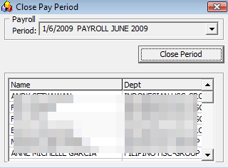

Closing a Pay Period
To ensure the accruals are correctly accounted for, you must close the Pay periods and make no further adjustments or changes thereafter.
Before a pay period can be closed, all contracts within that pay period must be paid out. Otherwise you are not allowed to proceed. If there are unpaid contracts, they are displayed in the grid of the form and you will receive a notification that the Period cannot be closed.
Figure 1-12 Close Pay Period
In the Payroll module, select Payroll, Close Pay Period.
Select the period from the drop-down list. Only the oldest period within each pay cycle is listed.
Click Close Period to close. You will receive a “Pay Period Closed” prompt once the period is successfully closed.
By default, the system does not allow you to close a pay period if the pay period end date is after the current system date (PC Date), even though all crew members have been paid. You will receive a notification “Early closing not allowed!” Pay Period end date is DDMMMYYYY when you try to close the period.
This can be changed by setting the parameter group Payroll, Allow Closing of Pay Period Prior to End of Period = 1. This setting overrides the above prompt and allows you to close a pay period even though the pay period end date is after the current PC date.
For example;
Current system date: 15-March-2021
Pay Period end date: 31-March-2021

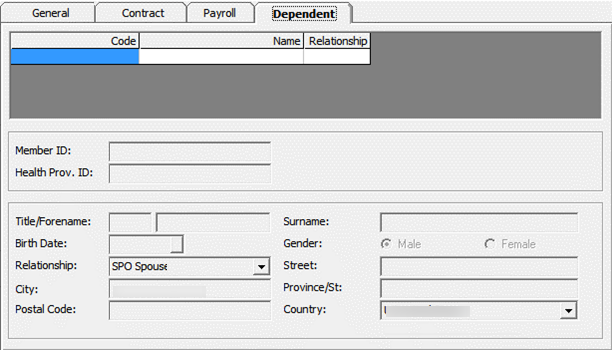

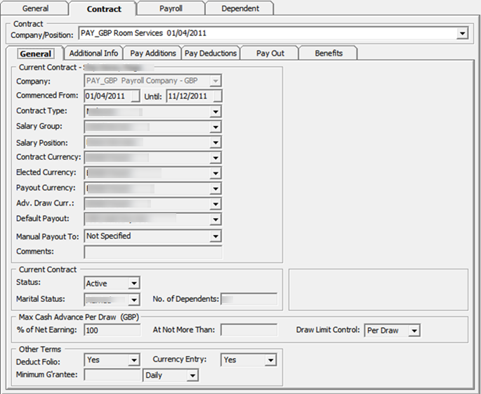

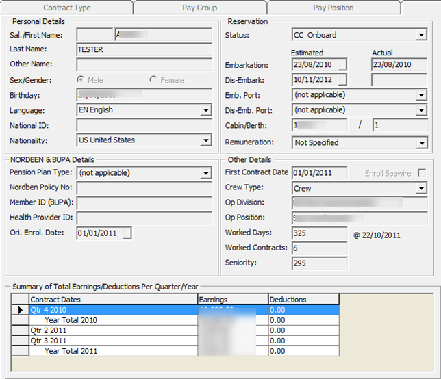

Crew Detail Maintenance
The Crew Detail Maintenance function is used to maintain the crew’s personal details and contract information. Any payroll activities affecting a single crew member can be performed from within the Crew Payroll Details form.
Figure 1-13 Classic Crew Payroll Details Information

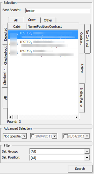

Crew Search
There are various ways to search for crew details in the Payroll module. You can use either of the following:
Look up the information by entering the crew ID, name or contract status using the Quick Search feature.
Enter a cabin number in the Fast Search field and press Enter to immediately begin the search or leave it idle for 10 seconds for an auto search
If the search results on the grid are greyed out, then the crew member listed is in another pay company instead of the one that is currently active.
Figure 1-14 Search Panel
Table 1-8 Search Panel Field Definition
| Field | Function |
Fast Search |
Search by entering the following value:
Note: For searches using the crew external ID or internal ID, refer to the parameter setting in “Payroll”,”Display UXP_C_EXTERNALID As Crew ID” |
Crew Group |
Search by crew group in:
Reservation Status |
Search by crew reservation status in:
Contract Status |
Search by crew with contracts status in:
Note: Enable the parameter “Ending Payroll Alert”, listing the crew of ending payroll on a pop-up window upon program start-up. |
Advanced Selection |
Search the crew embarkation date, debarkation date, or Not On Board status. Note: ‘Not On Board Status’ refers to NOB flag status of future reservations and previous reservations if the date falls under a future assignment date. |
Filter |
Search by salary group and salary position. |
Crew General Details
The General tab of the Crew Details gives you an overview of the selected crew member. It displays the basic crew information such as identification, date of birth, embarkation/debarkation date, and other information maintained in the Crew Management module. Information for non-crew personnel paid through this payroll is maintained within the Payroll program.
Figure 1-15 Crew Details
Table 1-9 Crew Details Field Definition
NORDBEN & BUPA Details |
Details used for Pension Plan and Medical Plan. |
Ori. Enrol. Date |
Field is required if ‘First Contract Date’ is entered. |
Remuneration |
Remuneration of the crew. Field is locked during edit by Contract Type, Salary Group , or Salary Position. |
First Contract Date |
Crew join date. This is an optional field controlled by the parameter Payroll, Optional Join Date. This field is also available in the Crew Management module, Edit Information, Other Info. Note: You can define the field name in the Administration module, Label Setup - CMJOIN. |
Enroll Seawire |
Flag indicating crew’s enrollment in Seawire function. |
Worked Day |
The crew contract start date until current system date (PC date). |
Worked Contract |
Total contract with the payroll company. |
Seniority |
The First Contract Date until current system date (SPMS date). |

Crew Dependent Details
The Dependent tab stores the crew dependent information. This information is mainly used for crew entitled to a Pension or Medical Plan.
Figure 1-16 Crew Dependent Tab
Adding/Editing/Removing Dependent Information
On the Crew Edit Detail form, select the Dependent tab. This enables a selection menu comprised of New Dependent, Edit Dependent, and Remove Dependent.
Click the New Dependent and complete the necessary information.
Click Insert to save the record.
To edit the information, click Edit Dependent, update the information and click Update to save.
To remove the information, select Remove Dependent and then click Delete.

Creating a Contract
The General tab stores all information related to the contract such as start/end date, pay out currency, salary group and position, maximum cash advance amount and others.
Figure 1-17 Contract Form
Table 1-10 Contract Details Field Definition
Company |
The payroll company for this contract. Note: You cannot update this since it comes from an active payroll company. |
Commenced From and Until |
The beginning and ending dates of the contract. Note: You must specify a Commenced From date. If the Until date is left blank, then the contract will remain active until a final date is entered or a new contract for the same person is created. |
Contract Type |
Type of contract group. |
Salary Group |
The department the salary is classified under. |
Salary Position |
Crew Work Position |
Contract Currency |
Currency of the contract. |
Elected Currency |
Currency used in allotment. |
Payout Currency |
Currency used for final payout. Note: Currencies must be defined in the SPMS with an active conversion rate. The currency rate and the overall Payroll currency rate must be maintained using Currency Exchange Maintenance. |
Adv. Draw Currency |
Currency used for cash advance. |
Default Payout |
Default pay code during payout. |
Manual Payout |
Default pay code when payout negative balance. |
Comment |
General comments about this contract and person. |
Status |
Status of the contract; Close, Active, Inactive. |
Marital Status |
Marital status of the crew. |
No. Of Dependent |
No of dependent. Use for tax calculation. |

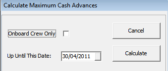

Max Cash Advance |
Available balance of the current period as the suggested amount when a Cash Advance is entered.
Per Day: Only allow to withdraw ONCE per day, where day change is based on database server date. Per Draw: Allow to draw up to available balance. Per Pay Period: Only allowed to withdraw ONCE per pay period. Not Specified: Default value is "Per Draw". Note: Allows withdrawal up to Bal-To-Date amount is set up in Companies Setup, Draw Up To Bal-To-Date. |
Deduct Folio |
Note: You must enable parameter Payroll, Folio Posting |
Currency Entry |
Flag allows currency selection when performing a posting adjustment in Add New Pay Item, Cash Advance, Quick Posting. |
Minimum Guarantee |
The minimum guaranteed that must be paid to the crew on each month or year or day. |
Adding New Contract
Navigate to Crew Edit Detail form and select Contract tab. This open a new menu with options New Contract, Edit Contract and Remove Contract.
On the Search function, select the No Contract tab to list all the non-contracted crew.
Select the crew member and navigate to Contract tab.
Click New Contract.
On the Add Contract form, complete the contract details form and then click Apply.
Figure 1-18 Contract Reference

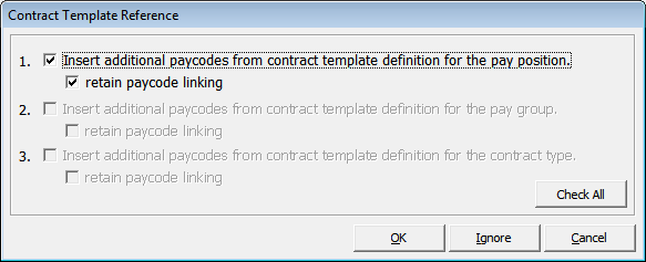

The system prompts the Contract Template Reference form if the selected Salary Position is setup with a Contract Template.
Select the option and click OK to copy the pay code into new contract or Ignore to skip the copy.
Continue adding the additional pay code in Pay Addition, Pay Deduction, Payout or Benefit tab.

Adding a Pay Code
Figure 1-19 Crew Payroll Details
On the Crew menu, select the Edit Detail menu option.
Select the crew member from the crew list and then navigate to the Contract tab.
Click Edit Contract. This opens the Change Contract form.
Select the correct tab to add the different code type to the pay code. See Contract Details Maintenance for tab information. The menu bar at the top of the form changes depending on the tab you select.
Click Add Pay code. This opens the Contract Pay code Maintenance form and only the code type for the selected tab will populate.
Figure 1-20 Contract Pay Code Maintenance
In the Pay Code field, select the applicable code from the drop-down list. The calculation method of the pay code appears in the field beside the Amount.
Figure 1-21 Template Pay Code Maintenance
Enter the rate or amount.
The amount field can hold an amount per period, per day, per hour, a flat amount or a percent amount depending upon the selected pay code. -
Complete the information on the form, click Insert and return to the Change Contract form and then click OK.
On the Contract Template Reference prompt, click Ignore if the pay code from Contract Template is already copied onto the contract or skip to copy the pay code. Click OK to recopy if there are additional pay codes created in the Contract Template.
At the ‘Do you want to update the active pay with these changes?’ prompt, click Yes to recalculate the pay for the current period based on the changes.

Figure 1-23 Contract Pay Code Maintenance
The definition of the additional fields in a pay code form when adding the pay code are as follows:
Fully Entitled: An option used to calculate the Vacation Pay with Early Repatriation.
Paid Thru Date: Used to display in the Payroll GL file when Vacation Pay is assigned.
See chapter Contract Template, Adding Pay code to Contract Template for the basic field definition.
To edit the Contract Pay Code,
Select the pay code and click Mod Pay Code to open the Contract Pay code Maintenance form. Change the pay code detail and click Apply to save the changes.
The Code Type and Pay Code cannot be edited. -
Click OK to save and exit the form.
In the Contract Template Reference, click Ignore if the pay code from Contract Template is already copied into the contract or skip to copy pay code. Clicking OK will recopy the pay code if there are additional pay codes created in the Contract Template.
You will be prompted with Do you want to update the active pay with these changes?.
Click Yes to recalculate the pay for the current period based on the changed contract. Click No, to save without changing the current pay until the next pay period.

Creating Multiple Contract
A crew member can have more than one contract for different positions held. The Crew Officer can create an individual contract or a linked contract for the crew member.
Individual Contract: A contract created for the same crew member. This crew member could have more than one contract. The contract criteria can be different or from a different payroll company.
Linked Contract: A contract of the crew member, within the same company, can be linked to another contract, so that the accrued balances from the first contract are automatically moved to the pay items list of the new contract. You can use this feature to perform mid-period promotions and demotions of crew members while retaining the paid out and accrued balances.
When creating multiple contracts, the new contract start date must not overlap the previous contract end date. If there is an overlap, the system displays a notification requesting you to correct the dates.
The steps to create multiple contracts are the similar to Creating a Contract, when the selected crew has an existing contract.
When creating a new contract for a crew member that has a previous contract tied to the same company and its end date is one (1) day less than the start date of the new contract, a Link Previous Contract check box will appear on the Change/Add contract form.
Both of the linked contracts must have the following criteria.
Must be within the same company.
Same Contract Currency.
Second contract must include pay codes for any accrued pay codes that are in the first contract.
Once the linked contract is created, the crew member name will appear twice in the crew listing with a different contract. When you clicked on the crew member’s second contract it will display the previous contract information in the General tab under Contract Detail.
Figure 1-24 General Tab - Multiple Contract

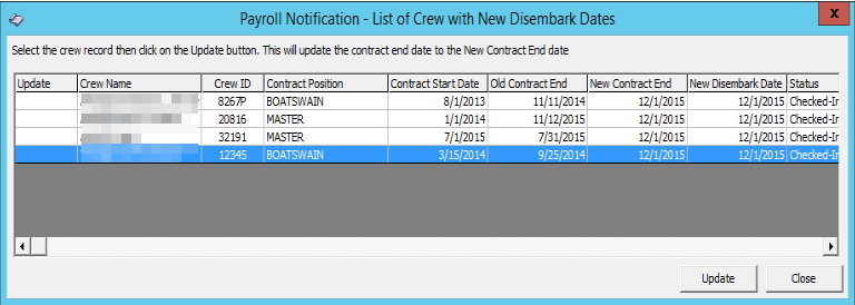

Updating Contract End Date
The system lists any crew member that has a debarkation date change in Crew Management under ‘Payroll Notification – List of Crew with New Disembark Dates’, as shown in the diagram below when you first launch the application.
Figure 1-25 Crew with New Debarkation Dates
If a crew member is being paid for days beyond the contract end date, the change cannot be applied. You will receive a message prompt This person has already been paid out in the active pay period. Contract changes cannot be performed.
To update the contract end date:
Select the crew member from the listing and then click the Update button.
On the confirmation prompt, click Yes to update.
You can reopen this list from the Payroll, Update Contract End Date option if the screen closes.

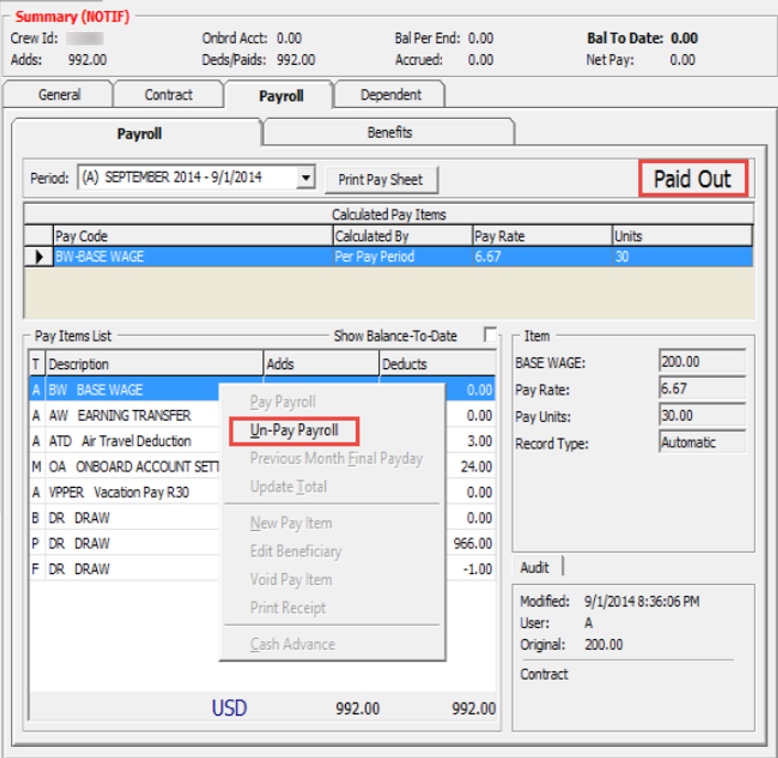

Payroll Details

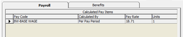

The Payroll tab consists of two tabs.
Payroll: This tab includes a pay period selection and displays the pay sheet, all pay items, and a frame for additional information for each pay item.
Benefits: This tab includes the benefit contribution items and information about each item.
The majority of the payroll activity is performed from the Payroll tab of the Crew Payroll Details.
Pay Items List
In the Payroll tab of the selected crew member, the pay items are listed under the Pay Items List section.
Each of the items in the grid are tied to a record type, described in table below. Details of the item, such as Pay Rate, Units, and Modified Date appear in the Item/Audit section when you click on the item. If the payroll is in an active period, a summary of the payroll information is shown in the Edit Details form.
Checking the Show Balance-To-Date option switches the view to show the balance to-date amount of each pay item.
Figure 1-26 Pay Items List
Table 1-11 Pay Items Record Type
| Record Type | Description |
A |
Automatic. Added automatically when assigning or editing pay code from contract template. |
M |
Manual. Added when the posting is an adjustment such as Add New Pay Item or Cash Advance. |
P |
Paid out. |
R |
Accrued from last period. |
F |
Accrued to next period. |
B |
Pay accrued from last period. |
S |
Semi Auto. Pay code adjustment with calculation method defined as percentage. |
T |
Previous month paid out. |

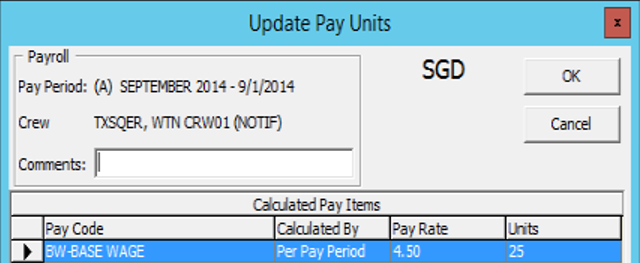

Update Pay Units
The Pay Sheets contain detailed information, such as unit information, and the pay rate, and is used to determine the pay amount for each pay code in a contract by multiplying the units. You can change the pay units.
You are only allowed to update the pay units for pay codes that have ‘Adjust Unit Setup’ enabled in Pay code Maintenance.
Updating Pay Units for a single crew contract.
From the selected crew, navigate to the Payroll tab.
Click the Update Pay Units button on the Crew Payroll Details form or right-click on the pay code.
On the Update Pay Units form, select a Pay Code and double-click the Units field.
Adjust the value using the inline edit.
Add a comment and then click OK to save.
Figure 1-27 Update Pay Units
Instead of clicking the Update Pay Units button, you can also update the pay units under the Payroll tab by right-clicking the pay code in the Calculate Pay Items’ section.
Figure 1-28 Calculate Pay Items

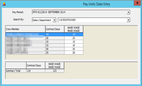

Updating Pay Units for Multiple Contracts
Apart from updating the pay units for a single crew contract, you can also update pay units for Multiple Contracts using the following steps.
Figure 1-29 Pay Units Data Entry
On the Payroll menu, select Update Pay Units from the menu option.
On the Pay Units Data Entry form, select the Pay Period and method and from the Search By fields.
Double-click the Base Wage field to enable inline editing. Edit the value and then click Apply to save or click Undo to revert the changes. The records will be updated and pay is recalculated.

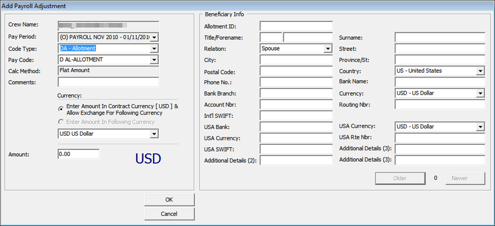

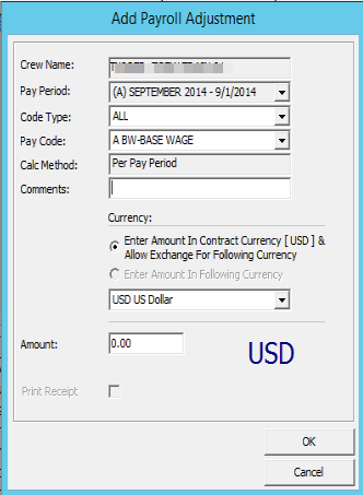

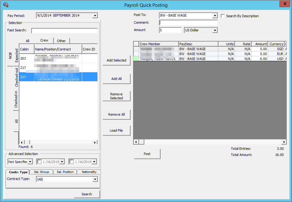

Posting Adjustment
The Posting Adjustments allow you to perform a payroll adjustment or adding an ad-hoc posting to the crew contract.
You can only add or adjust a payroll posting that is not paid in this pay period. Payroll adjustments will only populate for those pay codes that are set up with Adjustments in Pay Code Maintenance.
Figure 1-30 Payroll Adjustment Form
Adding Posting to Single Crew Contracts
On the Payroll tab of the selected crew account, click the New Pay Item button. You can also right-click on the item in the Pay Item List section.
On the Add Payroll Adjustment form, select the Code Type from the drop-down list. The calculation of the selected code type will be shown in the Calc Method field.
Enter the comments in the Comments field.
Check the respective Currency option and enter the amount.
There must be a currency exchange rate set up in the Administration module if you select the first option.
The values entered are either in units or amount, depending on the calculation method of the pay code. For example, the pay code for Per Hour or Pay Day calculation is by units.

Adding Postings to Multiple Contracts
From the Payroll menu, select the Quick Posting option.
Select a Pay Period to list the active payroll.
Select a pay code from the Post To drop-down list. Check the Search by Description, to search using the pay code description.
Enter a comment in the Comment field.
Enter an amount or rate in the Amount field.
Individually select the crew account to post to and then click the Add Selected, or use the Add All button to add all listed accounts to the grid.
To remove an account, use the Remove Selected or Remove All button.
Figure 1-31 Payroll Quick Posting
At this point, you can still change the amount to post in the Amount field within the grid.
Click the Post button to continue.

Adjusting an Allotment
The Crew Officer can adjust an allotment of the crew member and, at the same time specify the beneficiary of the adjustment, provided the pay code, Specify To is enabled in Pay Code Maintenance. An adjustment can be posted only to record type M.
Figure 1-32 Payroll Adjustment
On the Payroll tab of the selected crew account, click the Void Pay Item button. You can also right-click on the item in the Pay Item List section.
If Specify To is enabled, update the beneficiary information.
Click the OK button to remove the item from the Pay Items List and recalculate the payroll.

Figure 1-33 Payroll Company Maintenance
When onboard expenses are settled through Pay Invoice in the Crew module, the amount is transferred into the payroll as a pay deduction, allowing onboard expenses to be deducted.
In order for this to work, you need to define the following settings:
The allow Invoice Payment Receiving option is selected on the Payroll Company setup.
The Payment department in the Crew module is the same as Onboard Account Department in Payroll Companies.

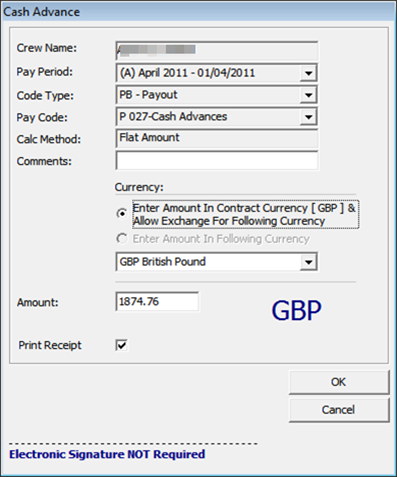

Cash Advance Posting
The Cash Advance feature handles the early pay out made against the anticipated balance for the month. A cash advance pay code is required in the Payroll Company under Cash Advance Pay Code per the following criteria:
Apply Order: Greater than other pay items pay code.
Calculation Method: P-FLAT - Flat Amount
Adjustment option: Checked as payroll adjustment.
Figure 1-35 Cash Advance Posting
On the Payroll tab of the selected crew account, click the Cash Advance button. You can also right-click on the item in the Pay Item List section.
Enter the comment in the Comment field.
At the Currency field, select the Currency option and the currency.
Enter the amount to advance in the Amount field.
Check the Print Receipt if a receipt is required. You can set this as the default in the parameter Default Receipt Printing During Cash Advance.
Click OK to post the cash advance.
To void the cash advance, use the Void Pay Items or right-click on the posting.
The cash advance amount is controlled by these two (2) settings:
Draw Up to Bal-To-Date in Payroll Companies Maintenance is checked.
When this field is checked, the maximum cash advance amount allowed is per value in Bal to Date of the Crew Details summary screen.
Max Cash Advance in Crew Contract.
If the Max Cash Advance is set up, the system always calculates the value based on the % of Net Earning, followed by the value in At Not More Than field. If the % of Net Earning has no value, then the value of the calculated percentage applies.
Below is an example of the calculation.

The Calculate Advance in the Payroll menu is a function that prepares a report, listing the available cash advances by crew member, using a special form to perform these calculations and placing the results in the Contract record for each crew member.
The options are:
Onboard Crew Only is an option for companies that use 12 month contracts, and they only include crew currently onboard in the report.
Up Until This Date calculates the available cash advance amounts up to the date specified. This process must be performed for each company.
Figure 1-36 Calculate Maximum Cash Advances
When you click the Calculate button, you generate and store the available cash amount in the database and in a report. In the following example, you have the CTR_MAX_ADVANCE_CALC which calculates based on the Per Pay Period Pay code. The formula used is (base wage) / 30 (total days of current month) x 20 days.
Update Total
The Update Total button updates all crew contracts that have calculation changes, such as a pay rate change or a currency rate change. Also, it can recreate the pay sheet if it is missing. This happens when a new pay period is activated but somehow the crew payroll only shows until the previous pay period. There are a few areas to process the Update Total.
Update Total at Pay Period setup.
Update Total upon system date change using the parameter Update BTD Total Upon System Date Change set as enabled.
Update Total when generating the Payroll GL file when ‘Update Total Prior’ is configured as enabled.
The Update total is only available when there is unpaid payroll in the Open/Active pay period.
Access the Pay Period Maintenance form from the Payroll menu, Pay Periods.
Select the pay period with Open or Active status and then click Update Total.
The system prompts a notification for the number of unpaid payrolls to update. Click Yes to proceed or No to return to the previous screen.
Once the update progress total is done, an error log screen prompts if a crew pay is missing or requires a setting.

Figure 1-37 Payout Process
Figure 1-38 Payout Form

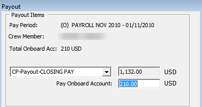

Paying out to Individual Crew
Select the crew member from the Crew Edit Details screen and navigate to the Payroll tab.
Select the pay period and click Pay Payroll.
On the Payout form, use the default payout pay code or select another from the drop-down list.
Change the folio amount if necessary.
The folio payments made at payout are based on the Deduct Folio setting in the crew contract setup, payroll companies’ setup, and the parameter setup. If the folio amount is changed, the net payout recalculates. -
Check the Roll Over option only if you need to accrue payout to next pay period.
The Roll Over option is enabled when the payout pay code is set to Accrued and the contract has not ended. This moves the pay period to next and no additional transactions can be made against the crew member account within that period. -
Check the Print Pay Sheet option if required. If printing is required for all, you may default the check box by enabling the parameter Default Pay Sheet Printing During Payout.
Check the Print Invoice option if required.
Click OK to proceed with payout.

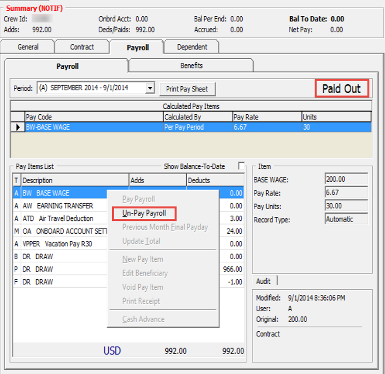

Reversing a Pay Out
A Pay Out can only be reversed for the following cases:
Pay Period status is Open/Active.
No Pay Out after the transaction you wish to reverse is reversed.
Figure 1-40 Un-Pay Payroll Option
Navigate to the Payroll tab of the selected crew member.
Right-click the Paid Out caption of the Payroll tab or on the Pay Items List select Un-Pay Payroll from the option list.
At the confirmation prompt, click Yes to proceed. This only reverses the pay out and all accrued amounts and does not reverse the folio payment.
In order to pay the rounded-up payout amount, enable the following settings in the Payroll Companies setup screen:
Round Payout
Round Final Pay code
This will accrue the remaining pennies to the next pay period and will pay them on the final pay using a separate pay code defined in the Round Final Pay code. The following table is an example of the rounded payout.

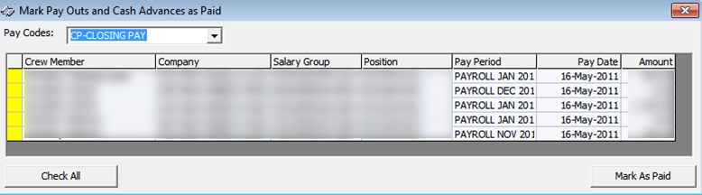

Mark Paid
Reports are produced to aid the calculation of the payroll cash request. The report is generated based on any payments pending in the system. The Payments pending consists of any form of pay outs performed using the multiple crew member payout form or cash advances that were entered in the Quick Posting form. The pay outs and cash advances entered using the Crew Details forms are assumed to have been paid immediately, without the use of a cash request.
This is to ensure that the cash request includes the correct payments.
Figure 1-41 Mark Pay Outs and Cash Advance as Paid
After performing the cash advance in Quick Posting or when multiple crew member payouts are processed, select Mark Paid on the Payroll menu.
Select the corresponding pay code from the drop-down menu to list all of the pending payments.
Double-click on each crew member’s account to mark the payment as paid or click the Check All button to mark all payments, then click Mark As Paid to update. This places an ‘X’ in the transaction.
