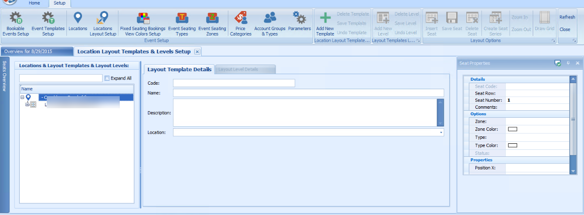

Locations Layout Setup
Layout Template Details
Layout Level Details
At the Setup tab, click Locations Layout Setup.
Click Add New Template to create a new template.
Enter all the information and click Save Template and then Close.
Figure 1-1 Layout Level Details
Select a layout template that you created earlier.
Click the Add New Level button.
Enter the Layout Level Details consisting of Level Code, Level Name, Hybrid, Open Seating Capacity, Layout Image File, and Layout View.
Click Save Level to save.
Creating Layout Template
Figure 1-2 Layout Template
You can add a template, delete, save or undo the previous change made on the template. After creating the location template, add a new level for the template or define the seating zones by location.
One location can have multiple templates.
One template can have multiple layouts.

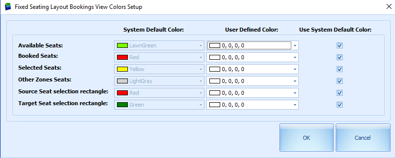

Fixed Seating Bookings Color
Creating a Series of Seats
You can create a series of seats starting with a seat number, number of seats, and orientation with this option.
To create, clicking the Create Seat Series button, enter all the relevant information, and click Apply.
Figure 1-3 Fixed Seating Booking Color
Click the Setup tab.
Click the Fixed Seating Bookings View Colors Setup button.
By default, the User System Default Color check box is selected. To define a color of your choice, deselect the check box and select the color from the drop-down list under User Defined Color.

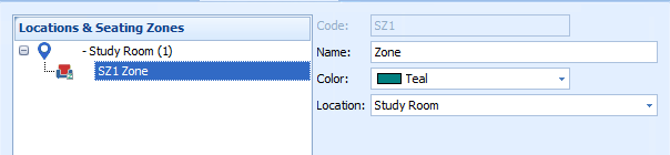

Event Seating Zones
Figure 1-4 Event Seating Zones
This function allows you to define the zone for use in seating plan setup.
At the Setup tab, select Event Seating Zones.
Click Add New to add a new zone.
At the Seating Zones form, enter the code, name and select a color and location from the drop-down list.
Click Save.

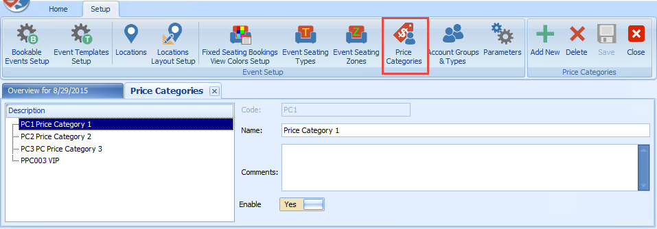

Price Categories
Use Price Categories to categorize the event by price, sales type, seating zones, and others.
Figure 1-5 Price Categories
Click Price Categories.
Click Add New to add a new pricing for the required category.
Enter a Code, Name, and Comment in the respective fields.
Click Save.
To delete a specific pricing category, move the mouse pointer over the required description, and click Delete.
Click Close to close this window.
If the Enable option is deselected, this will also disable the pricing categories from the Edit Template-Pricing Categories configuration tab.Event Templates Setup

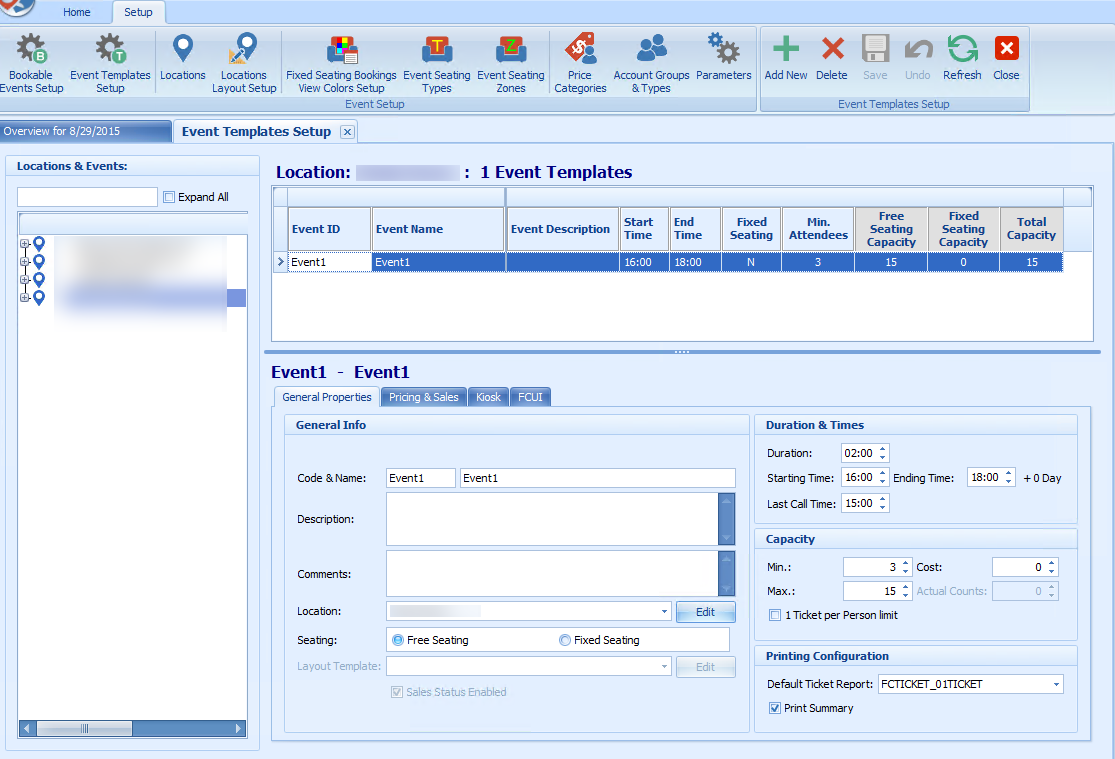

You can set up a template as a base for Bookable Events Setup.
Figure 1-6 Event Templates Setup Details
Locations & Events: Displays the location name and type of events within the location.
Location Details for the Event ID: Displays the number of events templates created for the location with information such as Event ID, Event Name, Event Description, Start/End Time, Seating Type, Min/Max Attendees, Seating plan, Layout Template, and so on.
Event ID and Event Name Details: This section has four tabs: General Properties, Pricing & Sales, Kiosk, and FCUI, and Details of each tab are listed below.
- General Properties Tab
General Info section: Code & Name, Description, Comments, Location, and Seating.
Duration & Times section: Duration, Starting Time, Ending Time, and Last Call Time.
Capacity section: Min, Max, and Cost.
Printing Configuration: Default Ticket Report.

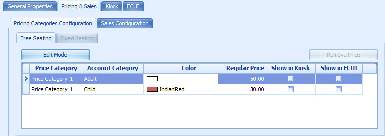

- Pricing & Sales Tab
Figure 1-7 Bookable Event Setup — Pricing and Sales
Pricing Categories Configuration: Free Seating – Price Category, Account Category, Color, Regular Price, Show in Kiosk, Show in FCUI.
Sales Configuration: Sales Posting, Voiding Departments, Sales Tax and Cancellation Fee.
Use the Remove Price to remove the price category or the Edit Mode to add the required price category.

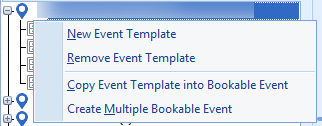

Select Event Templates Setup.
Right-click the navigation tree and select New Event Template.
Enter all the required information in each of the tabs.
If are using a Fixed Seating plan, you can attach a Layout Template to the event. See Creating Layout Template
Removing an Event Template
At the navigation tree, right-click and select Remove Event Template.
At the system prompts “Are you sure you want to remove the selected Event Template?”, click OK to continue.
Copying an Event Template into Bookable Event
At the navigation tree, right-click the event you wish to copy.
Select Copy Event Template into Bookable Event.

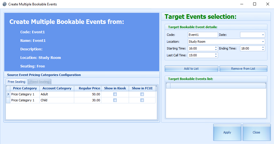

Creating Multiple Bookable Events
Figure 1-9 Create Multiple Bookable Events Form
The bookable event appears in the Code field.
In the drop-down list, select for Date, Location, Starting Time, Ending Time, and Last Call Time.
Click Add to List. Use Remove from List to remove unwanted events.
Click Apply to create.

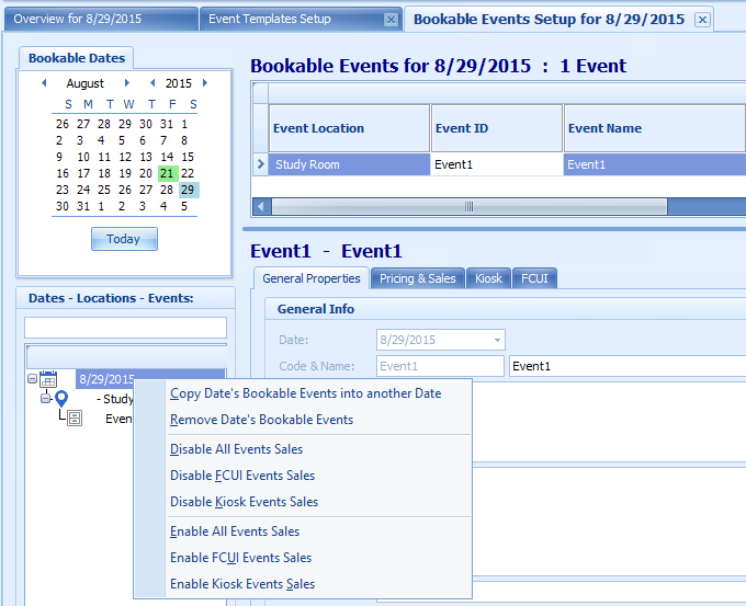

The ticket booking for an event can be set up by date, location, and event level.
Ticketing By Date
Figure 1-10 Ticketing by Date Level
Copy Date’s Bookable Events into another Date.
Remove Date’s Bookable Events.
Disable All Events Sales.
Disable FCUI Events Sales.
Disable Kiosk Events Sales.
Enable All Events Sales.
Enable FCUI Events Sales.
Enable Kiosk Events Sales.
Right-click on the event date.
Select the option from the menu.
At the confirmation prompt, read the message prompt before clicking OK to proceed or Cancel to terminate.
Copy Date’s Bookable Events into Another Date
When copying a bookable event into another date, you will receive a prompt to confirm to whether to copy the entire series of the event or not. From the drop-down list, select the date to copy and click OK to confirm.

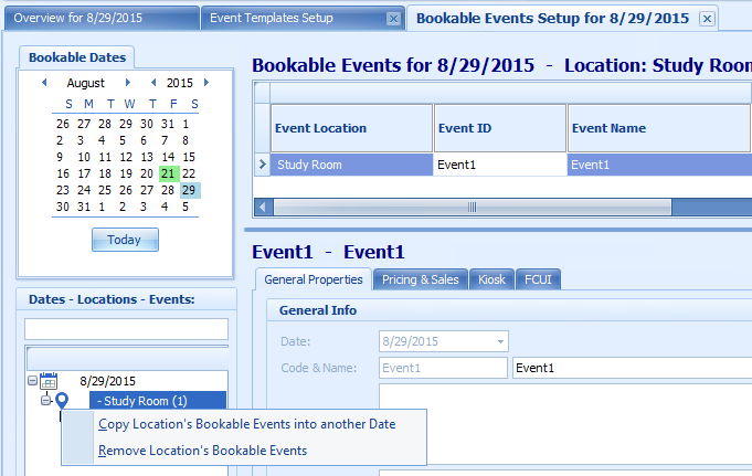

Ticketing By Location
Figure 1-11 Ticketing by Location Level
Copy Location’s Bookable Events into another Date.
Remove Location’s Bookable Events.
At the navigation panel, expand the date and right-click the event location.
Select the desired option. If you are copying the location to another date, select the new date when prompt.
At the confirmation prompt, click OK to proceed.
