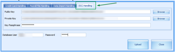

Run OHC Tools and select Upload PGP Key to upload PGP key pair for DCC handling.
At the PGP Key Uploaded screen, navigate to the DCC handling tab.
Browse for the bank public key (file format is .pkr) under Public Key column.
Browse for the secret key (file format is .skr) under Private Key column.
Enter a Key Passphrase if the key pair is generated with a passphrase.
Enter Ship’s database username and password.
Figure 6-2 PGP Key Uploader — DCC Handling Tab
Click the Upload button to begin the key upload for DCC Handling.
Upon successful upload, a ‘Key upload is done successfully’ message box appears. Click OK to close and exit.

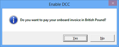

For DCC handling, the following message box will prompt when the ‘Card Reader Type’ is assigned to a magnetic swipe device and the credit card is eligible for DCC enrollment.
Figure 6-3 DCC Enable Screen — Manual Card Swipe
Click Yes to enroll the DCC handling or No to register the credit card without DCC handling.

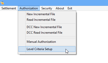

OHC Credit Card Transfer
DCC New Incremental File: For credit card enrolled with DCC Handling.
New Incremental File: For normal credit card registration that is not enrolled with DCC Handling.
Figure 6-4 OHC Credit Card Transfer — Authorization Menu

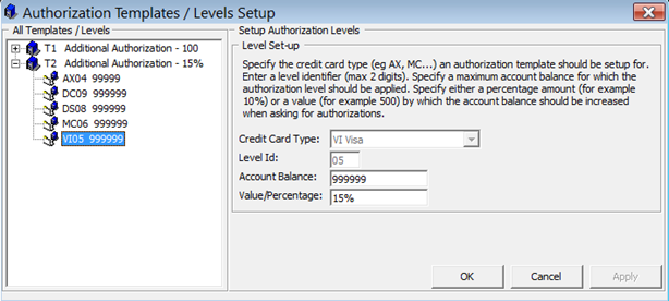

The initial authorization amount refers to Minimum Authorization in Credit Card Financial Setup. -

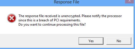

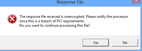

If the response file is not encrypted, an alert message box appears. Select the appropriate response.
Figure 6-8 Non-encrypted Response File

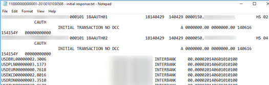

You will receive a batch with currency exchange rate provided by the merchant. See the figure below for sample.
Figure 6-9 Sample Response File with Currency Exchange Rate

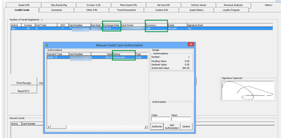

After the authorization completes, the authorization status column in Guest Handling, Credit Card tab, View Authorization is updated to Authorized, with the exchange rate provided in the response file. The exchange rate is also stored in the DCC table.
Figure 6-11 OHC Management — Credit Card Tab

At the DCC Credit Card Authorization Write screen, a converted (Onboard Authorization * Currency Exchange Rate) pending authorization transaction is listed. Click the Process button to write the authorization transactions into the file.
Figure 6-12 DCC Credit Card Authorization Write
In the Guest Handling, Credit Card, View Authorization screen, the status of the unconverted incremental authorization amount is listed as Outstanding status.
To change the status to Authorize, see Reading an Authorization.
Figure 6-13 View Authorization with Incremental Authorization — Pending Approval
Generating Incremental File with Authorization Template
An Authorization Template is used to obtain additional authorization amounts. The template only applies to Incremental Authorization. Use the following steps to set up the Authorization Template.
At the Authorization menu, select Level Criteria Setup from the drop-down list.
Figure 6-14 OHC Credit Card Transfer — Authorization
Configure the Authorization template in value amount. For example, see below figures for Sample Level Criteria Setup in Value.
Define the credit card type (VI Visa).
Define the Level ID (02)
Define the Account Balance (999999)
Define the Value/Percentage (100)
Figure 6-15 Sample Level Criteria Setup in Value
Configure the Authorization template in percentage. For example, see Figure 6–23 — Sample Level Criteria Setup in Percentage.
Define the Level ID ( 05)
Define the Value/Percentage (15%)
Figure 6-16 Sample Level Criteria Setup in Percentage
